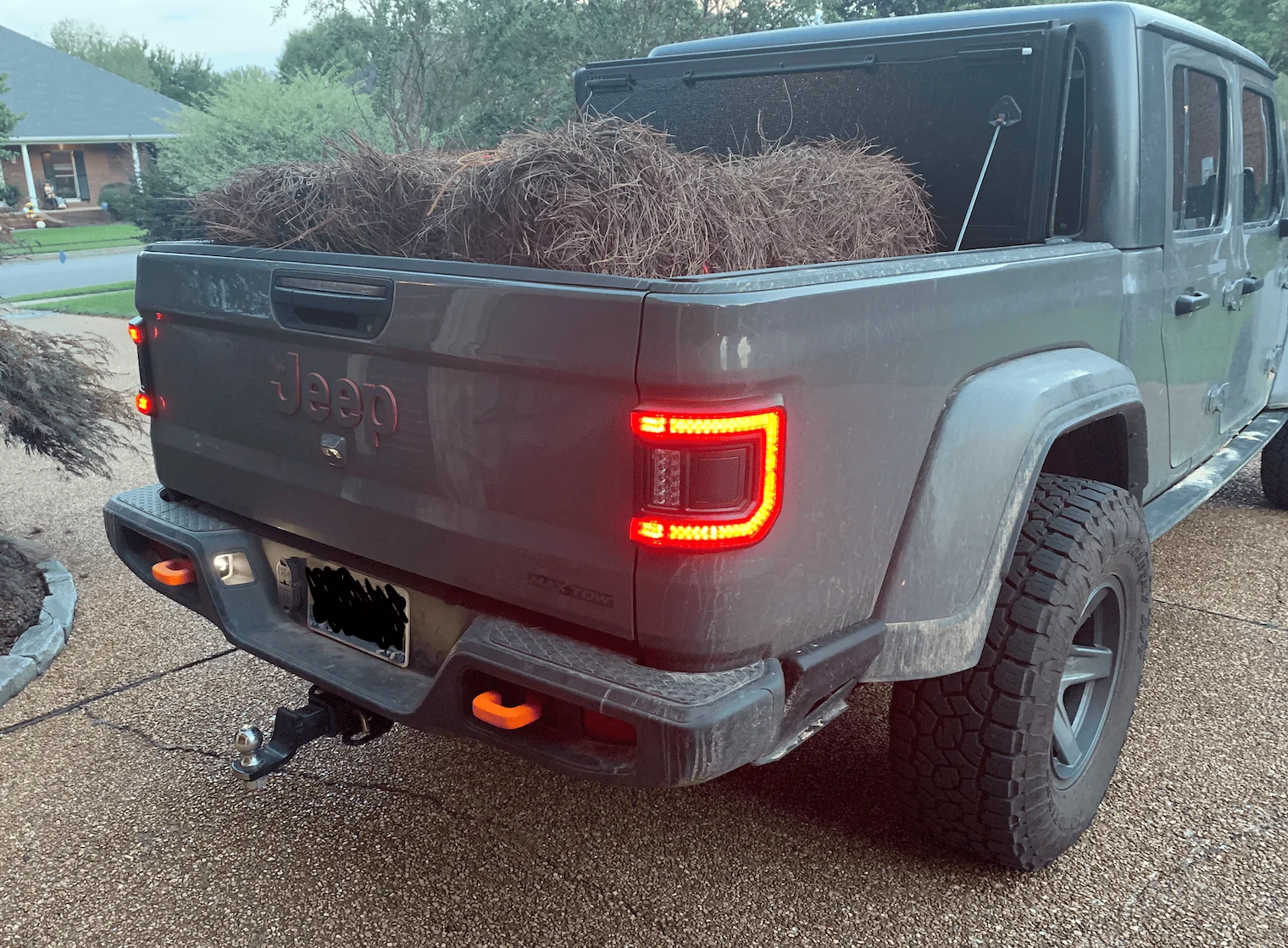

I gotta admit, these lights are better than I thought they would be. I had no issue with the plug and play. Coming from halogens, everything seems to work as intended. It has been a cool experience to see this through from idea, to designs, to prototyping and testing, and production. Thanks @ORACLElights

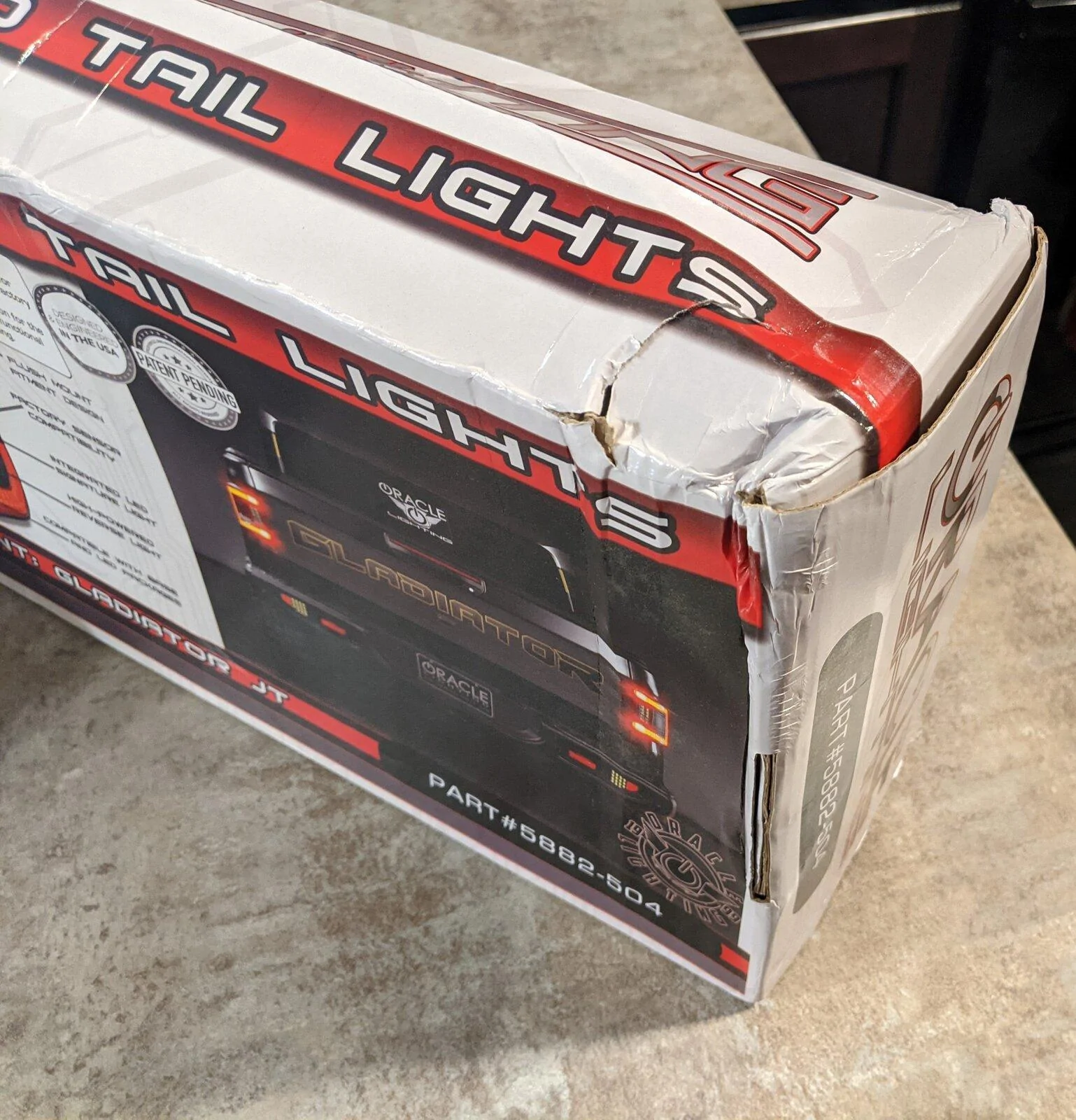

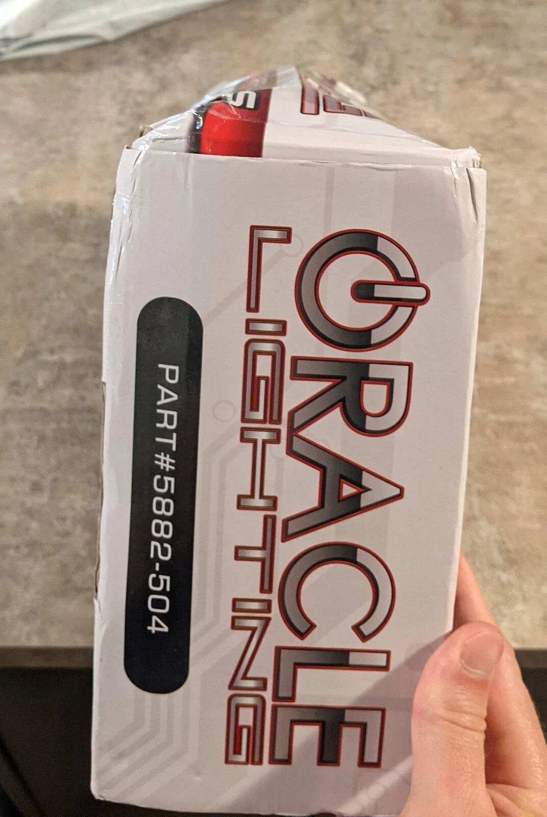

Well... mine arrived (a day late which is typical for USPS these days), and in less than stellar condition. @Oracle Designs, shipping them in a secondary box vs a plastic bag may be prudent. Luckily mine don't seem to be damaged inside the box, I can't imagine how long I'd have to wait to get replacements if I find out they are once I install.
Mine are a day late already and probably won't be here until Monday now. They were scanned 5 times in Detroit so I'm worried that they will be damaged.
