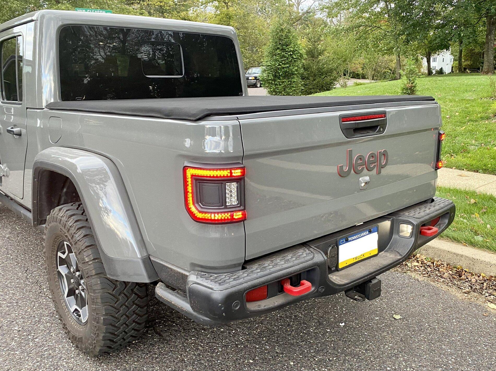

Installed in about 30mins, followed their vid.
Disconnecting oem plugs are difficult. broke the red lock on one of them.
Unscrew/free the bsm cradle from oem light before trying to disconnect the bsm plug.
No chance the harness can be reclipped to the inner wall, assuming that doesnt matter.
Plug & play, Everything works as it should, no warnings. Edit. After a week without Im now getting the dash warning light that the rear lights are out. Im returning these light
Reverse light is blinding!
Fitment is meh, the bed side does not follow the contour of the truck, the trunk side fits fine.
The trunk side of the unit could have been molded to more of a smooth finish, looks undone.
Not sure if bsm works, need to take her outside the neighborhood lap. Will edit this when I know.
Overall I like em and they are staying on.
Edit. Well after a week without, I’m now getting the dash warning light that the rear lights are out. Im returning these as Im not buying a programmer to remove the warning light.
