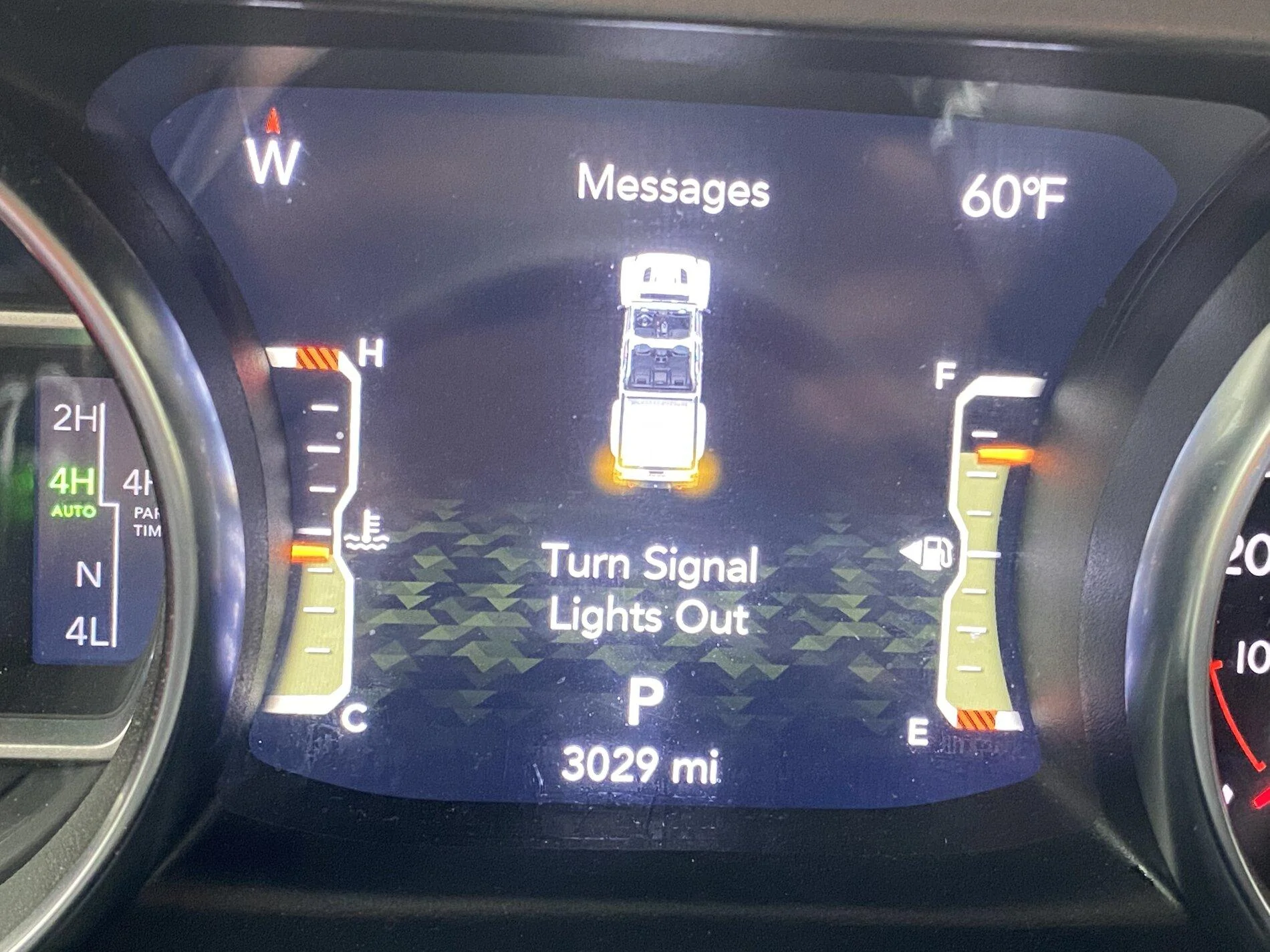

Still waiting on an assist to get my backup lights to work without a programmer... is this something you guys are working on? If not, please DM me for a return.
See below from my post a little earlier in the thread. I highlighted the workaround for the reverse lights if you don't want to use a programmer in red:
  • Using with ORACLE Bumper Reverse Lights (PN# 5878-504) - If P&P harness is in use & reverse light flickering / shutting down occurs you can do one of two things:
    • Use programmer such as Tazer or JSCAN to set aftermarket tails - This essentially tells the ECU to stop checking for the OEM load values at the tails (Reverse Lights included)
    • Remove the P&P Harness & tap each bumper reverse light into it's respective side tail to evenly distribute the load between the two, rather than combining the load at one tail

To be clear, this would require us to also purchase the JT bumper reverse light kit to use this fix? I currently do not have the bumper lights, I only have the tail lights and am having backup light flickering issues.
JP_Oracle
Peak Sponsor (Level 2)
JP
Jun 29, 2021
236
217
ORACLE Lighting
21 JTR
Sorry for the confusion here, I was under the impression you were also using the bumper reverse lights.
If you're experiencing that issue with only the tails installed, the only solution is the programmer. So, if you're not satisfied with that solution, please reach out to our customer support team to make a return as you noted you wanted to do.
Just an FYI, if you're planning on doing bigger tires and or a lift at some point, programmer is kind of a necessity to calibrate the Speedo and other things.

Unfortunately I found myself in the same position as @JRobes this morning. When backing into my garage this morning the taillights flickered and went out completely. 2020 Sport S with halogens from the factory. I do not have the bumper reverse lights.
I do have a lift, bigger tires, and have regeared to 4.56s. These mods have required a tuner but I chose to go with the AEV procal snap because allows me to make those calibration adjustments but eliminates all of the other tuner items I don't have a need for and, no need to unmarry it at the dealer. I have zero interest in buying an additional tuner just for the taillights to work when the other plug 'n play Oracle products on my vehicle don't require it.
I have the Oracle Oculus headlights and matching fog lights. These product have worked flawlessly and have been an excellent upgrade. It made purchasing these taillights a no brainer no me. The taillights look fantastic and the LEDs were super bright when working. I am very disappointed that now the only "fix" is to buy an additional tuner to make a plug 'n play item work. I really don't want to go back to the factory halogens but having functioning reverse lights sure is nice.

For those in the situation of possibly needing a tuner, JScan is a very reasonable option. It's less than $100 in some cases, depending on which Bluetooth OBDII device you buy. It also doesn't leave hardware attached, so there's nothing to remove if you need to take it to the dealer. Best of luck with your decisions.

Can't you just put a resistor inline so that it sees a load?
