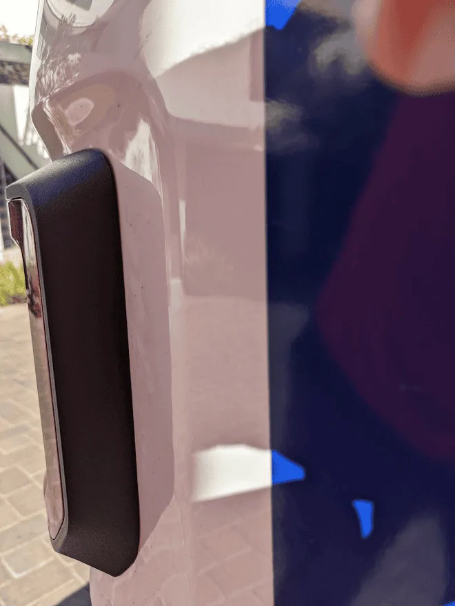

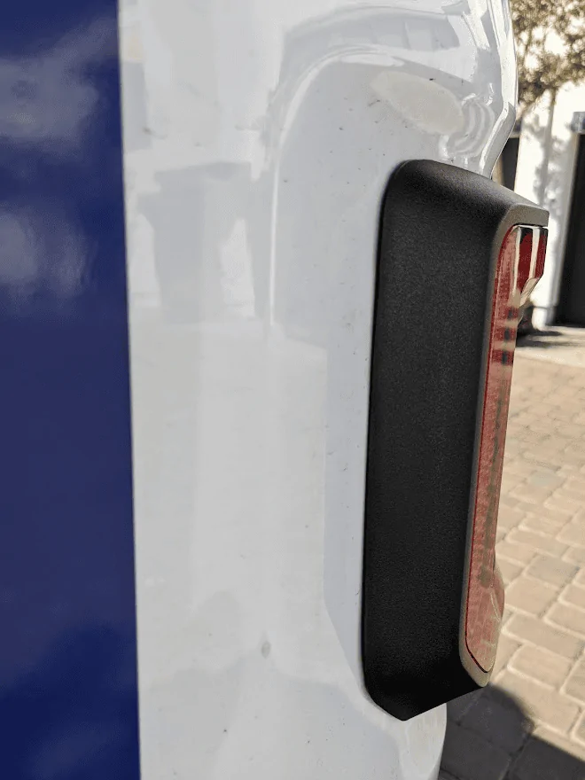

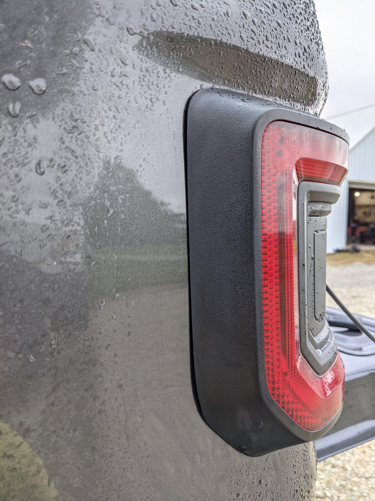

I tried that several times, it's just a different contour than the bed of the truck. If it was pressed into the body panel hard enough to form it to the light I imagine it would wear the paint off the bedside.
It looks like the bed has a slight curve to it that the lights don't match, hence the gap at the top & bottom. I'm happy with the overall appearance of the light, but this gap doesn't look great.
I think you need to move it outboard more from the tailgate side to wrap the front around. It does look like the middle of the side hits a bit sooner. I don't think you're going to have any issue with rubbing paint, they won't move.
Looking at that pic, I don't think that would even do it? Shape is simply opposite of each other..... hope I'm wrong, interested otherwise, but not if that is the fit.
EDIT: You have since added pics, I'll review, and delete if needed ha
EDIT 2: Yours seem to fit great!

You just gotta play around with the fitment to find the happy spot, hold it while you set the screws about 80%, enough to hold them temporarily but not fully tight, adjust as needed, and cinch down.

These really are no different than putting a bumper or sliders or fenders on. If you just show up and slap some bolts in there it'll attach but it won't be necessarily perfect. All the aftermarket replacement items need a little fiddling with to get things lined up as best as possible.
Even the Jeep stuff doesn't necessarily fit great if you look closely at it. My factory tail lights had a huge gap by the tailgate, just nobody noticed because nobody cared to look.
From the photo would say you need to loosen the bottom screw then push the top in. The bottom needs to be loose so the top can pivot.

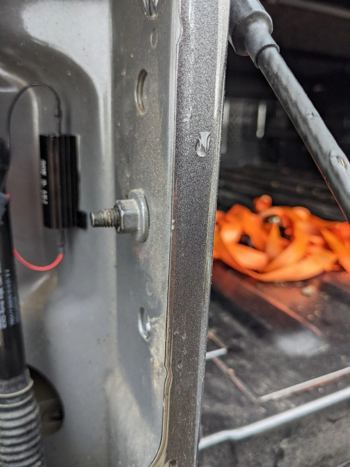

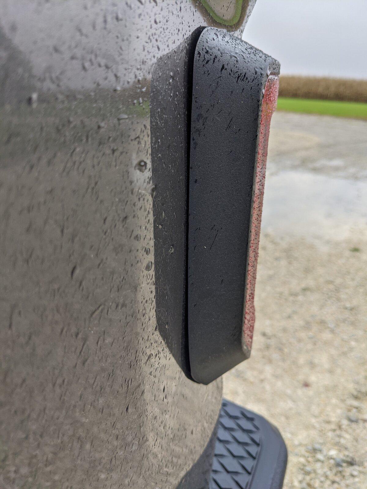

I noticed the same screw head issue that everyone else seems to have, so I bent that part of the sheet metal in a little to make clearance in case it was interfering. I pushed the light up tighter to the bed before re-tightening the screws but all it did was scuff up the paint and then rebound back. Not really sure what to say other than it doesn't fit the contour of my truck. I'm not too concerned but other people might care about this type of thing.

I had to take off the lights to finish my wrap. Sure enough, paint scraped off from the screw head in that very same spot as everyone else.
I even tightened it down as much as I could before installing.

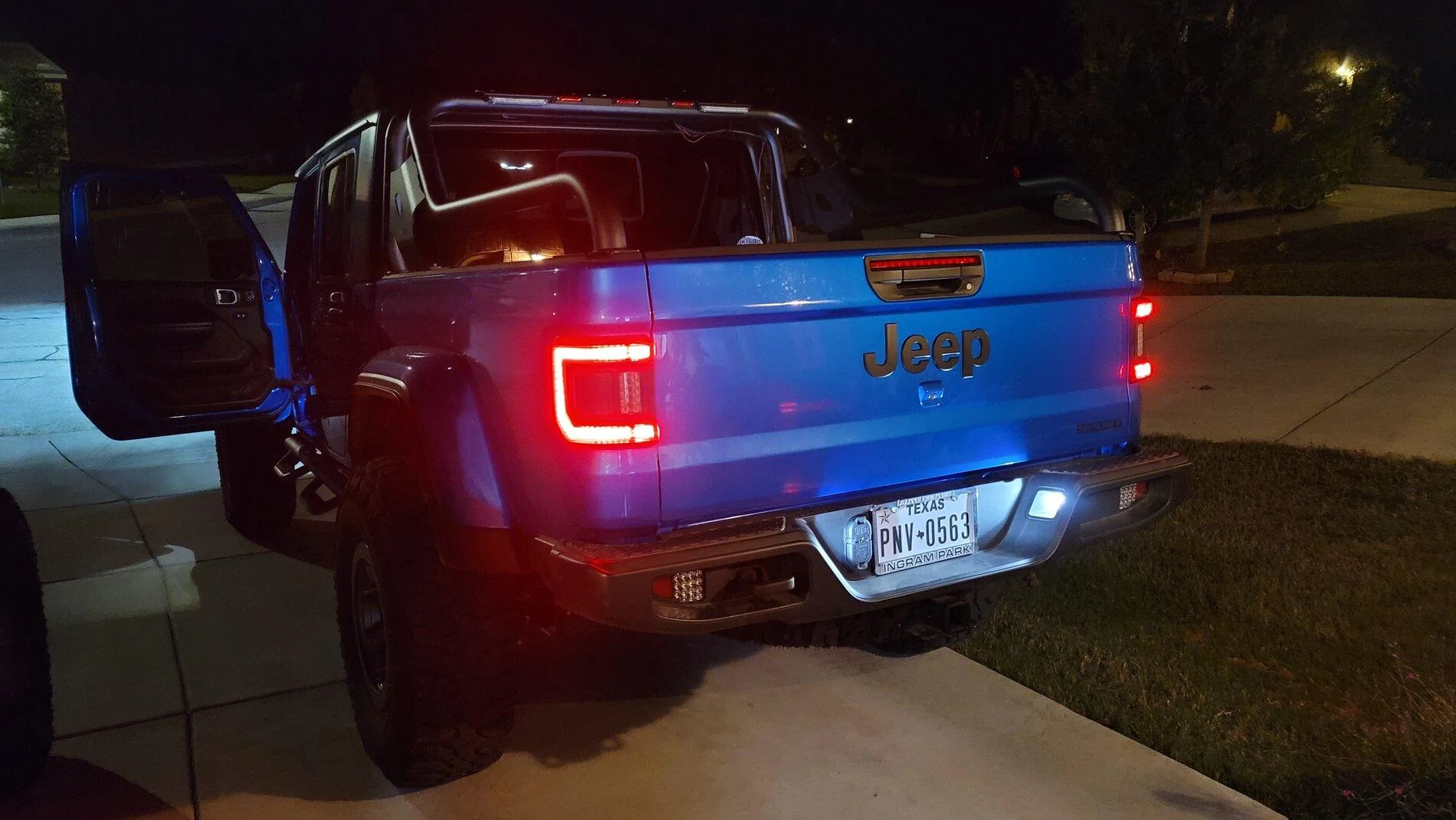

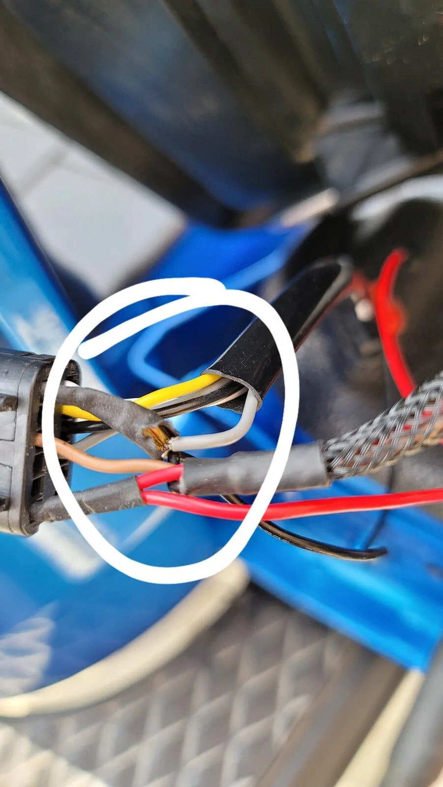

Got mine in ... replaced stock halogen.

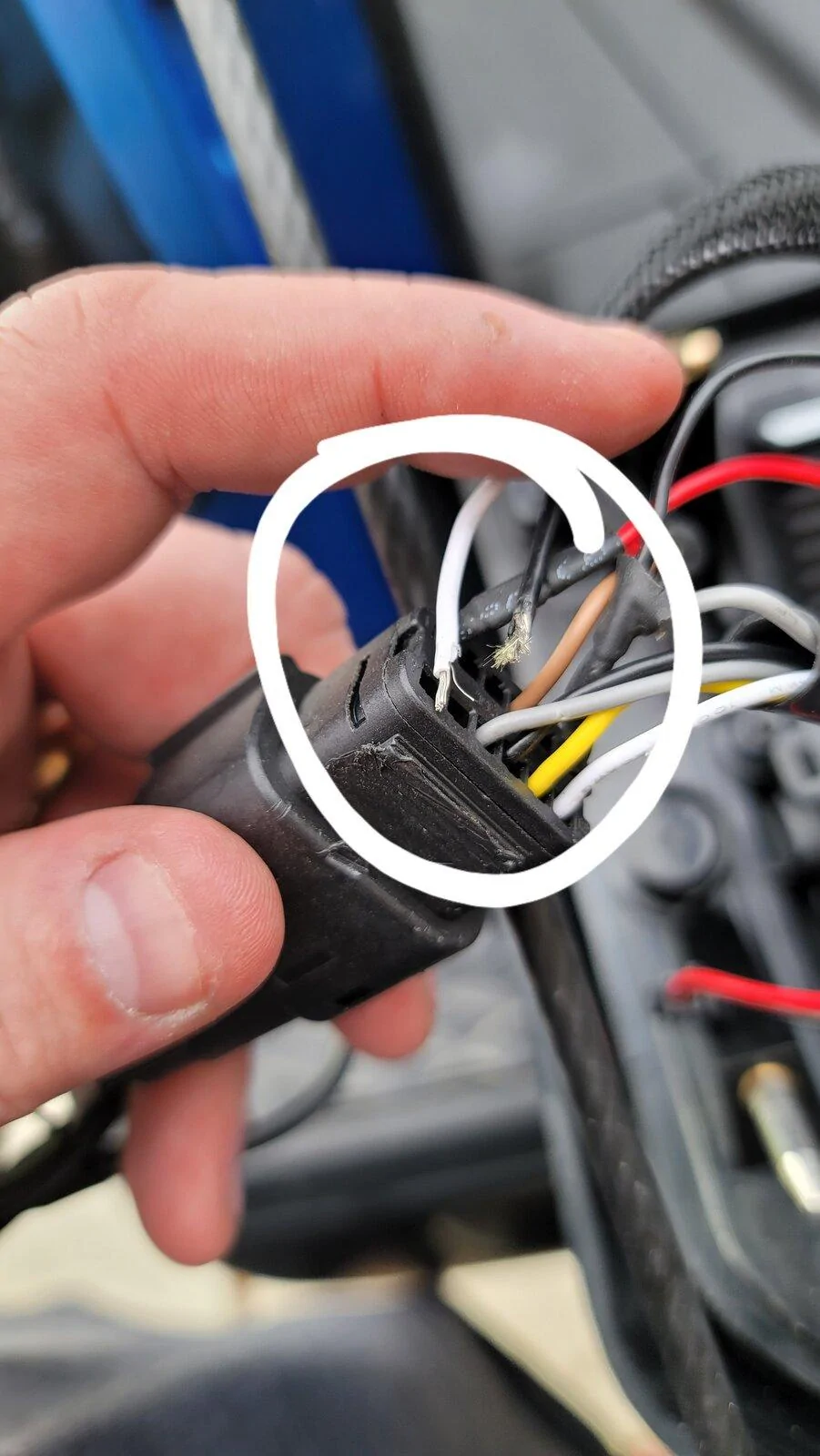

I screwed up and somehow ripped the reverse lights out of the plug
Jeep Gladiator Flush Mount Tail Lights 20211015_162752

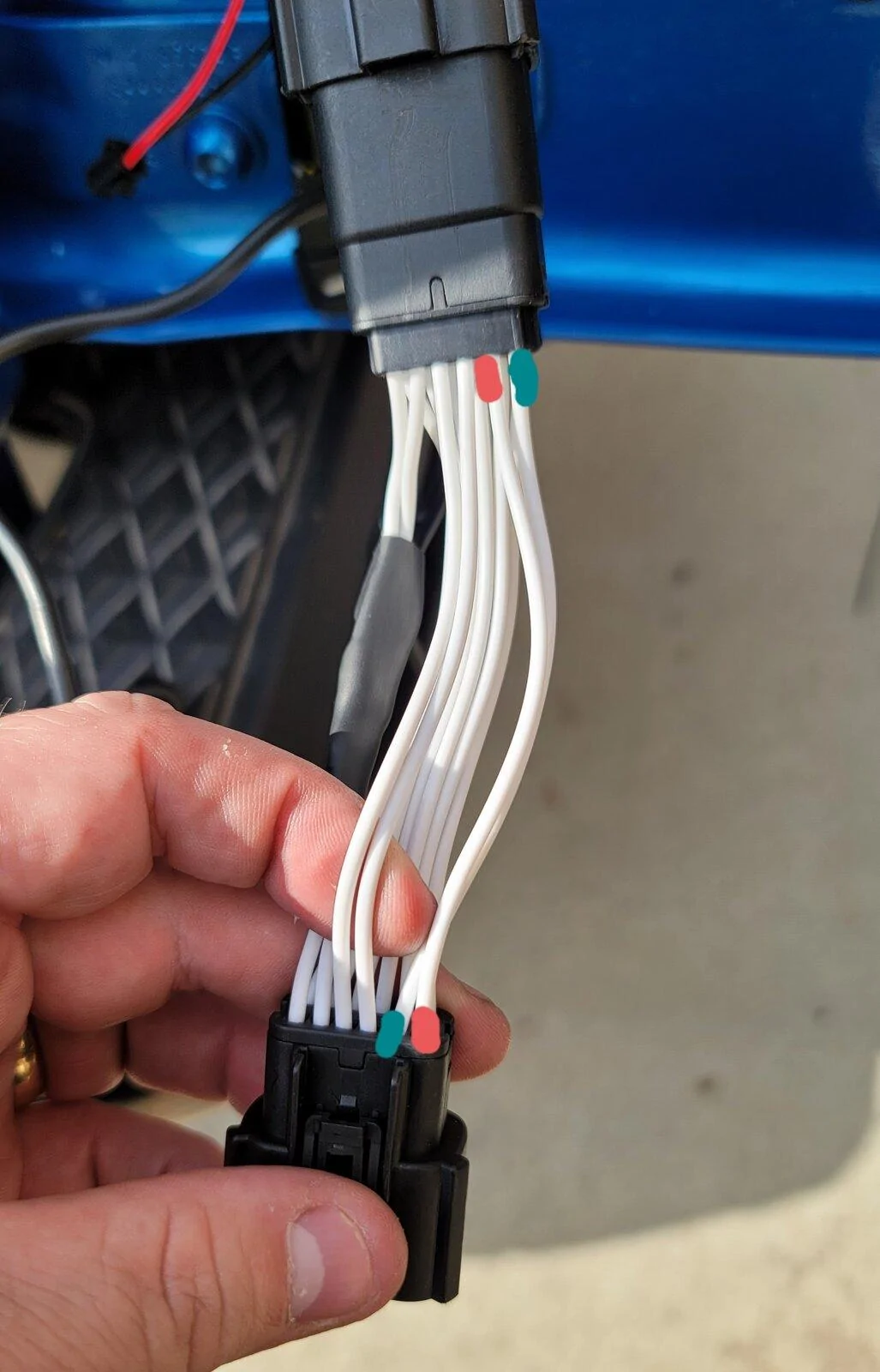

I actually had a few issues. My oracle reverse light harness was built wrong. There was a crossed wire. That caused the blinker to not work. I cut, flipped and spliced. That worked but then I had the above issue... FUUUUUHHHH
Jeep Gladiator Flush Mount Tail Lights 20211015_165246
I tried to cut what appeared to be the reverse lights in the harness to feed the broken wire but it caused the turn signal to stop.
In the end, I wound up tapping the brake lights for my reverse lights and I used that tap to also feed the broken tail light reverse light (not the bumper) wire.
It isn't pretty but its working.
Oracle please charge $5-$10 more and give us better harnesses. This is a crappy splice.
