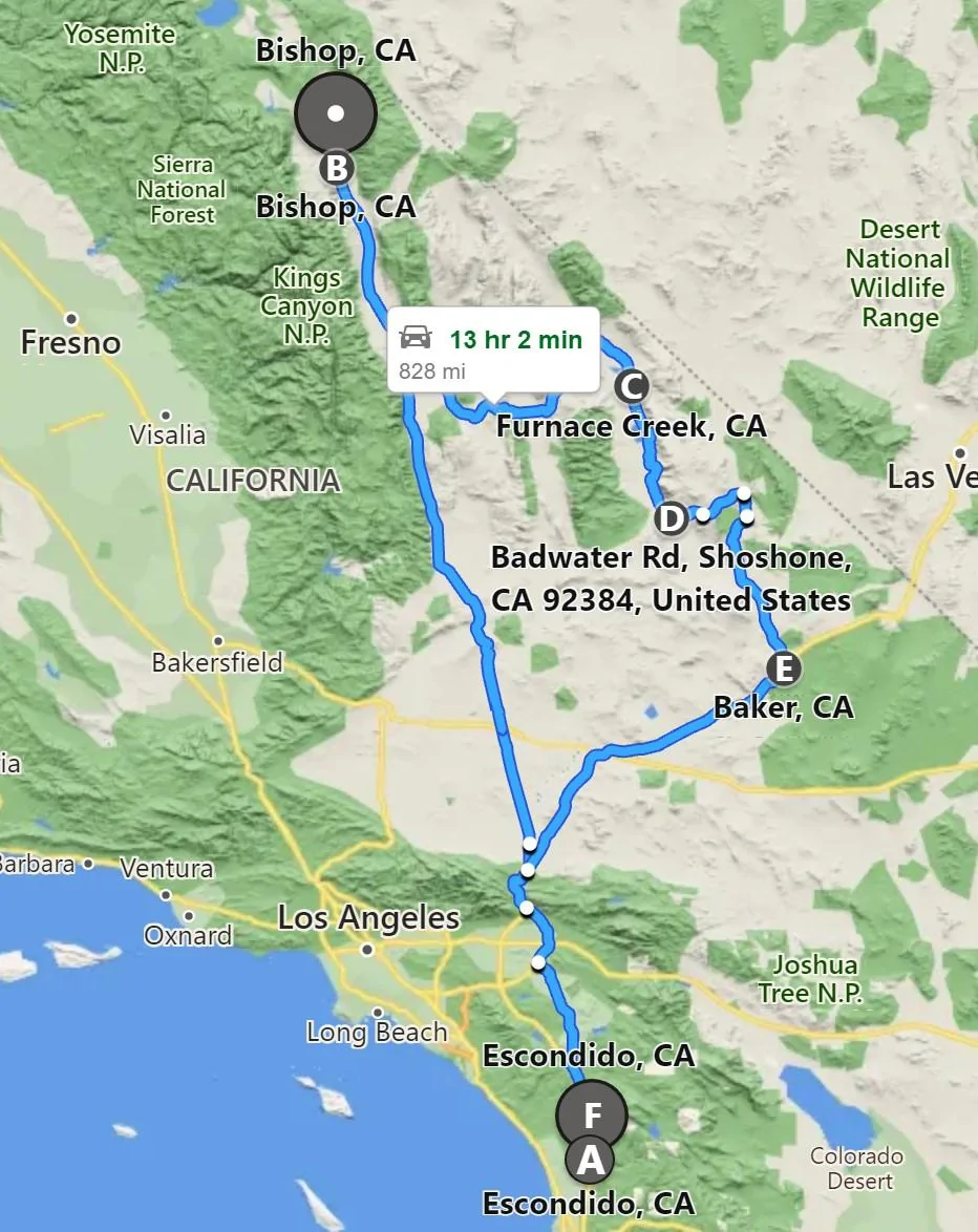

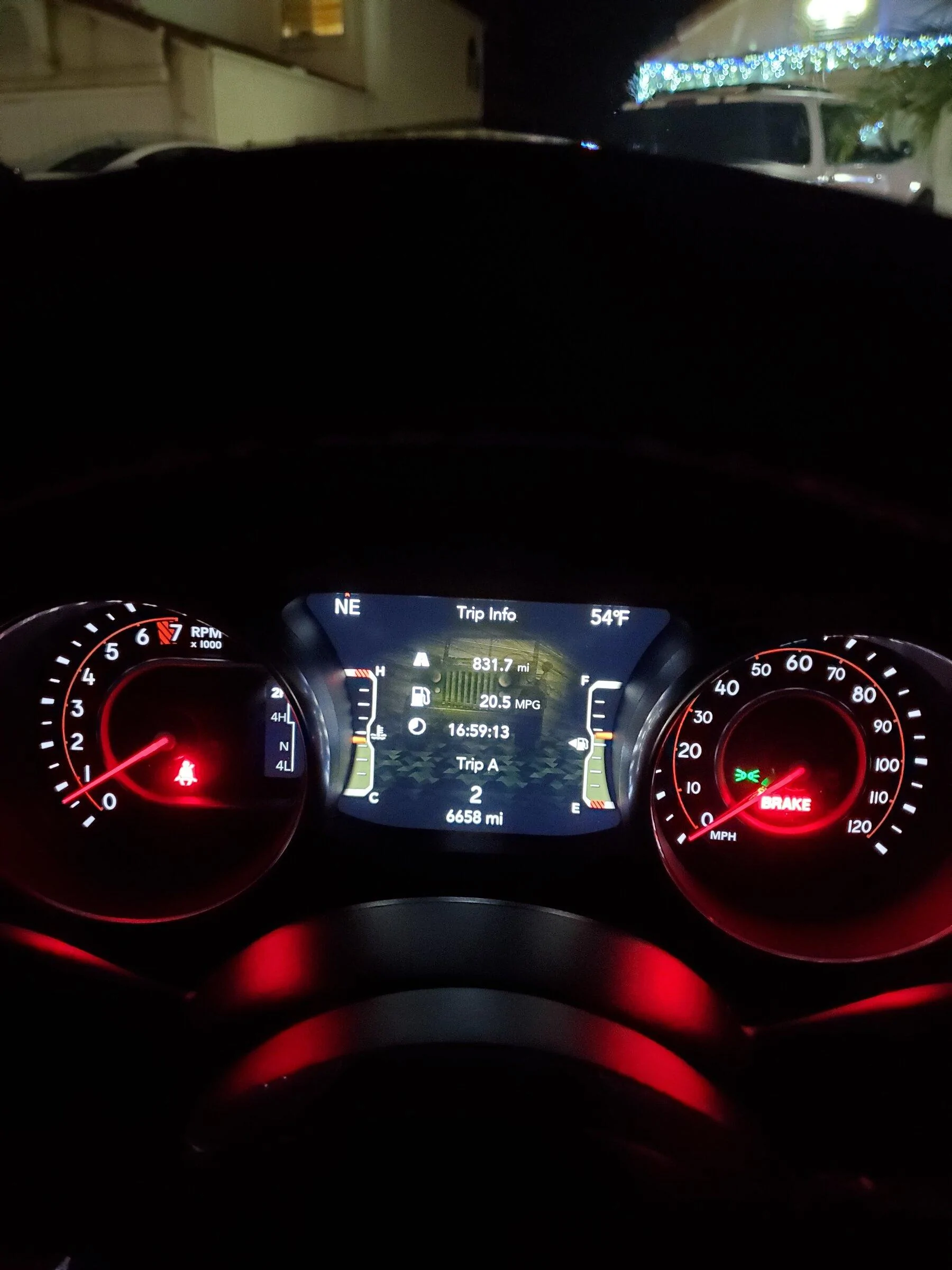

Well, I did a long road trip and had all sorts of terrain to go through. Mountain passes, highway driving, Hevy rain, slow driving in 4H through snow on the highway and over the Panamint mountains with a few 4500 ft. peaks. Also a long stretch of stop and go traffic from Baker down through the Cajon pass. Two people and gear. Here is the route and the end stats from the trip meter. I have to say I am pretty pleased with the mileage results. Beautiful route as well. I highly recommend a road trip like this.
