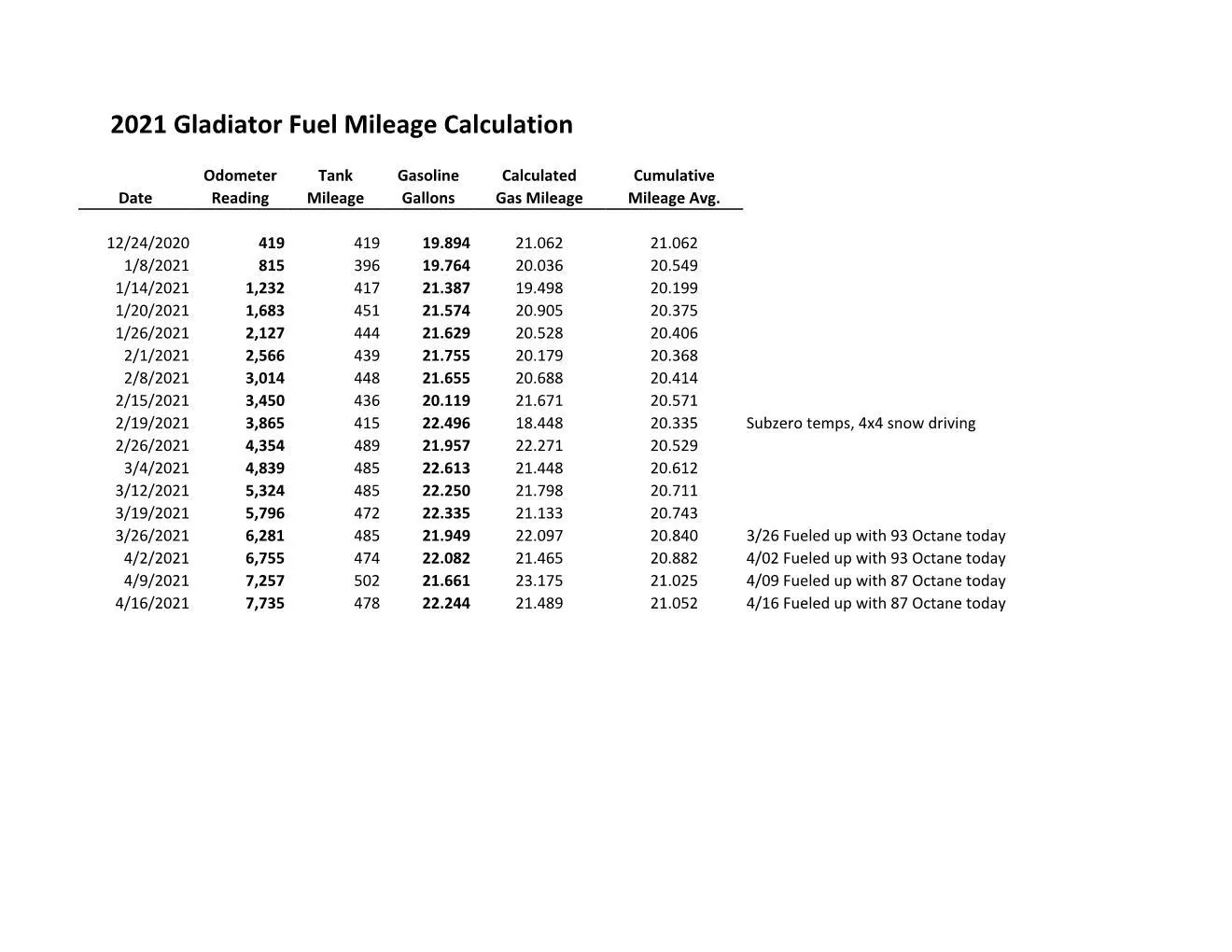

2021 Overland, manual trans, HT tires, pretty much bone stock. It's currently displaying 23.2mpg as of this morning. On my old Ram I knew that the truck's avg. mileage was taken over the last +/-350 miles, but I'm not sure what our JT's use. 70% interstate, 20% rural 2-lane, 10% city.
Regardless, 23.2mpg is almost 2mpg better than the last-tank average I calculated by hand.
Jeep Gladiator Gasser real world fuel economy Gladiator Gas Mileage 2021-04-16
