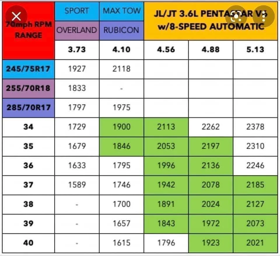

5.13 is a bit crazy to me, especially with a 8 speed. If we were all still stuck with 4,5, and 6 speed autos or manual it would make more sense to me. I'd say as long as you fall in a colored square, mechanically your fine. Its just to personally preference as to what's your taste.
Generic list - 65mph at 1:1 trans gear.
Thanks PuddleJumper the color coding really makes it clear
That chart is totally incorrect for a JL/JT with the 8 speed auto. Here’s the right one for our trucks:
Jeep Gladiator Gear ratio poll for 37” tires on 17” wheels 3.6 gasser IMG_0182
I just did 5.13’s on mine with 37’s and I’m very happy. I’m turning about 2250 RPM with mine at 72-74 MPH. Fuel mileage is still good, 18-19, which is about what I was getting with the 4.10’s. The power, especially when taking off, is way better.
