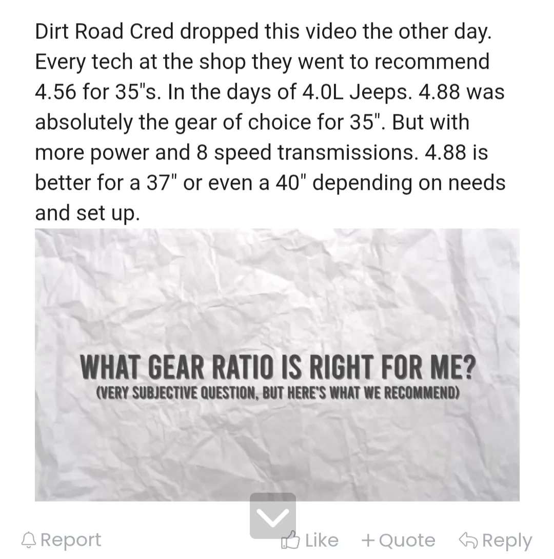

Dirt Road Cred dropped this video the other day. Every tech at the shop they went to recommend 4.56 for 35"s. In the days of 4.0L Jeeps. 4.88 was absolutely the gear of choice for 35". But with more power and 8 speed transmissions. 4.88 is better for a 37" or even a 40" depending on needs and set up.
I agree that 4.56s are plenty of gear if you're going to 35s. Of course if you already have 4.10s it is not much of a difference so you won't see much gain. Now if you started with a JLU sport with 3.45s I'd recommend a regear for 35s. If you were ordering new axles or adding lockers a regear would make sense for 35s. The other factors like warranty on your stock lockers are all the more reason to use your mod money somewhere else. Going from 4.10s to 4.56s will likely make less of a difference in drivability than a tune... which is a lot cheaper. Of course every shop that regears is going to suggest a regear... they make $0 off you if you realize the cost vs benefit doesn't make sense.
He said He personally went with 4.88
4.56 with 35's yes no additional weight overlanding etc.
4.88 with extras.
