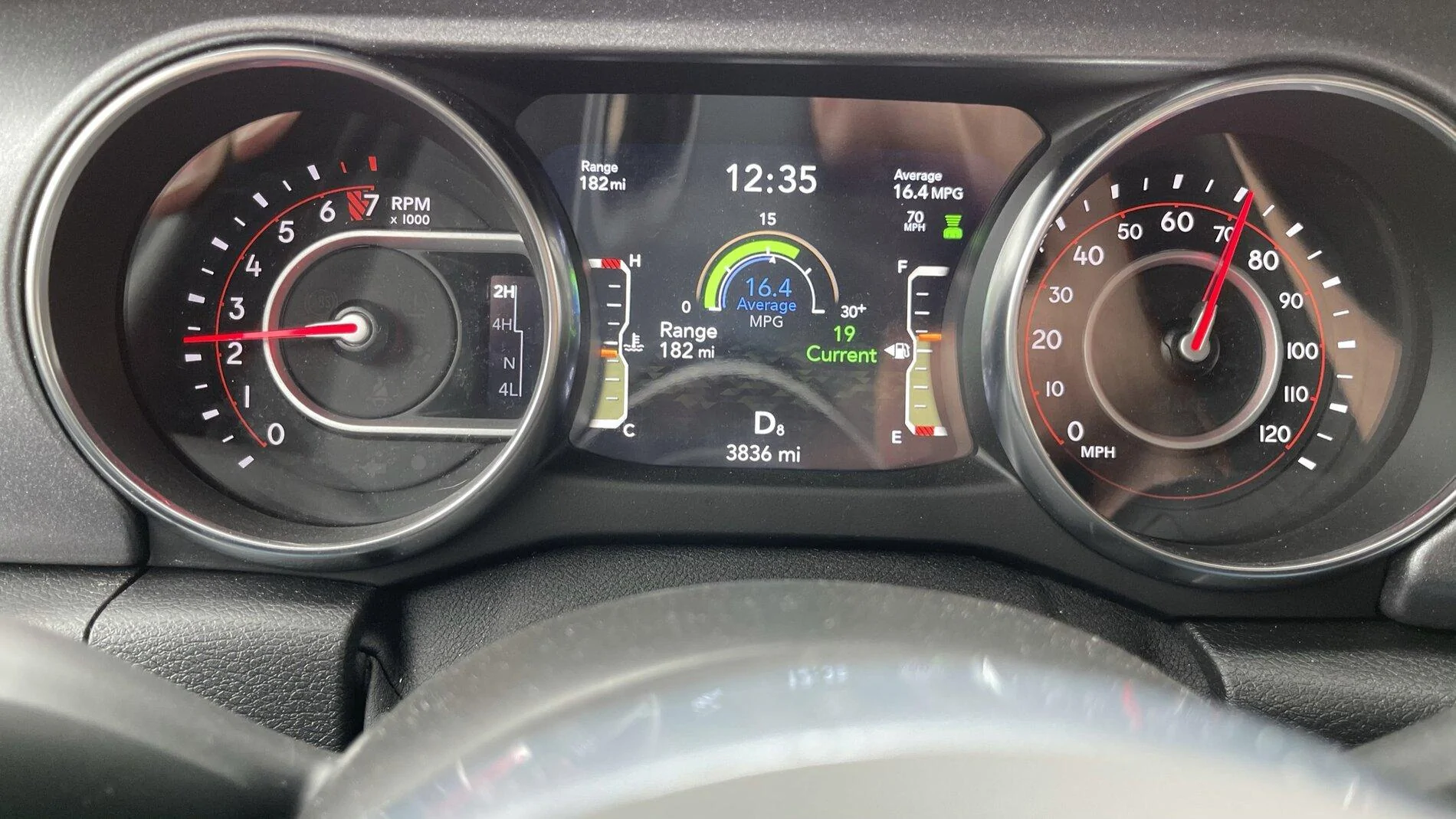

OK 300 miles on the gears, and they have been tempered... getting the diff fluid changed in a few days at 500 miles. AMAZING results so far. was at 11.7 MPG, now 16.4, shifting is correct as it used to be, and RPMs are down! this is the best change I have made yet.
That's awesome results! Plz remind us what your setup is and the gears you chose?
3.5 inch metalcloak game changer, 37x13.5 toyo open country, steel bumpers front and rear, metal cloak diff covers, and yukon 5.13s afe intake, TBS, and shorty dump exhaust, and iDrive pedal commander, and AFE scorcher remapping for the air intake, and a procal programmer, and a bunch more stuff.
