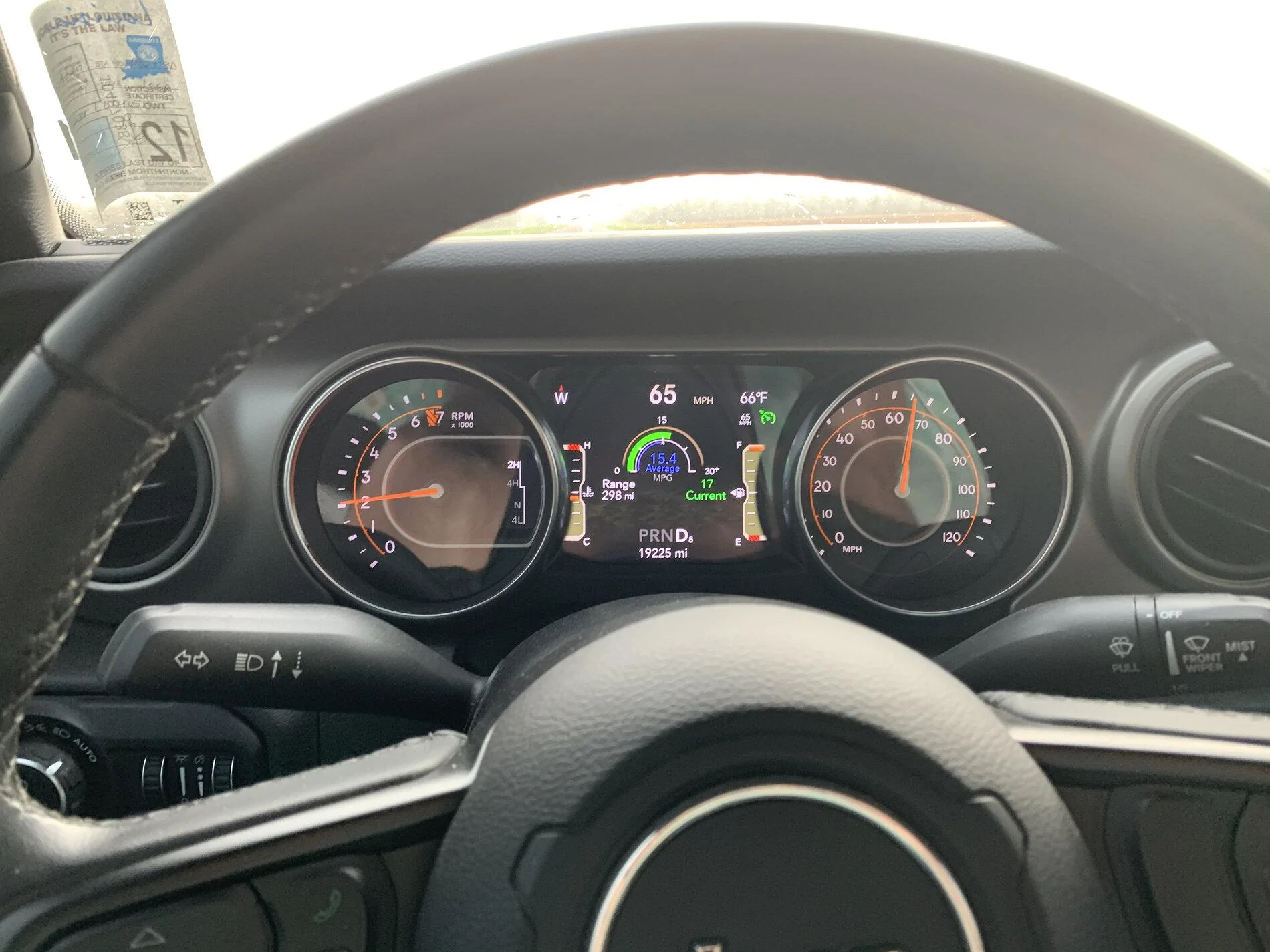

75mph on 5.13s on 37” Cooper ST Maxx. I don’t think 80mph would too busy.

@mellendic and @AZCooWhip, @StingyJT thats incredible!!!
You can see my signature with what I’m running in flatland Louisiana.

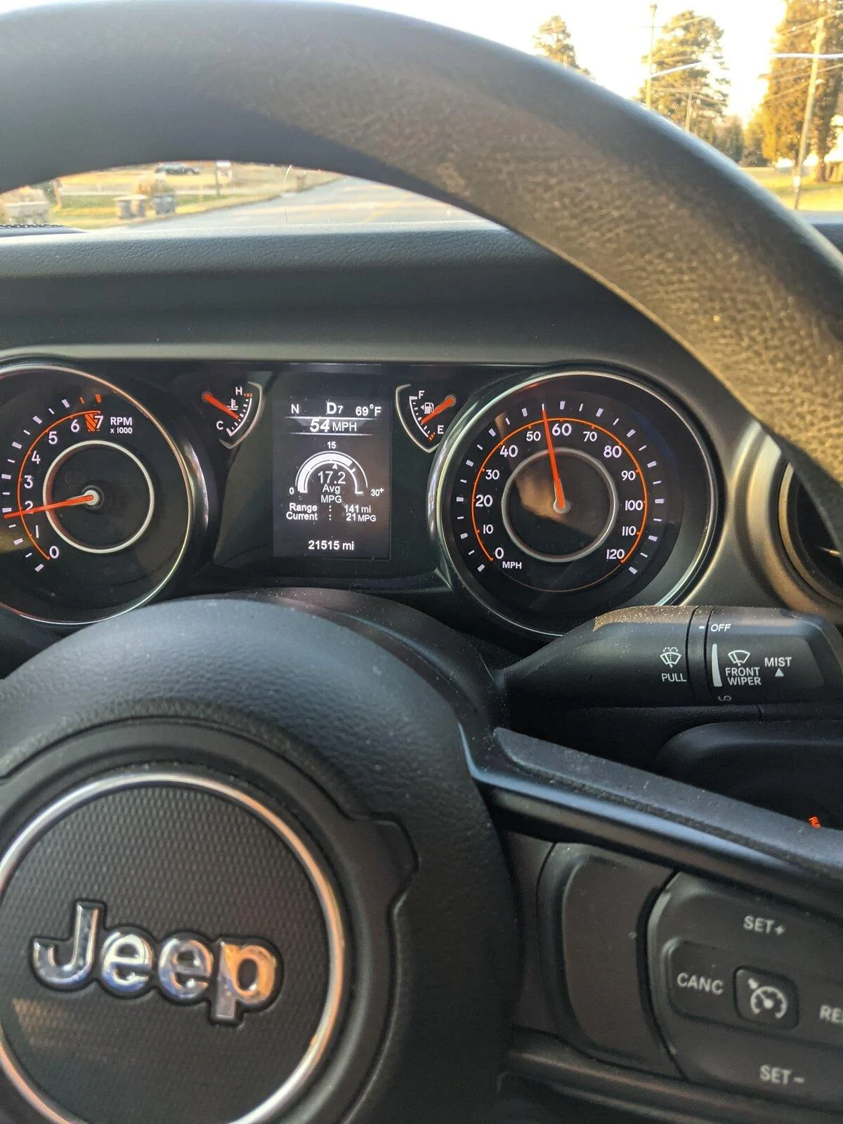

The picture is no wind and flat road with cruise. This is why I can't see decent mileage... it won’t get it.
I swear some JT’s do extremely well and others are like mine. Very disappointing

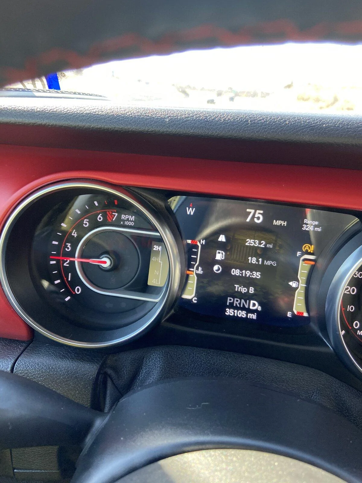

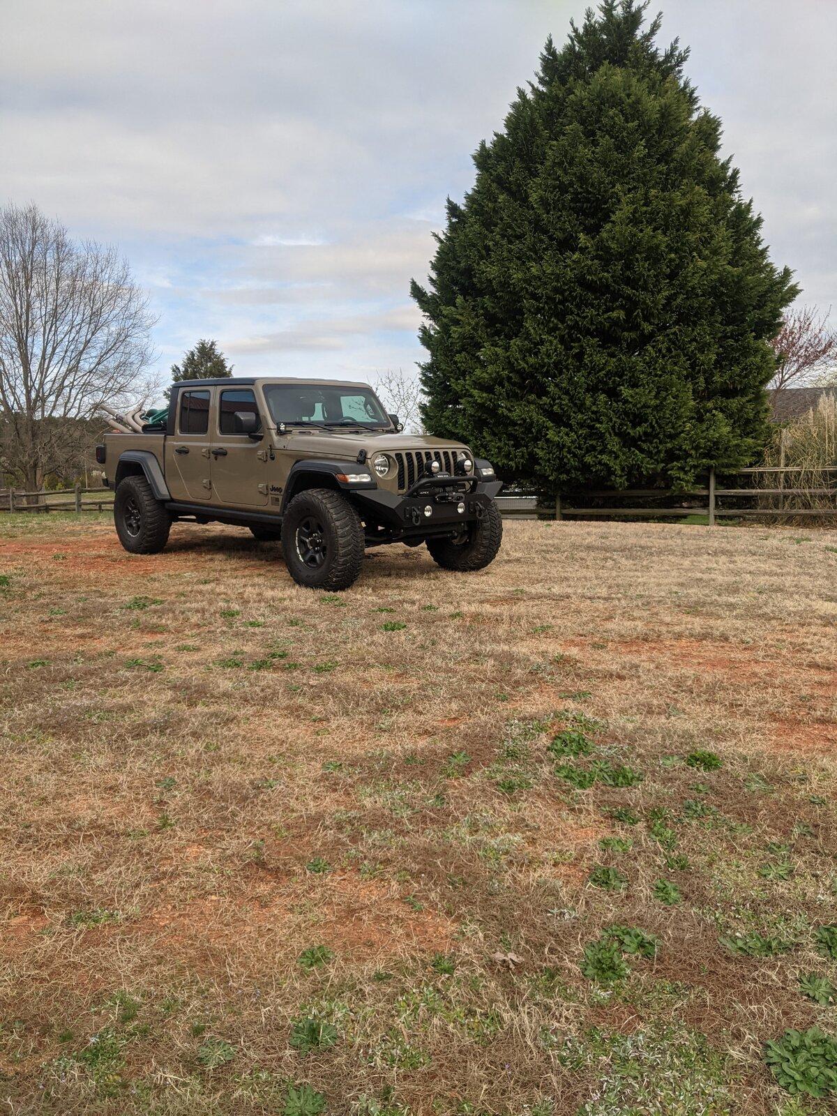

4.10 gears and I'm dead on at 72mph and averaging 17.2 mpg, had it almost to 18 a few times. I have 2 5" Readylift installed with Rubicon take-offs on a Max Tow, got almost 3,000 miles on it since putting the 37's on. My shift points are pretty much spot on and it doesn't feel likes it's dragging and it gets up to speed great as well. I normally stay around 70-75 mph on the interstate, my driving is a 60/40 mix of city/hwy.
Jeep Gladiator Gears for 37" tires PXL_20210320_203733333
Yes, but you are in 7th not 8th.
