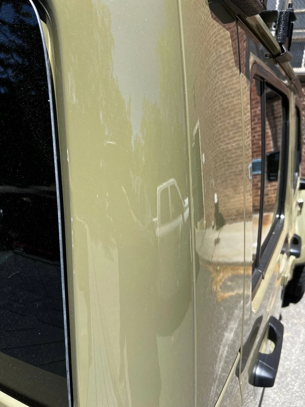

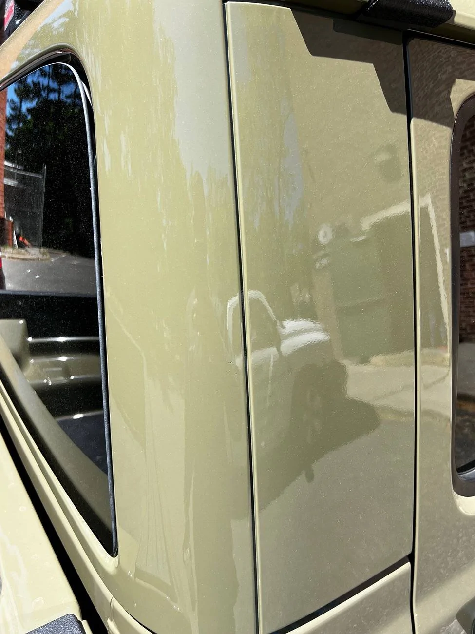

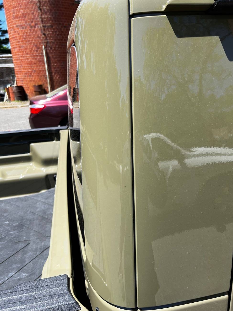

Giving my new truck it's first good wash and noticed this... WTF?

Who doesn’t inspect every square inch of the new vehicle you’ve paying so much money for?
Jeep Gladiator Giving my new truck it's first good wash and noticed this... WTF? IMG_5434
Jeep Gladiator Giving my new truck it's first good wash and noticed this... WTF? IMG_5435
Jeep Gladiator Giving my new truck it's first good wash and noticed this... WTF? IMG_5437
These pics are not zoomed in. Couple it with the fact that it's rained like 10/14 days ive owned the truck and yeah it was missed. Also if it was an ice pick you'd see the cracks in the paint where holes are like papa said
Apparently, few have seen the results of teeny air bubbles in substrate - in the surface under the paint, or the effects of silicones on paint.
If it was my truck, I have access to really fine pins in my wife's quilting accessories and would likely "probe" to see how deep that goes - it's very possible there's a defect in the surface below the paint. Paint won't flow over tiny pin holes in a surface below. Anyone who has worked with fillers, "Icing" is one product, there are m any others, if there's not a perfect surface for the paint to flow onto, it won't cover over holes.
If there's any traces of silicone on that surface, or any oil from a finger, paint won't flow over it, it goes around it and pulls back from it, leaving a "hole" in the paint.
Usually silicones and oils cause a "fish eye" effect, larger than those. That looks almost like an imperfection in the surface below the paint.
Paint won't cover holes (and you don't want it to).

That is the main reason I avoided buying one with a painted hardtop. @ShadowsPapa is right, that is a paint defect from bad prep when was painted.
