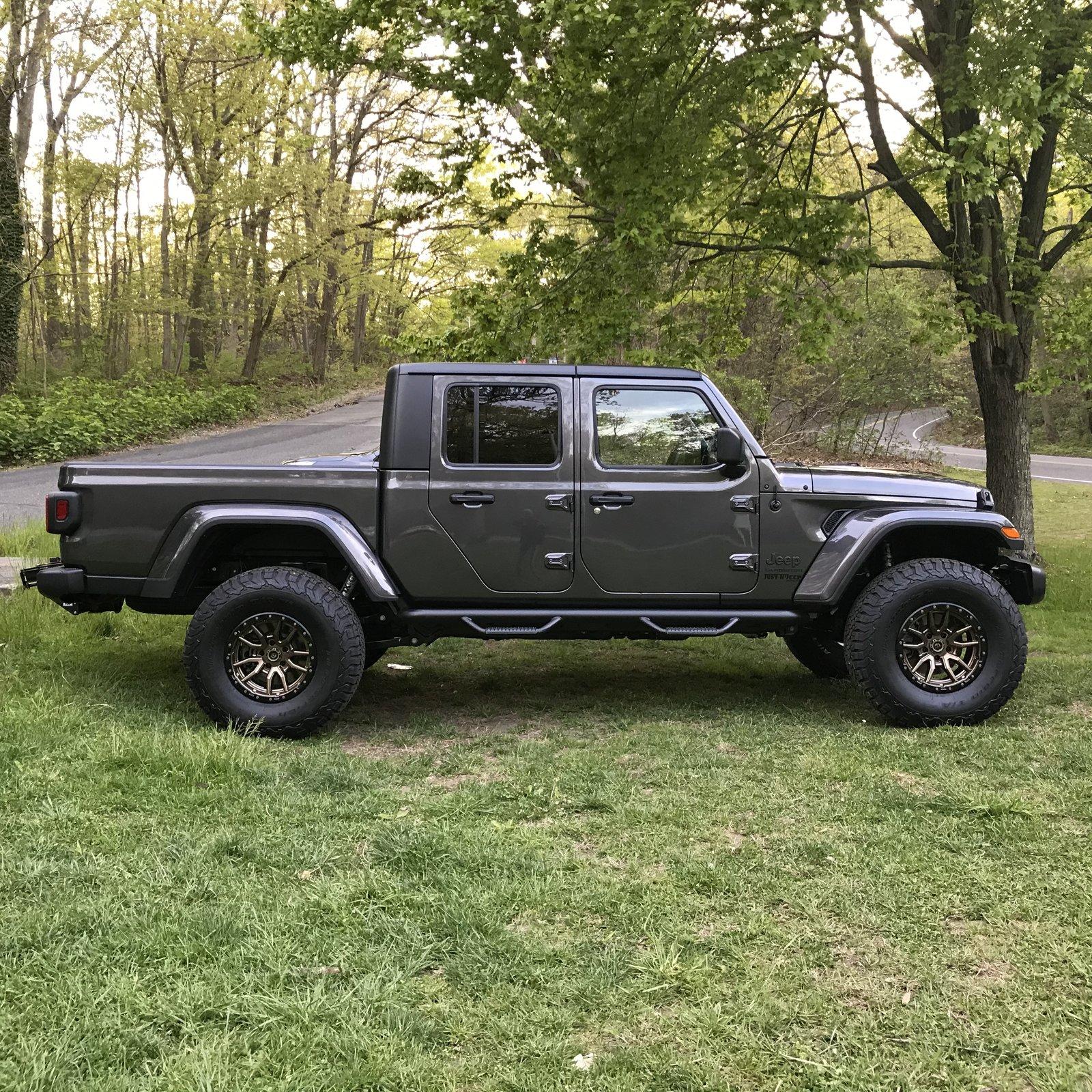

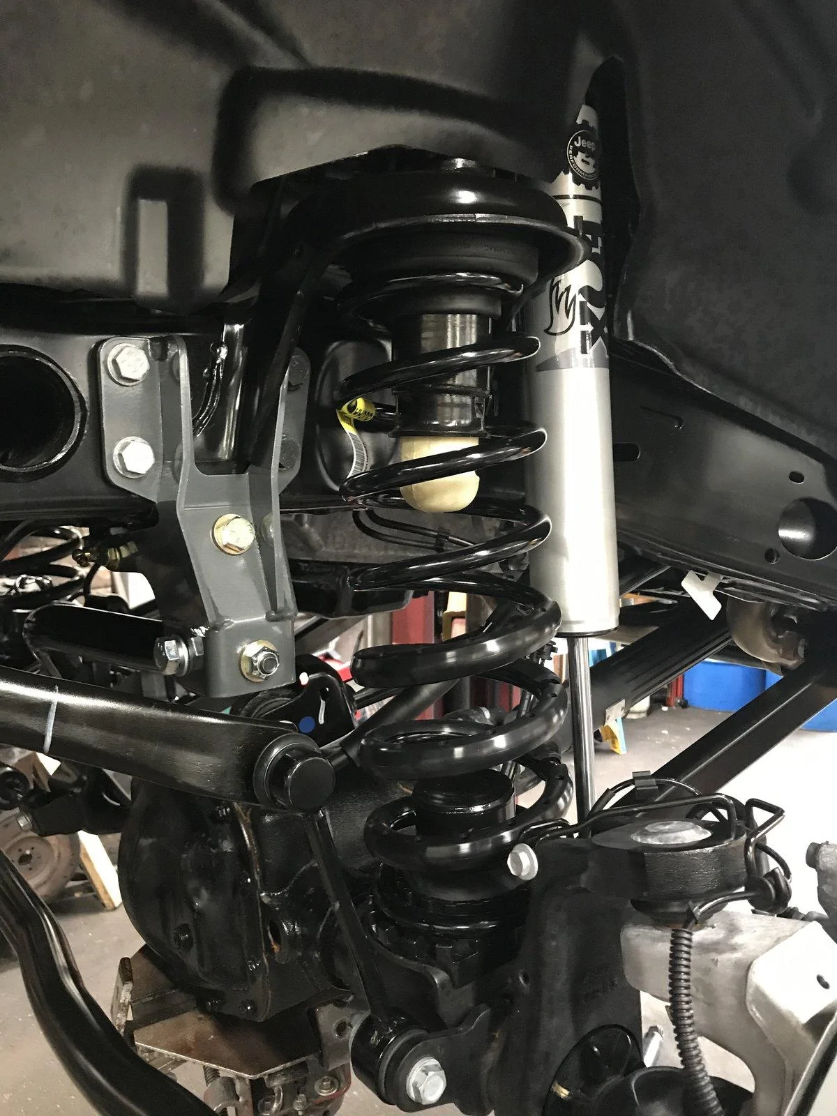

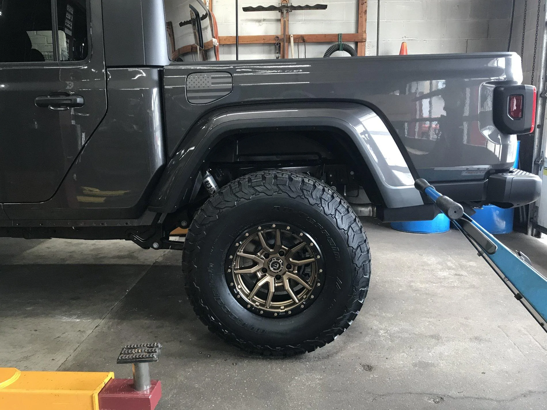

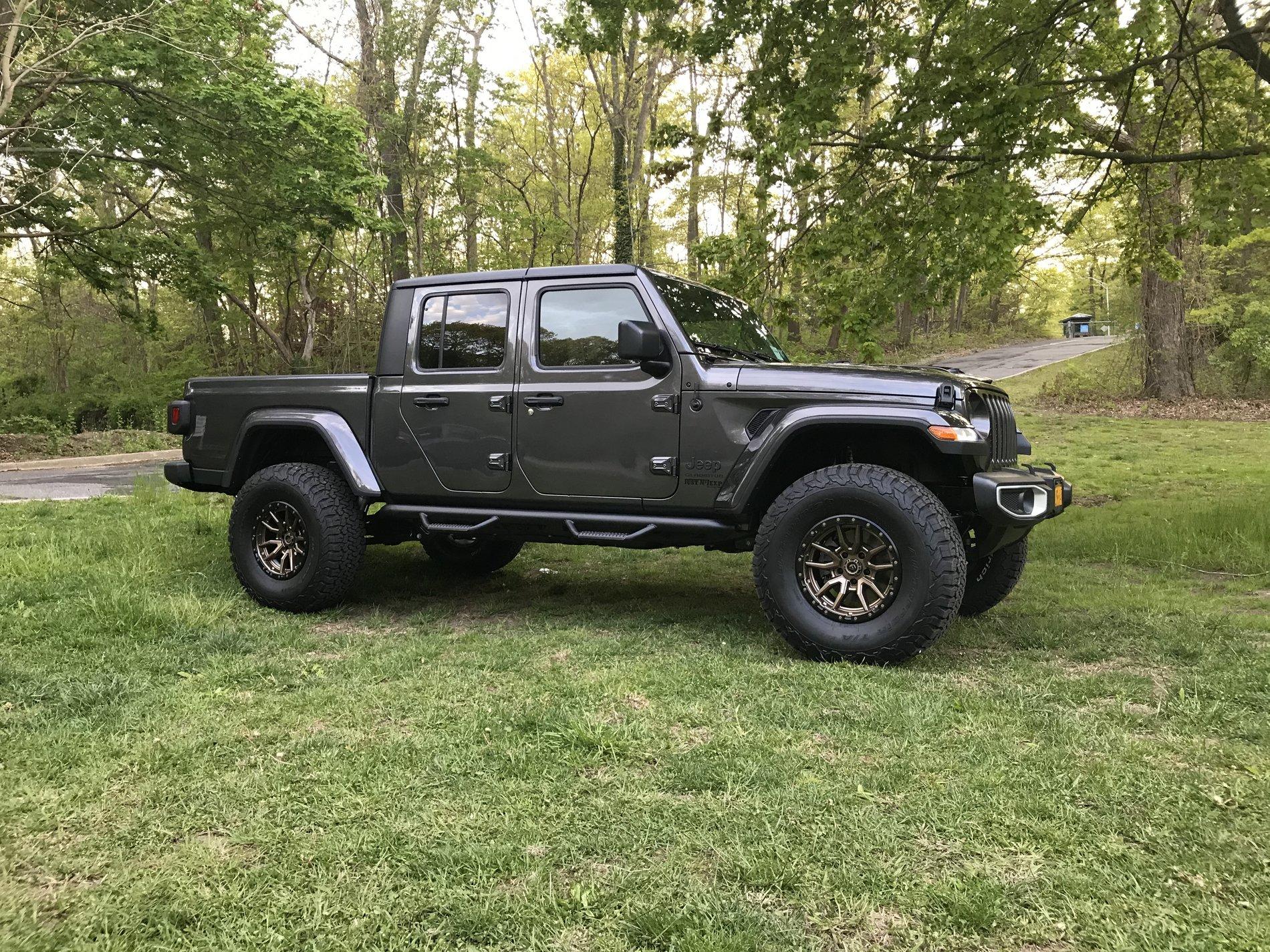

BFG KO2 37”, Mopar 2”, Teraflex 1” spacer, JKS adjustable track bar, Synergy brace and Fox steering stabilizer. Solid alignment and it drives like a fvcking dream!!

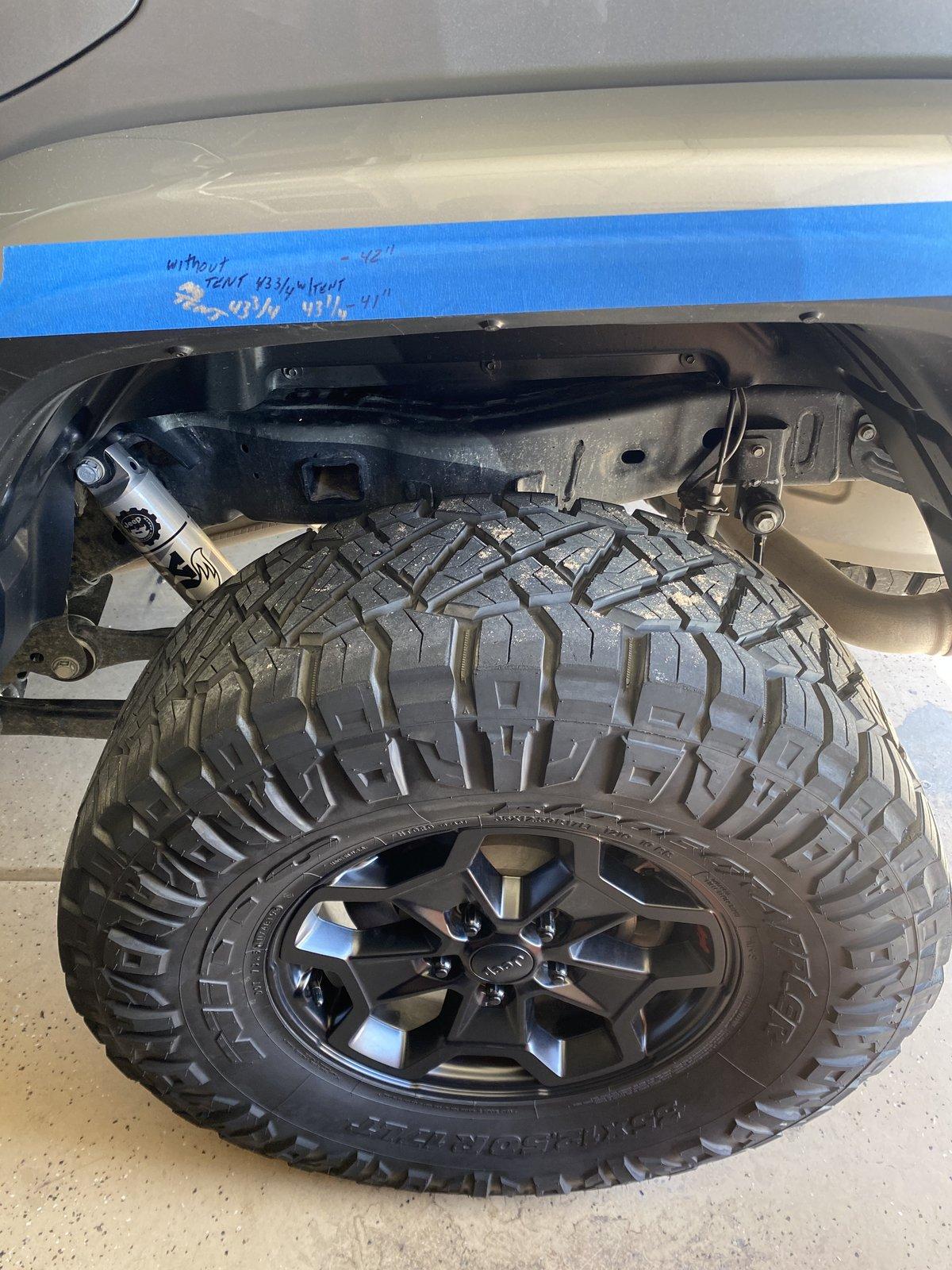

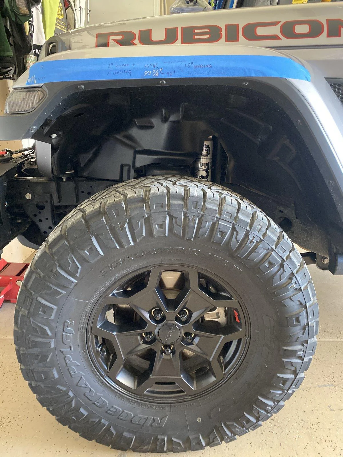

I had close to the same set up (35” tires with the teraflex 1.5” leveling kit).
I just installed the Mopar lift and went with the 1” teraflex spacer and removed the 0.5”spacer. In the front I went from 42”on the trim of the fender to 43 7/8” measured to the same spot. In the rear with a rooftop tent(RTT) I went from 41” on the trim of the fender to 43 1/4” measured to the same spot. I took the RTT off and I measured 43 3/4” to the same spot on the rear fender.
The spacing from the top of the tire to fender is 9.5” in the front and rear. It looks pretty level to me.

I’m on the fence about bronze wheels on my GCM Gladiator, but yours makes a good case for them!:like:

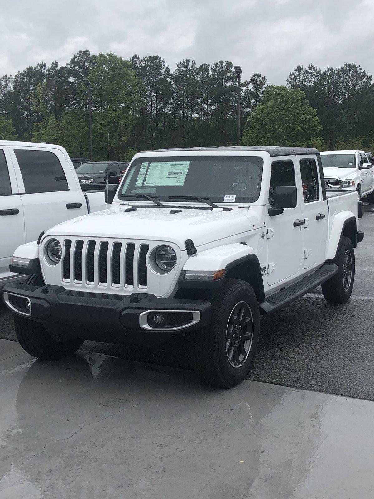

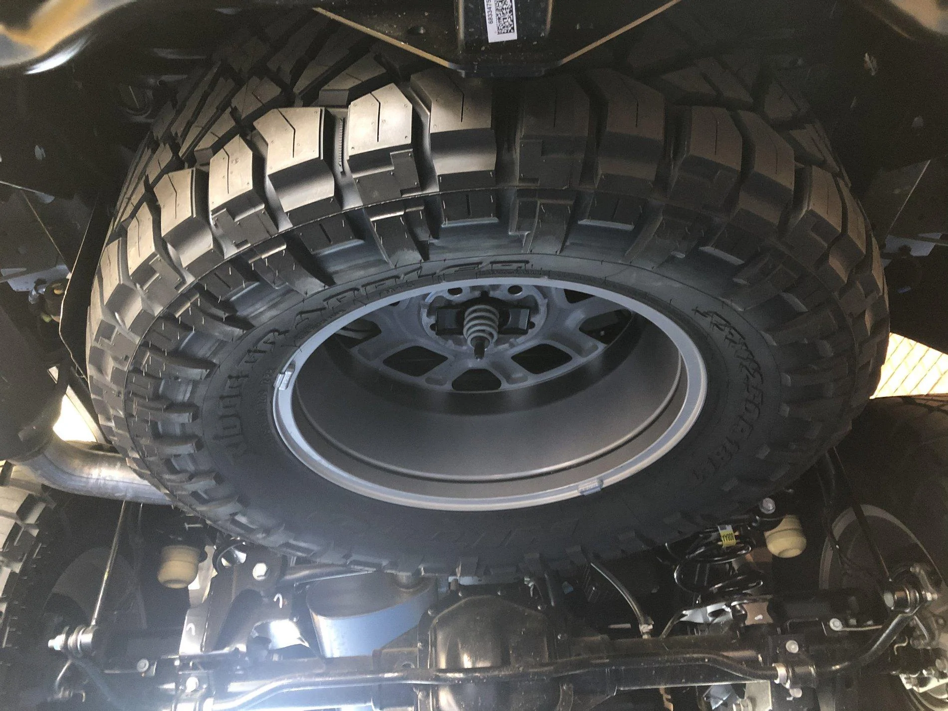

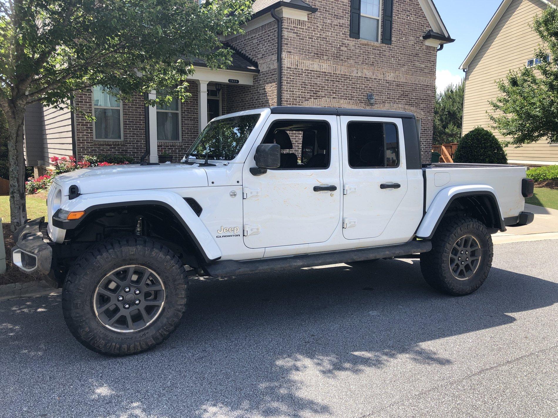

Before and after (purchased and 2 days later delivery). Mopar 2” with 35” Ridge Grapplers on stock rims. Rims are a touch narrow and the tires also rub at full lock. A 35” spare fits perfect and have seen some 37” stuffed up there too.
