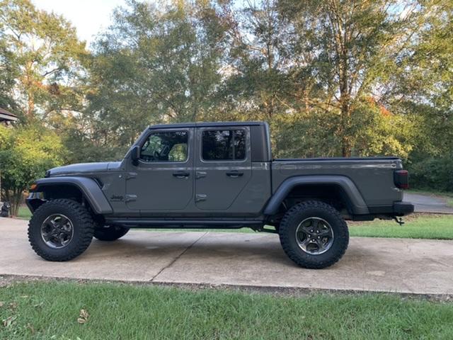

2020 JT Rubicon

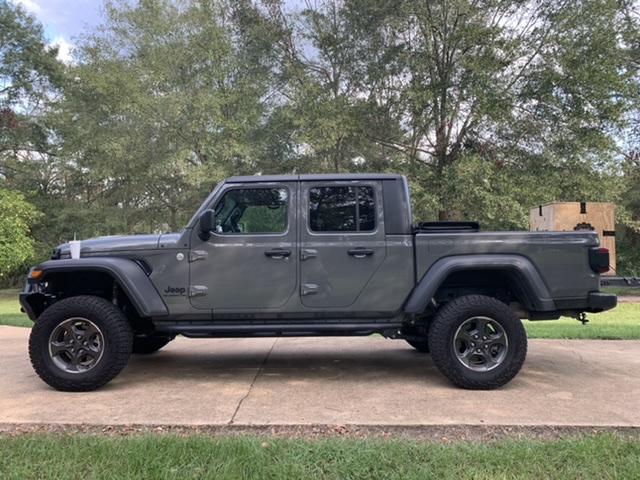

2” mopar, 35” Klever r/t’s, 17x8.5 KMC Dirty Harrys with O offset, the wheel lip itself sticks out 7/8” (test fit wheels before tires were mounted) as best as I could to keep the tires under the fenders without looking dumb. And yes, i loosened all the control arms as I was under the Jeep with an impact, makes quick work and does seem to help things loosen up and not be torqued/pull any one direction
Sweet wheels man.

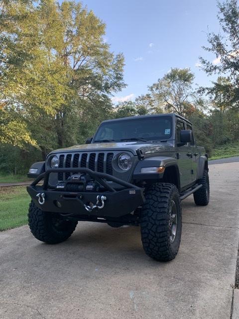

Mopar lift, 1.5” Daystar front pucks, adj trackbar, steering geometry brackets, quick disco’s. Rubi wheels & tires ar the moment.
fishbone medium bumper and 12k winch.
Regardless of how the pic looks, my tape measure shows 1” diff in rake.

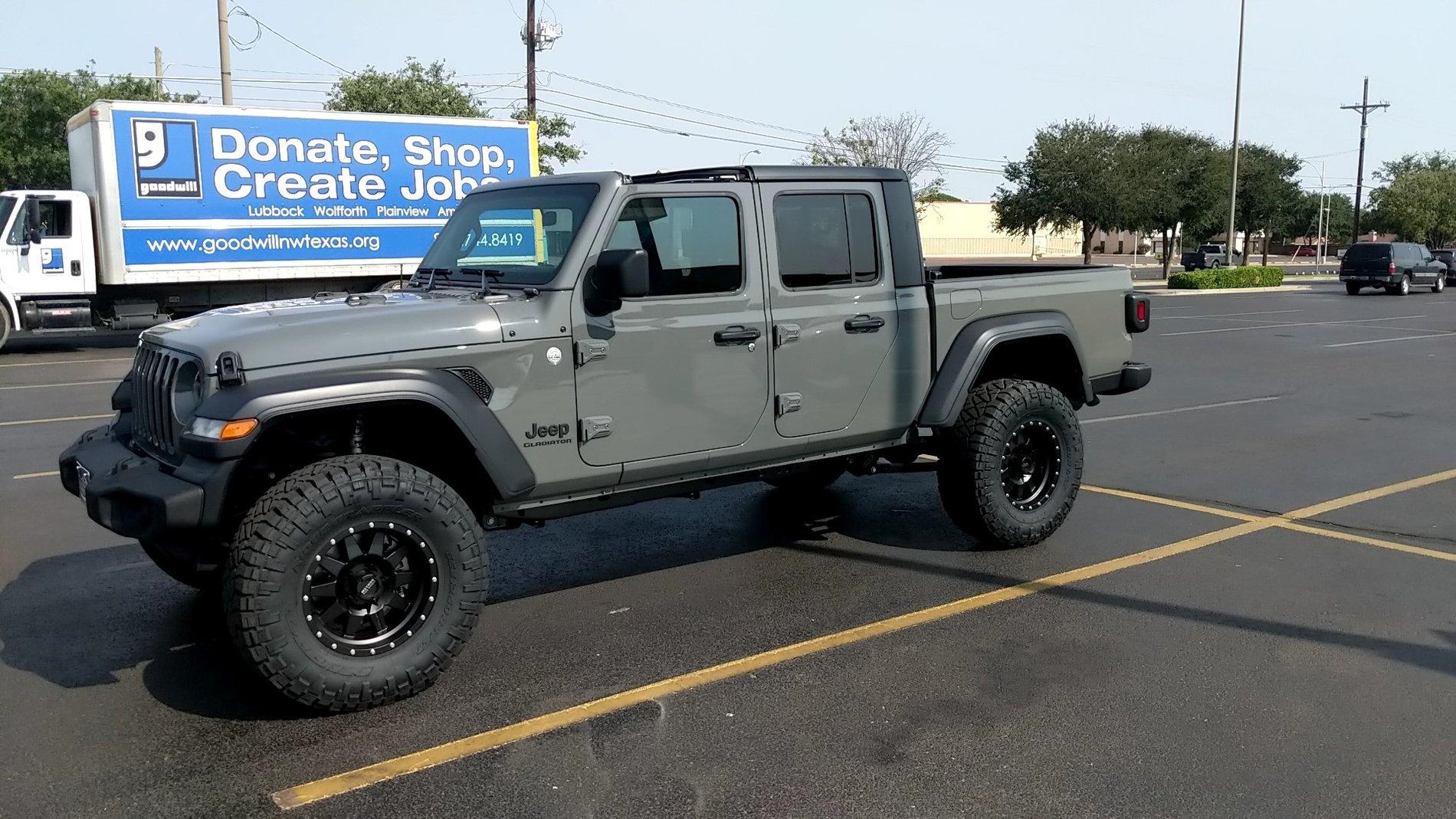

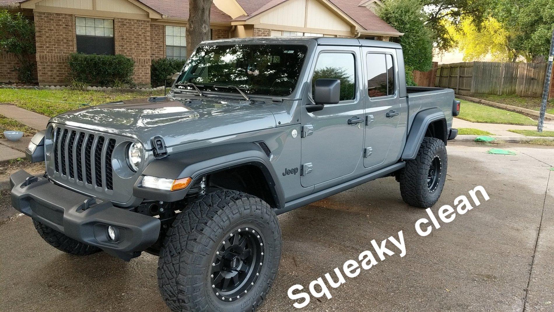

Love my Mopar lift. Bottom one is the day after I got the truck, top one was taken yesterday after I washed her.

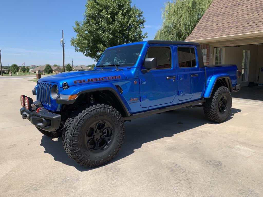

Mopar 2" and Clayton track bars f+r:

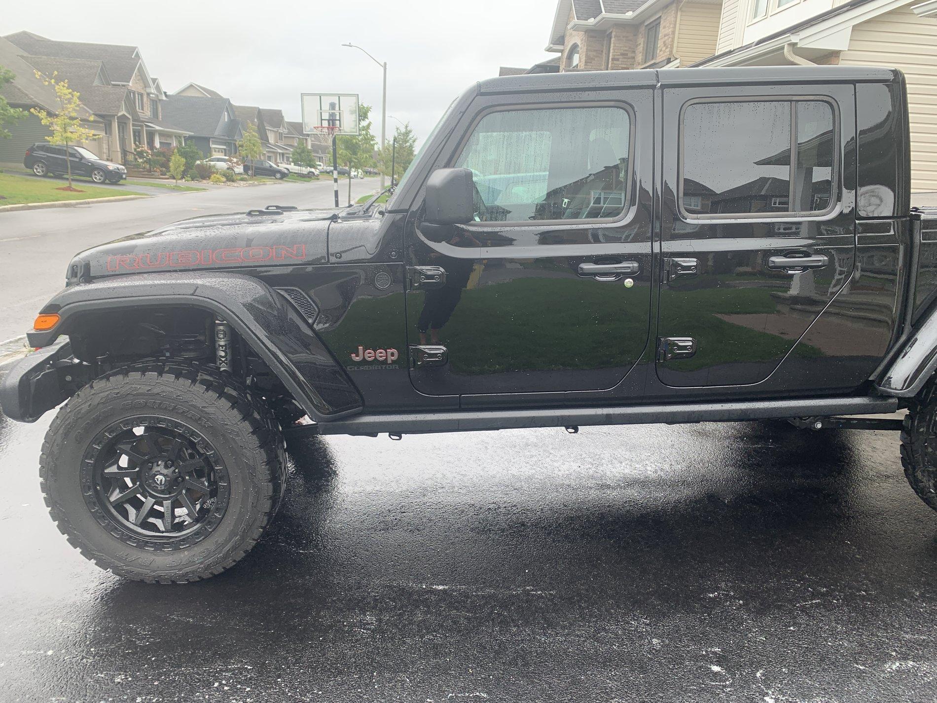

35/12.5 R 20. Fuel Wheels
Toyo R/T tires.

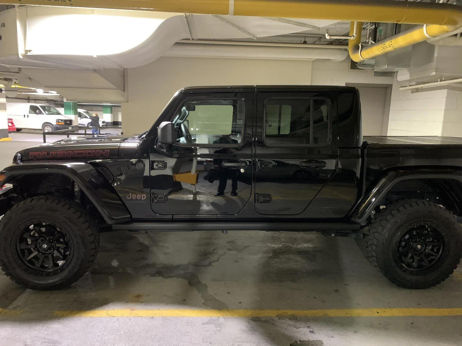

So, I waited patiently through all the hype. Bought the Mopar lift and the Teraflex 1.5 front leveling kit. Installed everything myself. The Mopar lift instructions are good but not very technical. The Teraflex instructions are legit.
after the install, I checked all torques, had the alignment done, headlights adjusted and double check on all the torques at a reputable Jeep dealer ($89.00).
first impressions are not that good. I have the Carolina Squat going on, but a nice bumper and winch will cure that.
I am still running stick wheels and tires. The front end seems very jerky and hoppy, even after a week and 600 miles.
please someone tell me that some quality 35” tires will calm this down?
