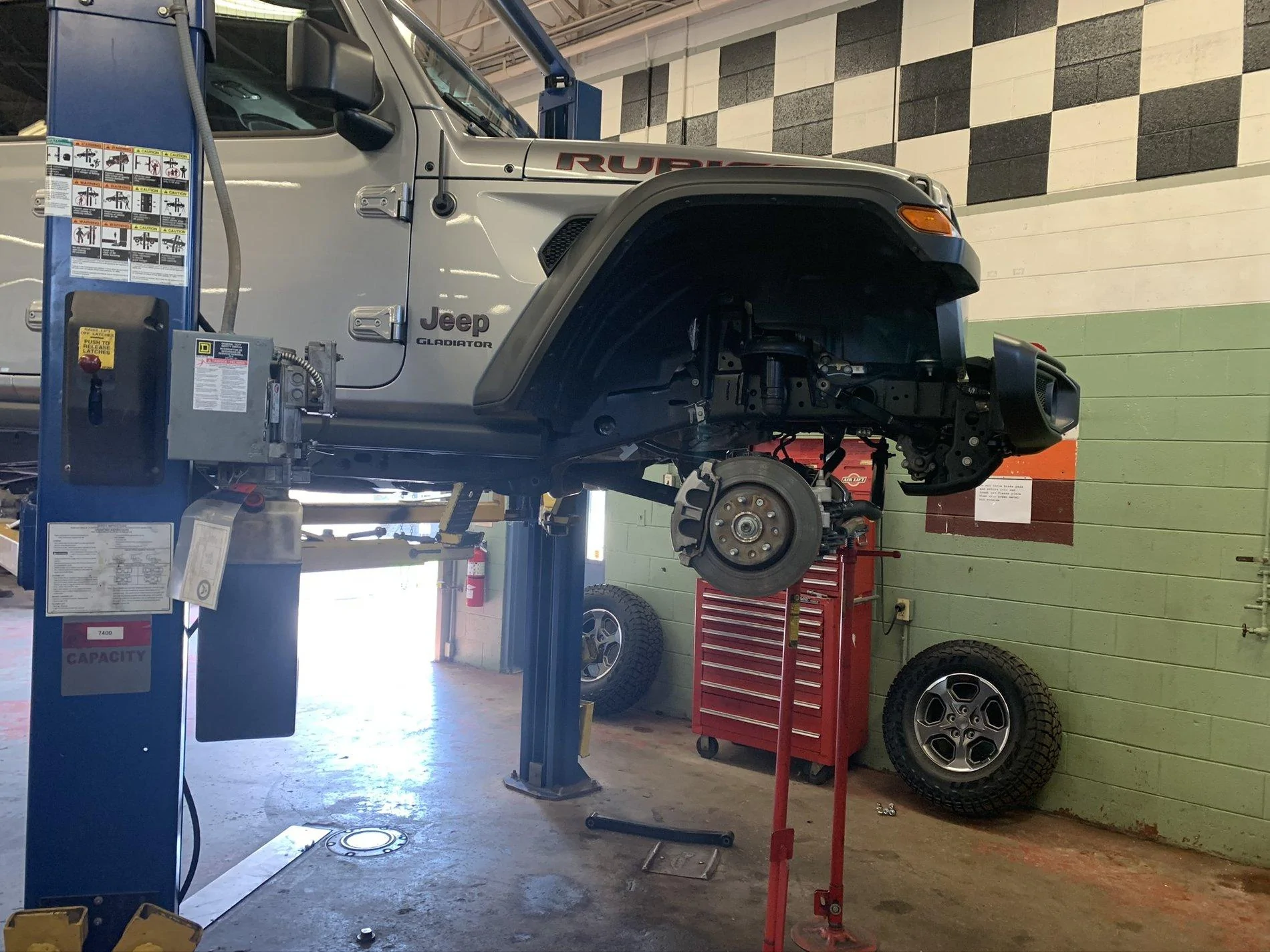

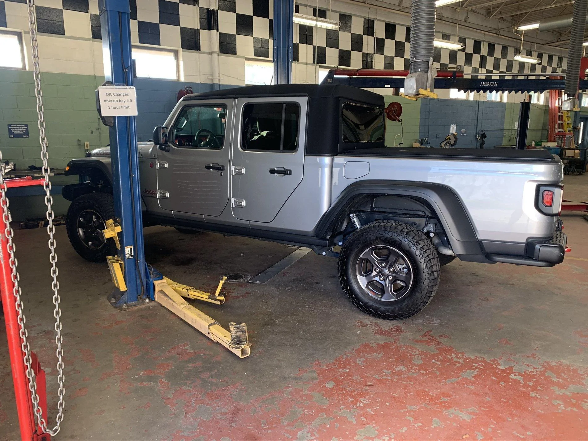

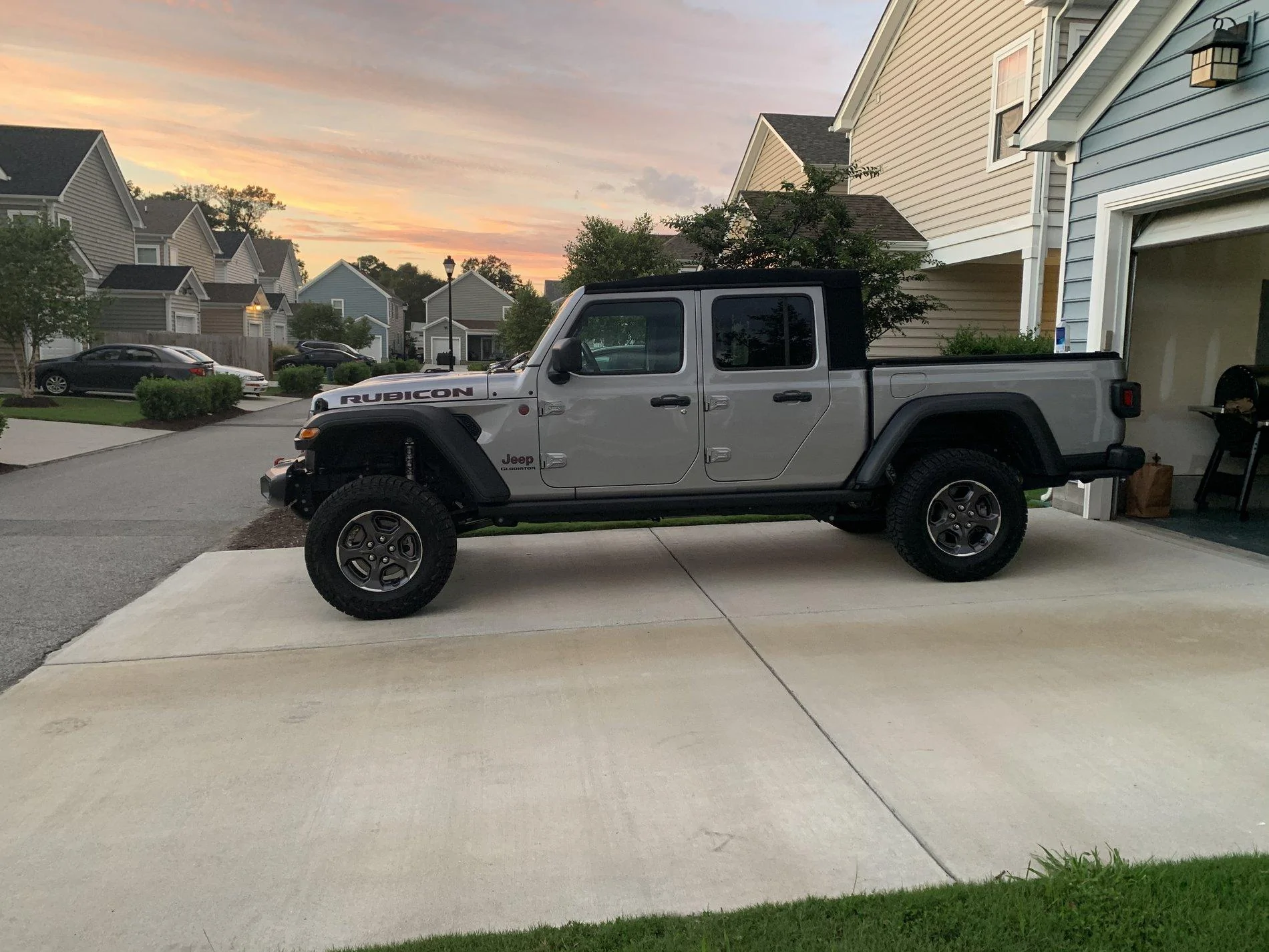

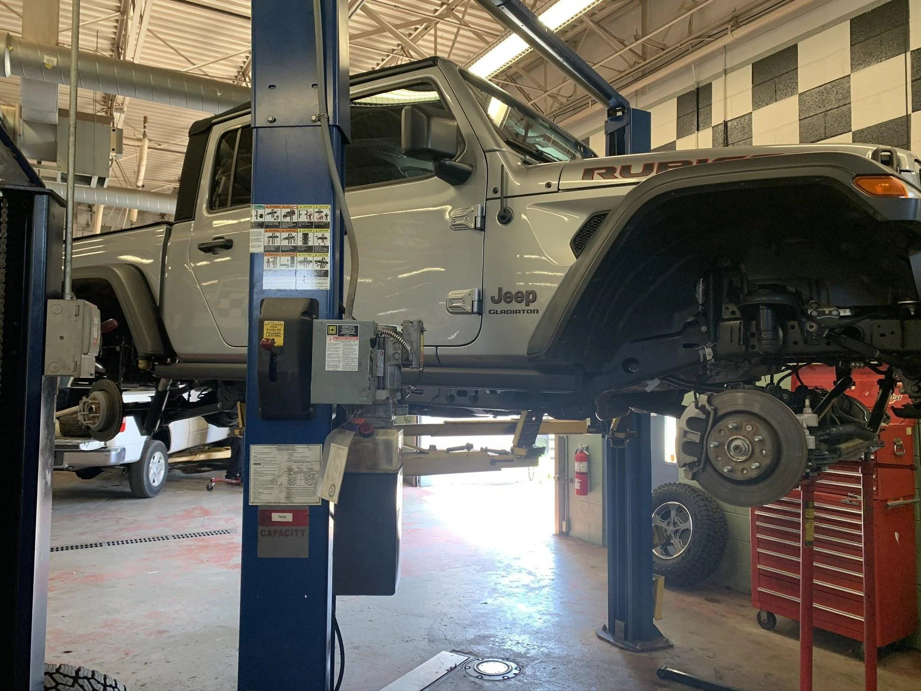

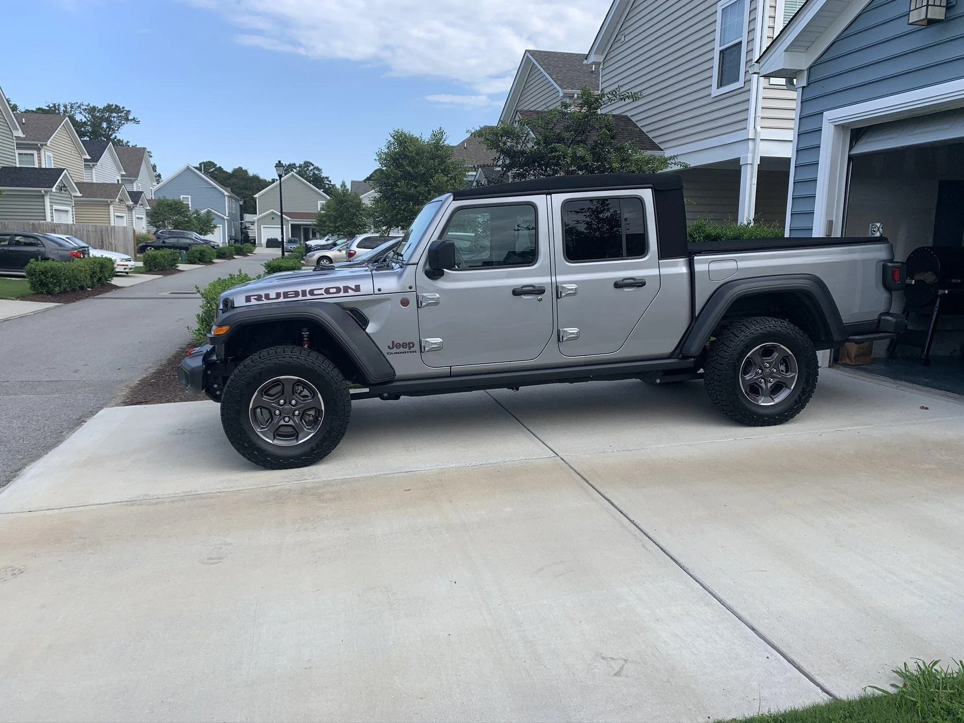

So, I waited patiently through all the hype. Bought the Mopar lift and the Teraflex 1.5 front leveling kit. Installed everything myself. The Mopar lift instructions are good but not very technical. The Teraflex instructions are legit.
after the install, I checked all torques, had the alignment done, headlights adjusted and double check on all the torques at a reputable Jeep dealer ($89.00).
first impressions are not that good. I have the Carolina Squat going on, but a nice bumper and winch will cure that.
I am still running stick wheels and tires. The front end seems very jerky and hoppy, even after a week and 600 miles.
please someone tell me that some quality 35” tires will calm this down?

Did you tighten and torque the control arms with the full weight of the vehicle on the ground?

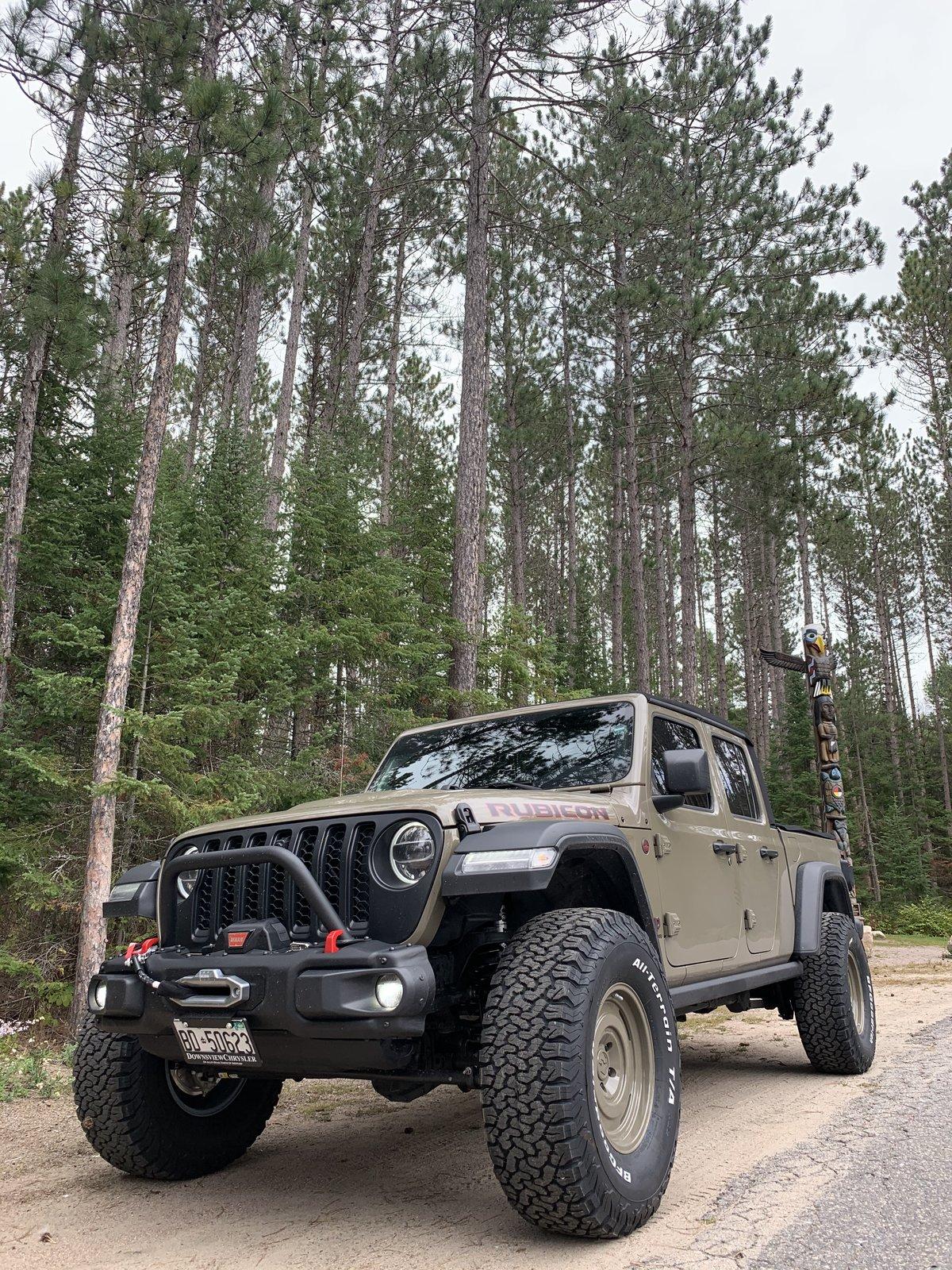

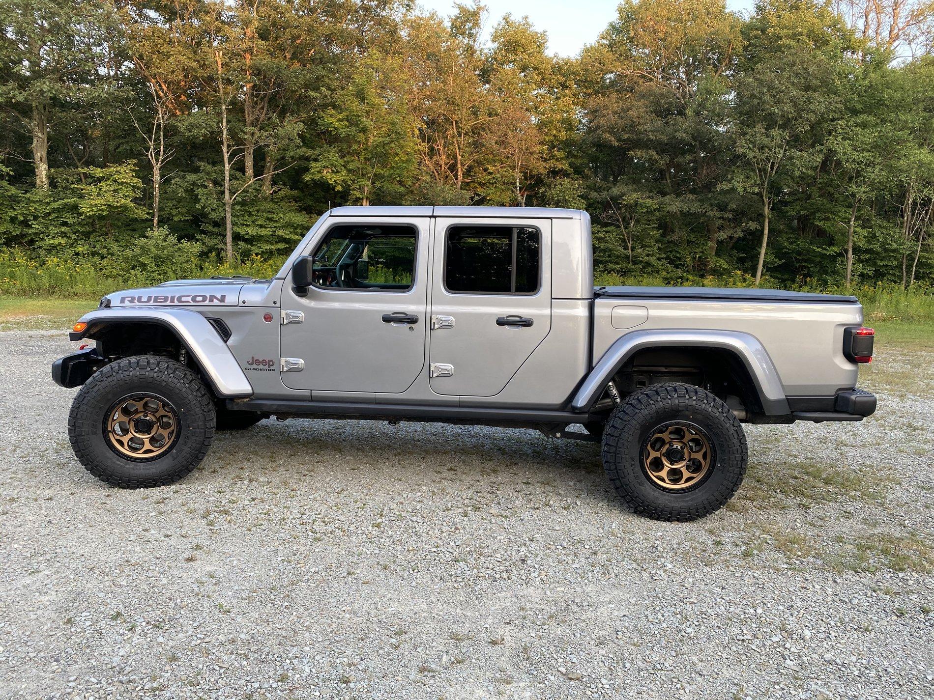

2” mopar, 35” Klever r/t’s, 17x8.5 KMC Dirty Harrys with O offset, the wheel lip itself sticks out 7/8” (test fit wheels before tires were mounted) as best as I could to keep the tires under the fenders without looking dumb. And yes, i loosened all the control arms as I was under the Jeep with an impact, makes quick work and does seem to help things loosen up and not be torqued/pull any one direction
Jeep Gladiator Gladiators on Mopar 2" Lift Kit 0E9CB571-D1CC-4D31-957A-9044C1087241
Looks good. I have the same wheels in a +18 offset.

So the squat thing is obviously the addition of the spacers, and the drivability likely is as well.
The longer control arms that come with the lift correct caster for that amount of lift.
If I'm remembering your OP correctly you added a 1.5" spacer, almost dounling the lift and increasing caster the same amount. To stop the wandering you are going to have to correct caster, meaning adjustable lower control arms or removing the spacers.
"Check the alignment" on a Jeep means set the toe, because there are no other adjustments to be made without aftermarket parts.

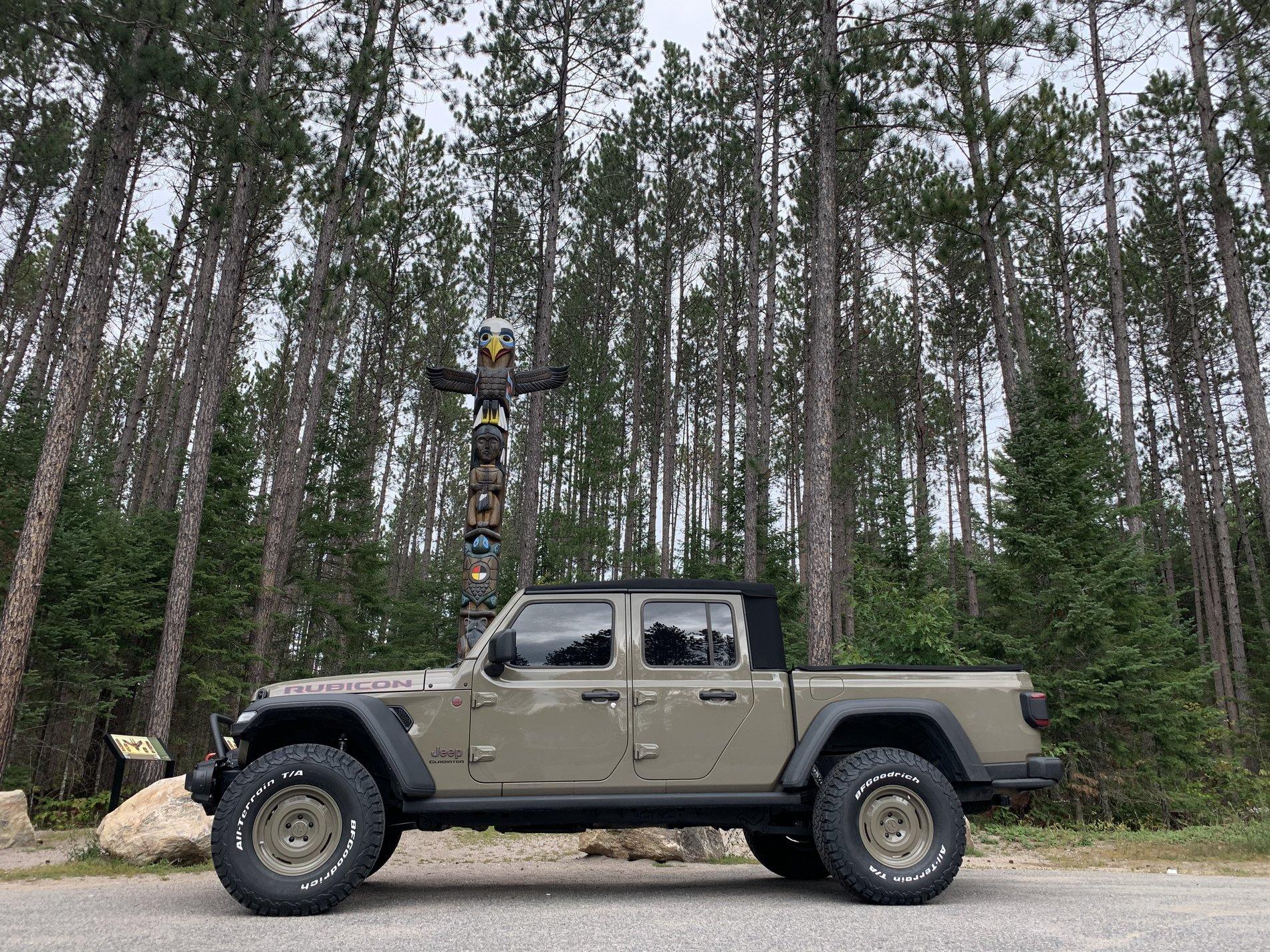

Mopar 2” lift, Falken 285/75/18 Wildpeak A/T tires. Total overall lift with tires is between 5.25 and 5.5 inches. 72 Inches total height to 77 and change. Hauled over 900 lbs of building mterials last night and not a bit of noticeable squat.... Yeh, those are 12 footers hanging out the bed!
