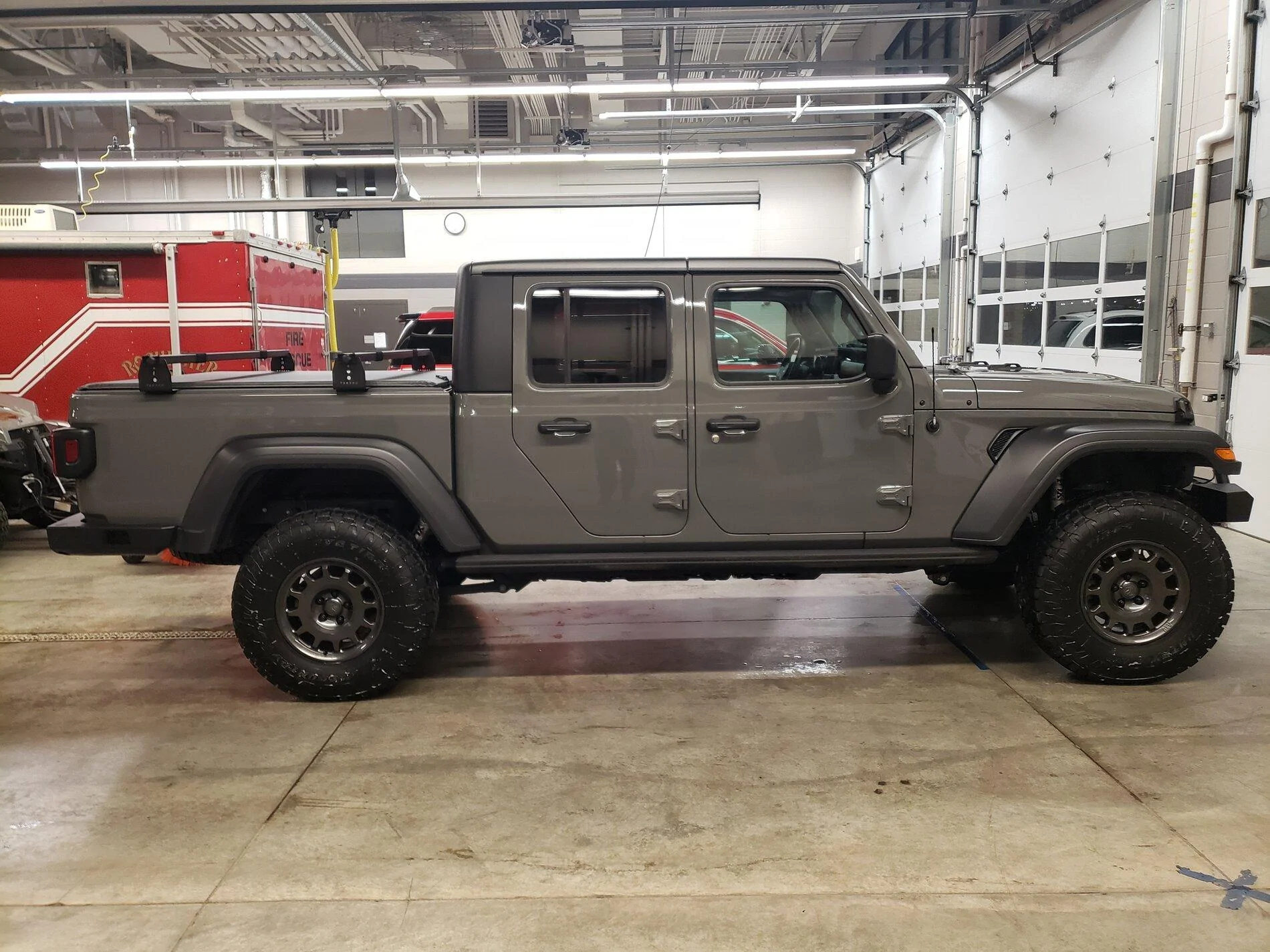

Here's the build breakdown for those asking:
2" MOPAR
1" teraflex spacer up front
Teraflex front adj trackbar
EVO rear adj trackbar
AEV geo correction brackets
Rockjock carrier bearing spacer
35/11.5r17 toyo atIII
AEV salta xr wheels
35/10.5r17 spare on stock spare steelie to tuck up outa the way
Plus a cleaned up shot at night:
