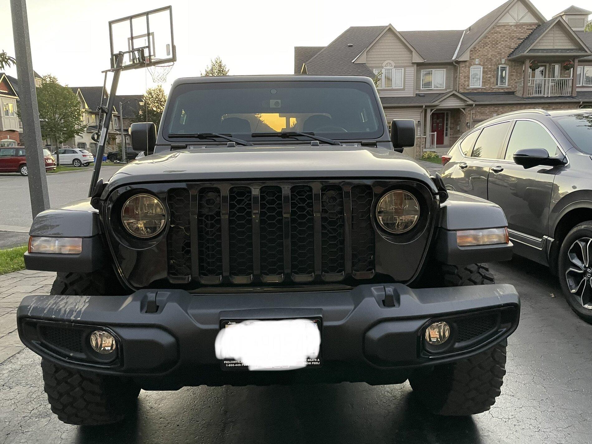

When I replaced my factory lights, I initially tried replacing the bulbs with LEDs. Didn't work. A) no high beam and, B) the Jeep 'grill looking like diffuser thingy' they put inside the assembly really negated any extra beaming of the light from the LED. Did the same in the fog lights, but that was a complete success!!!
Again, go back to my earlier post and check out those lights from Amazon. Cheaper at $185 than the $500-600 or more, Oracles and are a direct mount to the factory mounting points. Basically, no muss, no fuss.
The hot wire for the angel eyes is such a simple hook up. Get a dual fuse adapter and use the J52 fuse (it's a switched circuit) to power them. Easy peazy.
Again, here they are.

I prefer the plug and play options like Oracle. For the Amazon ones, do you just run a hot wire to the batter like an old school stereo setup or do you have to cut into the harness?
The Amazon are plug and play, unless you want the Halo's. Then you run a hot wire to the battery.
