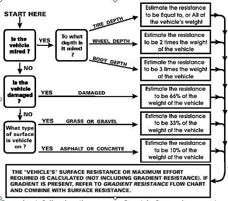

and surface resistance
ALOT of good info. Thanks! I wont hold it against you that your a Navy man. I hear 1400 sailors go out and 700 couples come back............Go Army Hooah!
