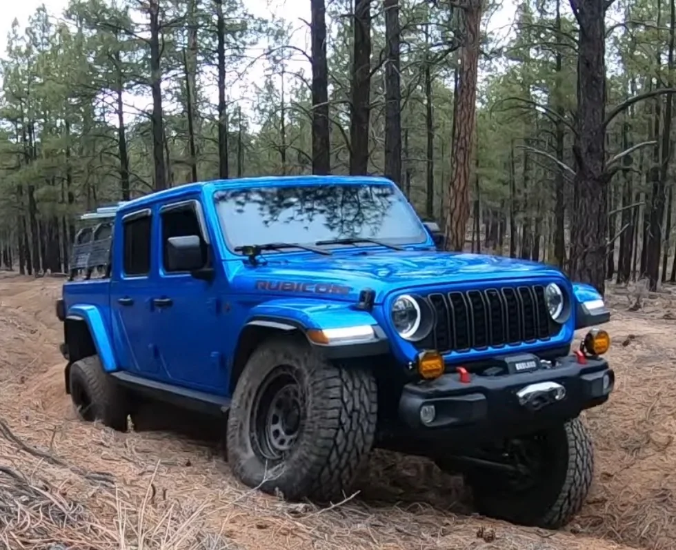

I have a '25 Rubicon Gladiator.
I went with with the Metal Cloak 2.5" GC lift with the basic Red shocks.
I'm running Atturo 315/70/R17 Trail Blade AT tires.
This combination has worked VERY well. The tires provide a smooth ride where ever I go and plenty of traction when aired down. The MC lift provides plenty of lift for 35" tires, and is actually designed for the 37" tires, should you go that route.
I've run Moab Rim, Hells Revenge, Kane's Creek, Poison Spider, Golden Spike and Gold Bar Rim. This lift walked it all with no issues. It provides incredible flexibility, while ensuring your rig stays straight on the trails, and off the trails. The best part of this kit is the upper and lower control arms are adjustable so you can dial in your Caster angle, ensuring your don't get the Death Wobble. I've put almost 10k miles on my lift, all with no hint of Death Wobble.
One thing I will caution you on; The MC 2.5" lift flexes soo much, you REALLY should get a replacement front drive shaft, typically provided by Metal Cloak. I went this route, and I've had absolutely NO issues at all with the lift or Metal Cloak drive shaft. The one thing I really like about this kit is that it's already tested out, and a complete kit (aside from the front drive shaft).

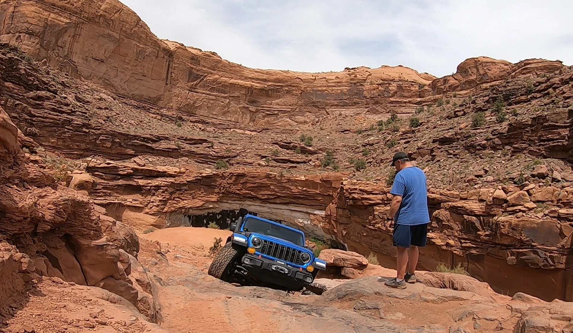

Kane Creek coming up Hamburger Hill
Jeep Gladiator HELP Lift kit Kane_Creek_HamburgerHill

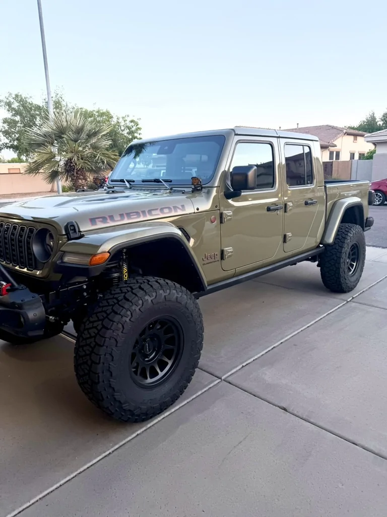

I had a 21 Gladiator Rubicon and I started with a Mopar lift/35's.. I thought it was great until I upgraded to a MetalCloak 2.5". I ran 37's at that point. I thought it was perfect as a daily and off-road occasionally on Medium to Hard trails in AZ. I sold it in 2023 and just bought a 25 Rubicon Gladiator.. I've gone to the 3" Rock Crawler w/4-link rear plus ADS 2.5 Mesa shocks and Toyo 37's. This is it! As a daily driver, it is amazing and the off road abilities are crazy good.. I only have 3000 miles so far, however; I am super impressed. It is a bit more $ than the MetalCloak but so far I think it's worth it. It does seem in AZ the popular choice is MC, I wanted to try something different. I was originally going with Clayton until I heard/researched the 4-link rear which sold me. Articulation is awesome! Long story short, I highly recommend you consider Rock Krawler.
Jeep Gladiator HELP Lift kit AAB52C66-5C2A-4FD8-82EE-C02E8AF079A0_1_105_c
