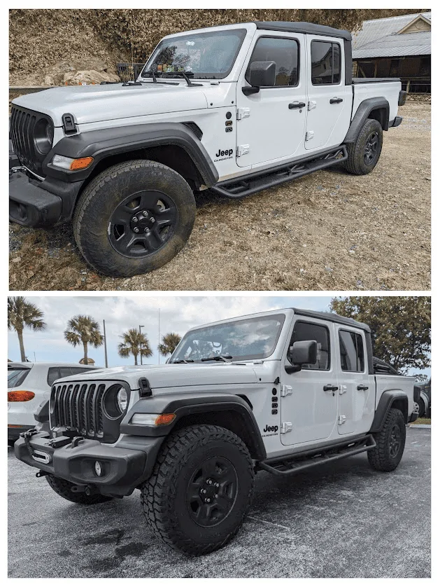

I pondered this same question recently as I was upsizing the tires. While the Gladiator is very capable for most of the trails I run, I was longing for taller boots. Did a lot of research to select the tires, rims, and suspension. My top two tire choices where BFG All-terrain T/A K03 285/75R-17 (33.8") and Mickey Thompson Baja Boss A/T 255/75R-17 (34.6"). I decided to stick with the original rims and gearing on the taller tires to 'see how it goes', leaving open the option to regear if it is 'bad'.
Spoiler: it is not bad.
Drivetrain: 3.6L V6 (gas), 8-speed 850RE automatic transmission, 3.73:1 gearing
Before: Bridgestone Dueler A/T 245/75R-17, 31.5 inches diameter
After: Mickey Thompson Baja Boss A/T 255/85R-17, 34.6 inches diameter, 1.5 inch Teraflex leveler.
I am only a week into the new set up, but I can attest that normal on-road driving is negligibly impacted. Initial fuel economy seems unaffected. Note that I did immediately recalibrate the tire size using a Tazer, so the speedometer and MPG should be right (and I have verified the corrected velocity with a GPS). I am sure that aggressive and maximum acceleration (and braking) are negatively impacted - that is just physics. But, day-to-day driving is more than acceptable (so far).
I can update this post later, after a month of on-road and some off-road adventures. As for off-road, I might need to use 4L once in a while where 4H will do, but that is a small penalty. Future towing is limited to about 1,500 lbs., so that is not a concern either. As this point, I feel no urge to regear. :)
As has been said here, ultimately, you will be the judge.

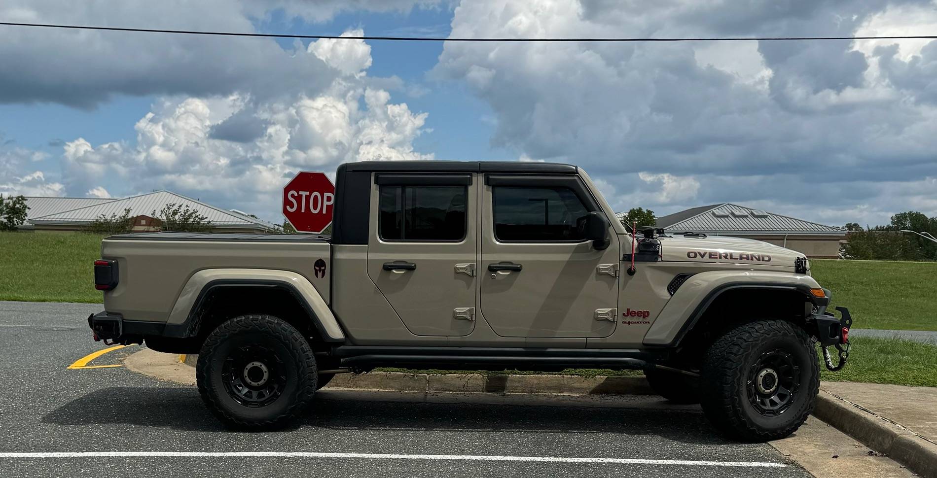

One drive from South San Francisco up to Roseville, CA was enough to get 4.88s a week later.
Idk how Yall are running 4.88s on 35s
Even 4.56s on 37s is slightly more gearing than the JT has stock for a sport
Jeep Gladiator Here we go again - 3.73 with 35s - how bad is it really? Screenshot_20240820-211043~2
(31s/3.73s on left 37s/4.56 right)
Unsprung weights/mass.
Did my due diligence and went with this.
35" x 3.75 ≈ 4.23
31"
In my case I'm overgeared with 4.88s ON PAPER. But on the road behind the wheel using my butt dyno, it feels like stock performance.
rotating corner weight is usually the main reason people go deeper than what generally makes sense. if your turning over 100-110 ish lbs a corner, I've seen many go deep even for true to size 33s
