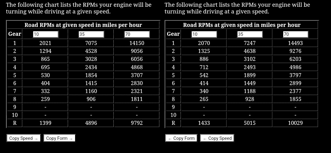

Idk how Yall are running 4.88s on 35s
Even 4.56s on 37s is slightly more gearing than the JT has stock for a sport
(31s/3.73s on left 37s/4.56 right)
That chart makes 4.88s seem like the obvious choice.
Personally I think the gas V6 is gutless and wants to live on the moon rpm wise just to not be that guy in traffic. That can be solved via the transmission tap dancing all over its ranges or you can do it in the diffs.
OP: find some bronco 35 take offs. They are light weight, junk offroad but look decent and shouldn’t be more than $600 for a set with low miles.
And start saving for gears

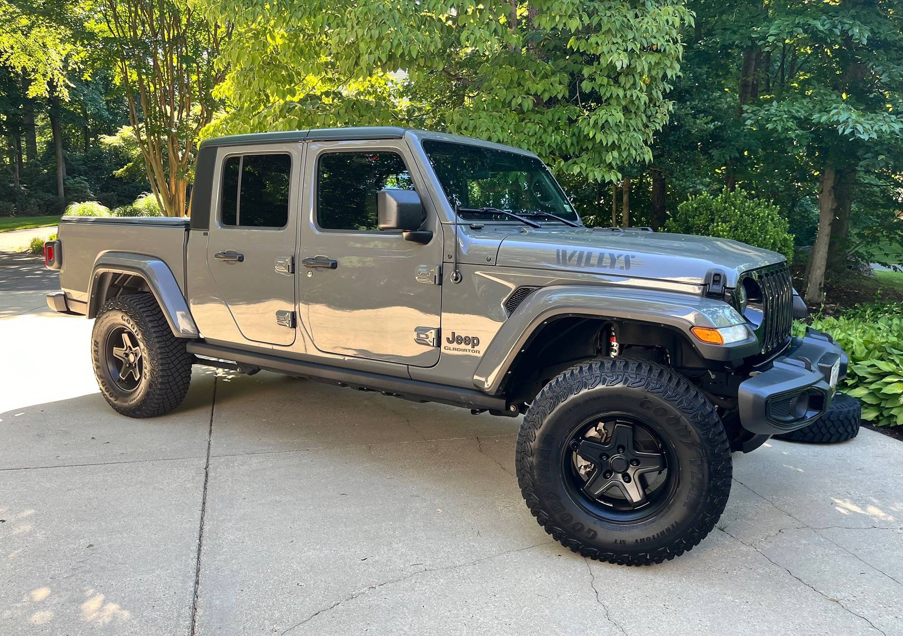

So a month later how are you feeling with the setup? Does it feel normal and just fine now?
It honestly does. Mind you I do live in a part of Florida which is pretty much flat minus bridges and overpasses. One of my previous JTs was a Rubicon with 4.10 gears and 35s and my current set up feels equally as good if not better. I think what has helped was choosing a lighter wheel + tire combo. Does it mean I will never re gear? No it doesn’t but there is no urgency.

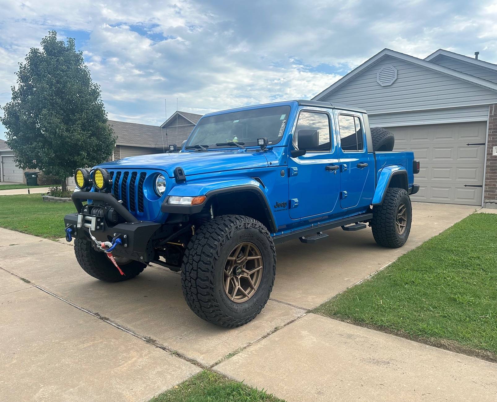

Recently put 35” Mickey Thompson ATs on my sport S with 3.73 gears and a 2.5” metalcloak lift. I see about 15.5mpg in Oklahoma. I swapped from 33” Patagonia ATr’s, I was only seeing 15.9mpg on those….
power is fine for me, will regear at some point but only to go to 37s. I would have went 37s on 3.73s but from what I understand I wouldn’t be able to pull my camper with it. Ultimately chose 35s.
Jeep Gladiator Here we go again - 3.73 with 35s - how bad is it really? IMG_5901
