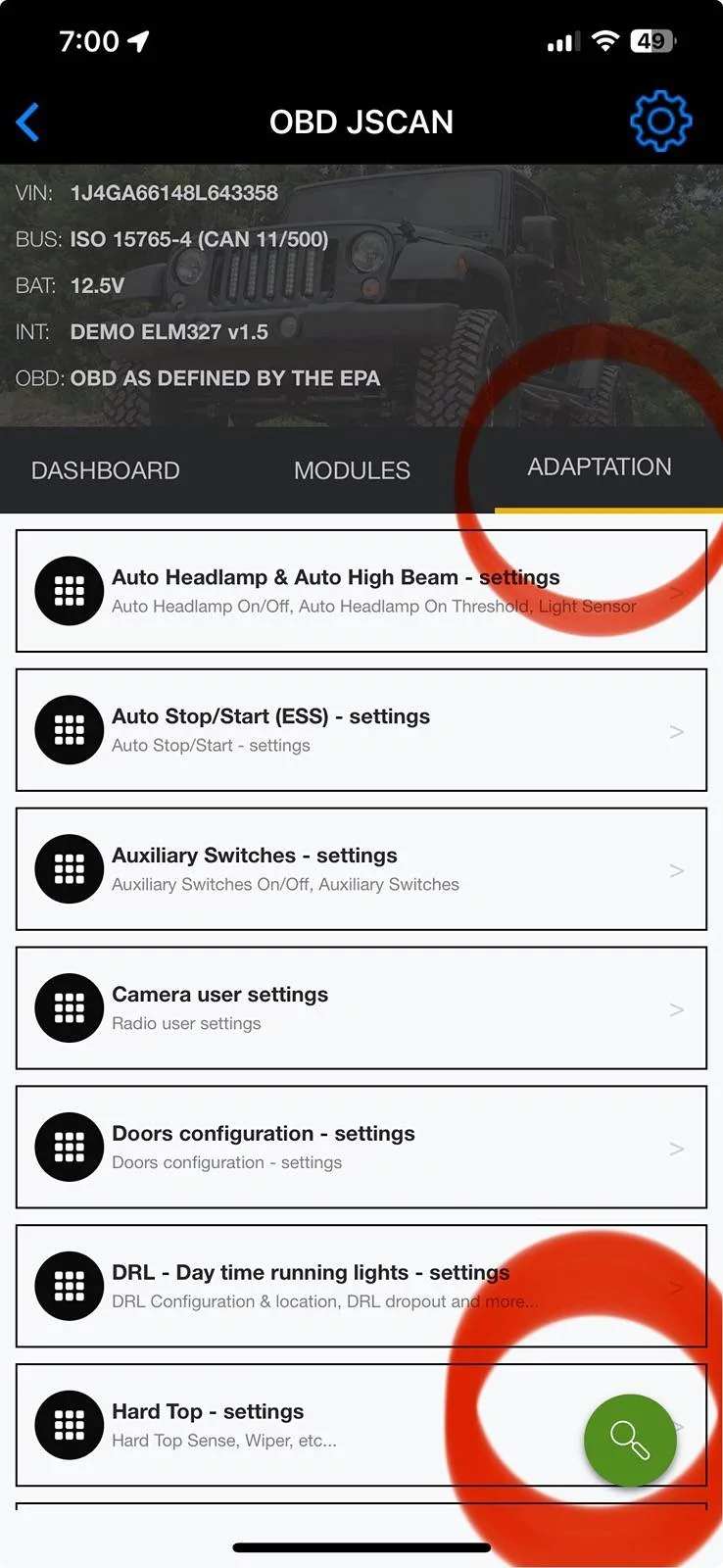

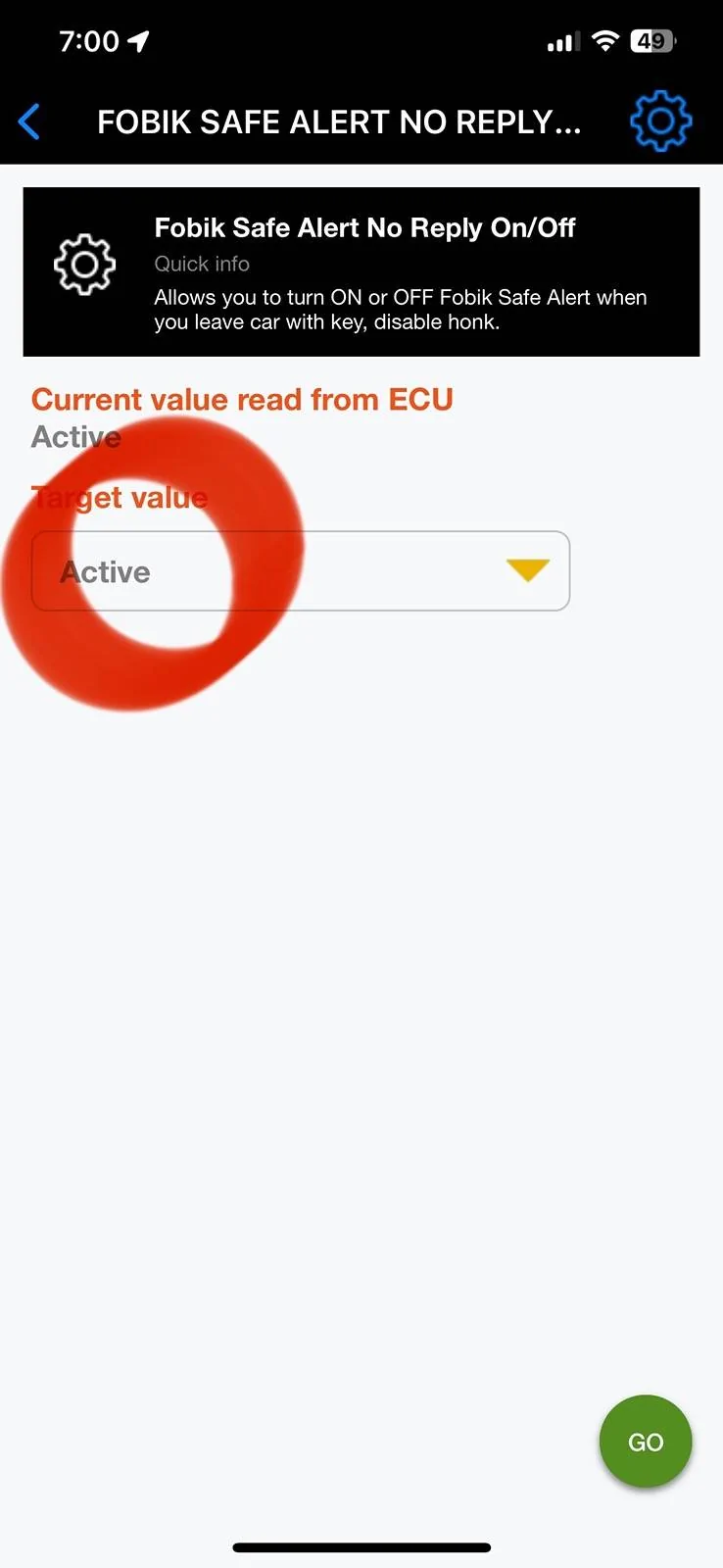

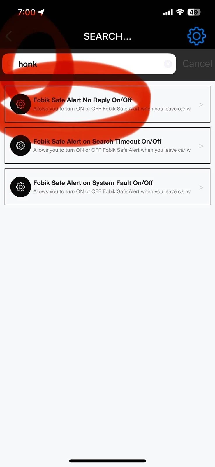

I tried that - did nothing about leaving it running, taking the fob with you and closing the door. I just never leave it running, no matter what, or if it's in my own driveway, I just don't close the door.
I found that setting in JSCAN a couple of years ago and tried it - didn't stop the 3 quick honks when taking the fob out of a running vehicle.
My 2020 never did that. My 2022 does.
I compared settings - they are identical for both vehicles, that setting was the same for the 2020 as the 2022, and yet the 20 never honked, the 22 does.
??‍♂ I can’t speak to all of the variations/years. This worked for our 22jtrd and 23 jtrd.
