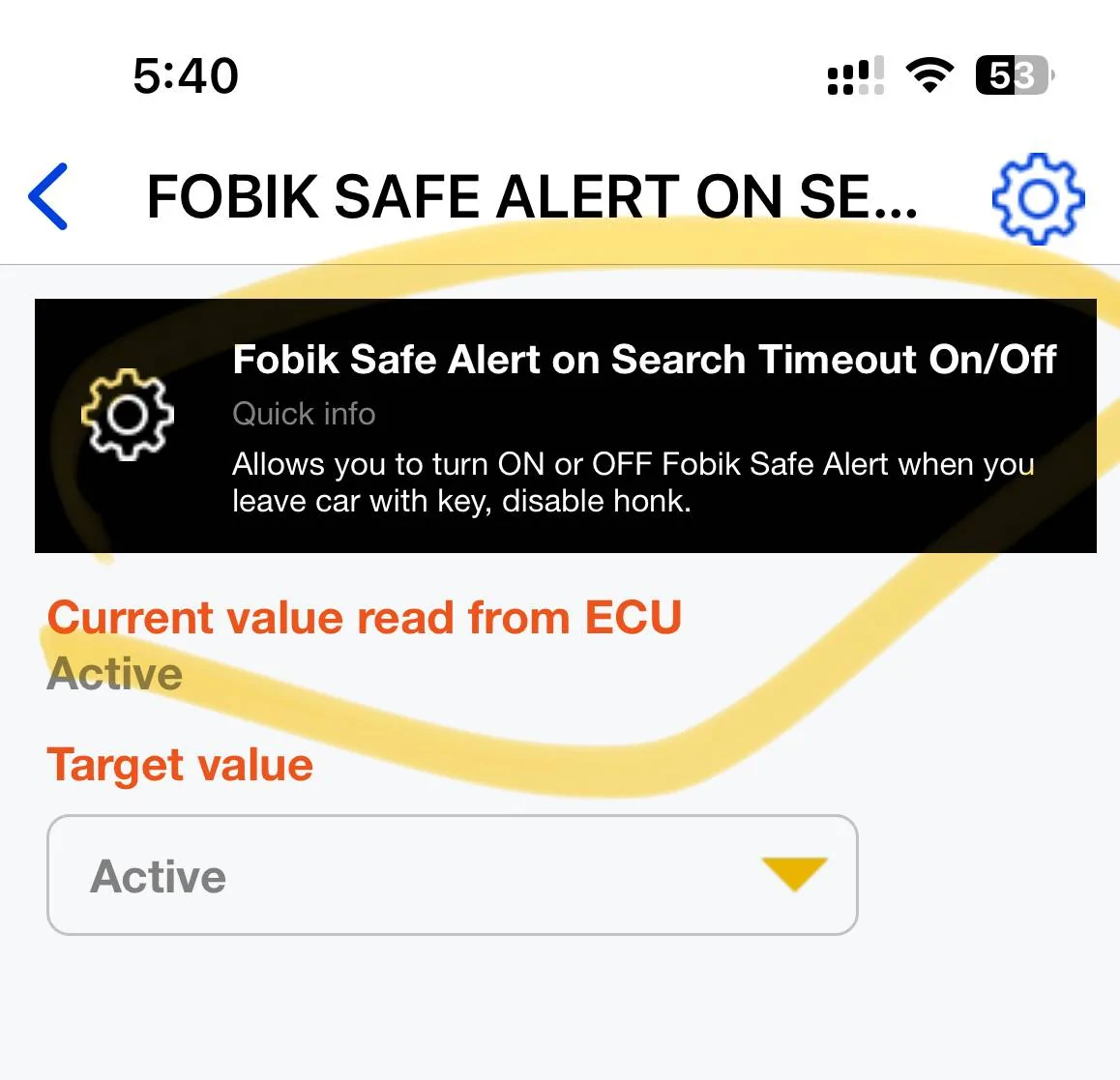

Quick update as I did not see anything posted about JSCAN, but I recently traded in my 2020 JT for a 2023 JT Mojave and now I have the horn issue. JSCAN does have a fix as well, FYI
Don't know if an update fixed that or not, but tried it on my 2022 and it didn't matter a bit. Still honked. Doesn't matter for me, I was just testing the functionality, I never leave the vehicle running and take the fob and close the door anyway.
Ya better try it before you say it will do it, because it sure didn't change my 2022. Don't know if it was a 2022 thing, or they needed a fix via update to actually make it work
Yup, you are right... it did not fix the issue. I will contact JSCAN
