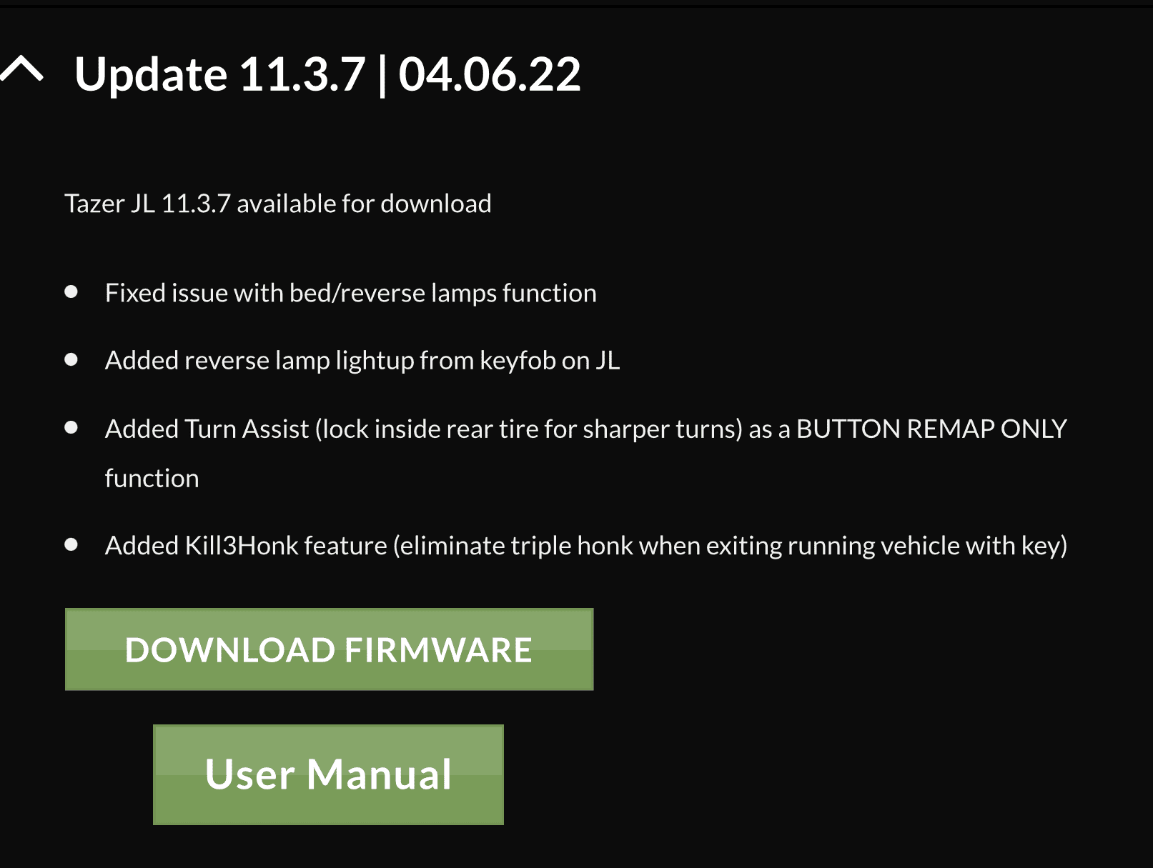

Tazer has come out with the solution.
The latest FW (or at least the one from 2 months ago), has an option to turn the triple beep off!!!
(One Caveat however, is that it only is turned off for the driver front door - the rears and passenger front will still cause a triple beep - hopefully they will fix this “feature” in a future release.)
edit - heres the release
Fantastic. I already had the Tazer and it was even updated, I just hadn't nosed around the Live settings yet and it wasn't in the copy of the User Manual I had.
Set, and it works. Happy. Would be nice to have the option with the other doors, but can't complain.

It's my understanding that the Live features, which this one falls under, only function with the Tazer plugged in.
OK so this is a live feature. Yeah, that's correct in my understanding of tazer (never having even seen one LOL) is that if it falls under live features, it's gotta be there.

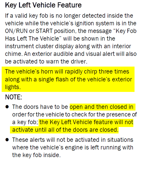

I've done some searching on forums, but I can't seem to find a definitive answer - is there a way to disable the honking when I step out of the vehicle with the keyfob in my pocket? It's really really really annoying.
UPDATE: based on the discussion, it appears that this is a functionality that was implemented in 2022 year models, in addition to the usual blinking lights. Manual, page 17 (thank you, @SURF&TURF ). According to dealers (so far) - it cannot be disabled. Aftermarket, you are our only hope (or, just don't close the door when you step out of the vehicle)

Tazer has the option to disable it.
For all the doors or just the driver? Picking up my kids after work I like to leave my truck running so the AC stays on and it’s super annoying having the 3 beeps go off over and over. Usually I pull my wad of keys out and leave it in the cup holder.
