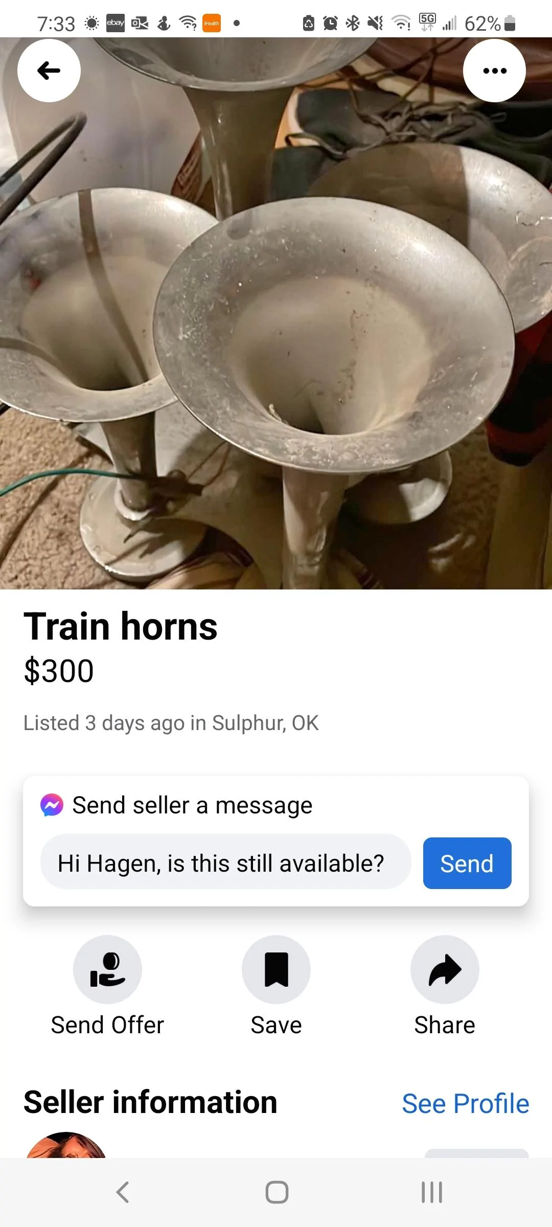

Can I clip one of the wires on the rear door? There are what power window and lock? Which wire or where is the sensor to trick the door into thinking its closed or taken off? Right now I just have the rear windows down, and unplugged the rear drivers side.
Kind of like doing the hood latches for ESS.
I can't wait on the Max Horn Tow package. ? I guess I could just do the mod for now, these just came across FB marketplace..
Jeep Gladiator Disable honking when stepping out while engine is running Screenshot_20220515-193306_Facebook
