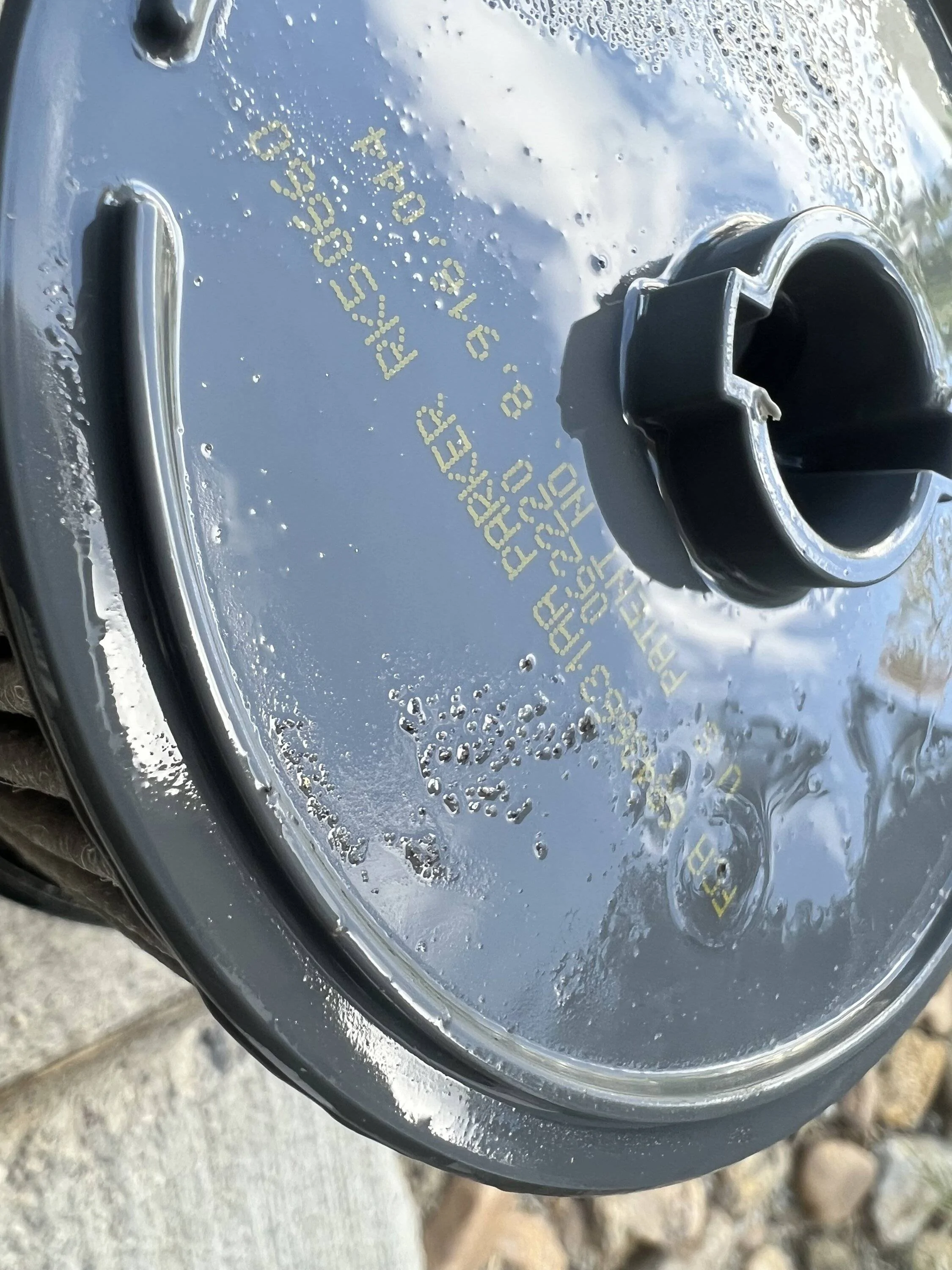

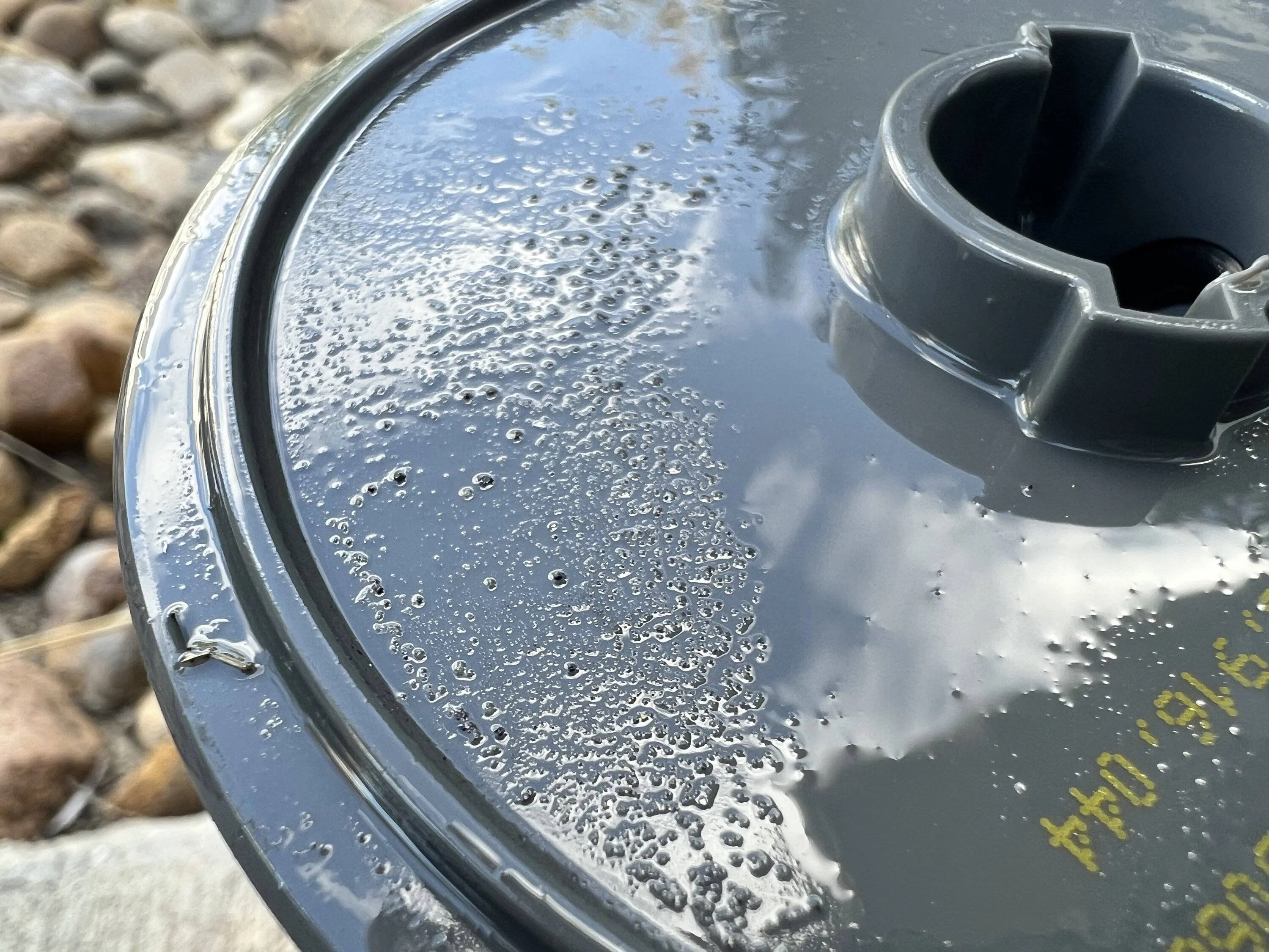

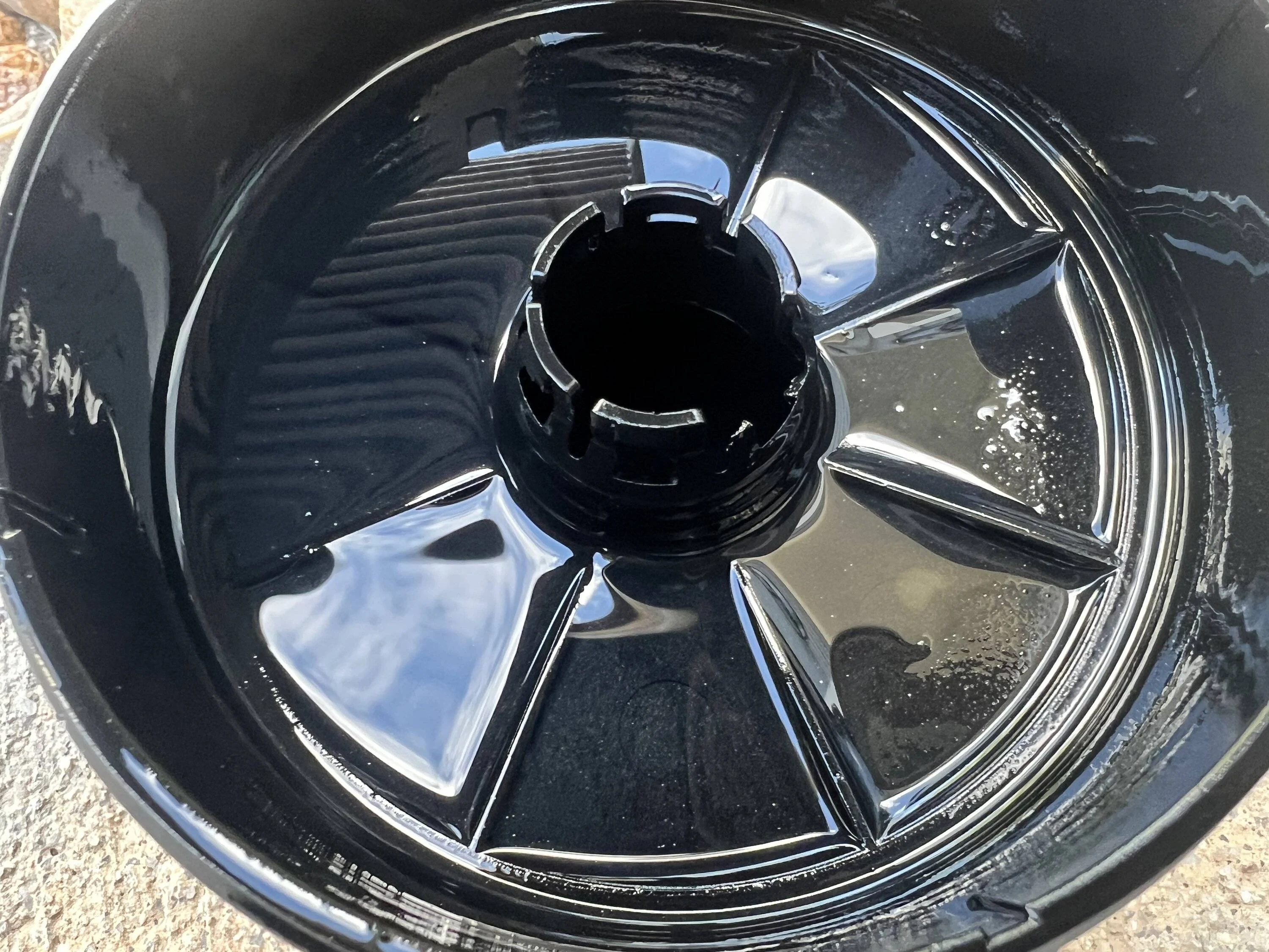

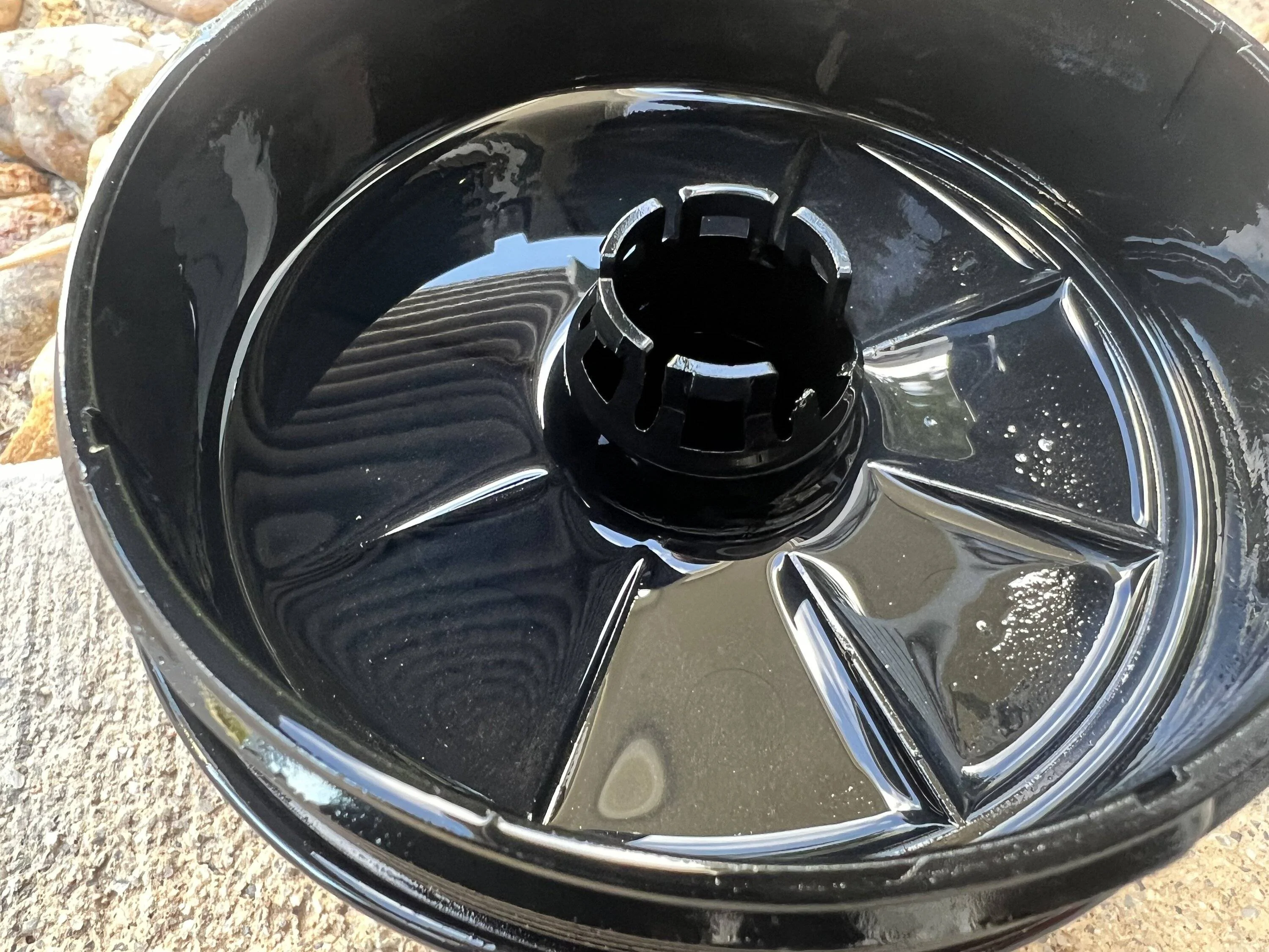

Metal found in the fuel filter assembly…
33.5k miles
EDT or LX4 every tank 2-4oz since 2k miles….
Should I just get rid of the vehicle? I do rely on it……
