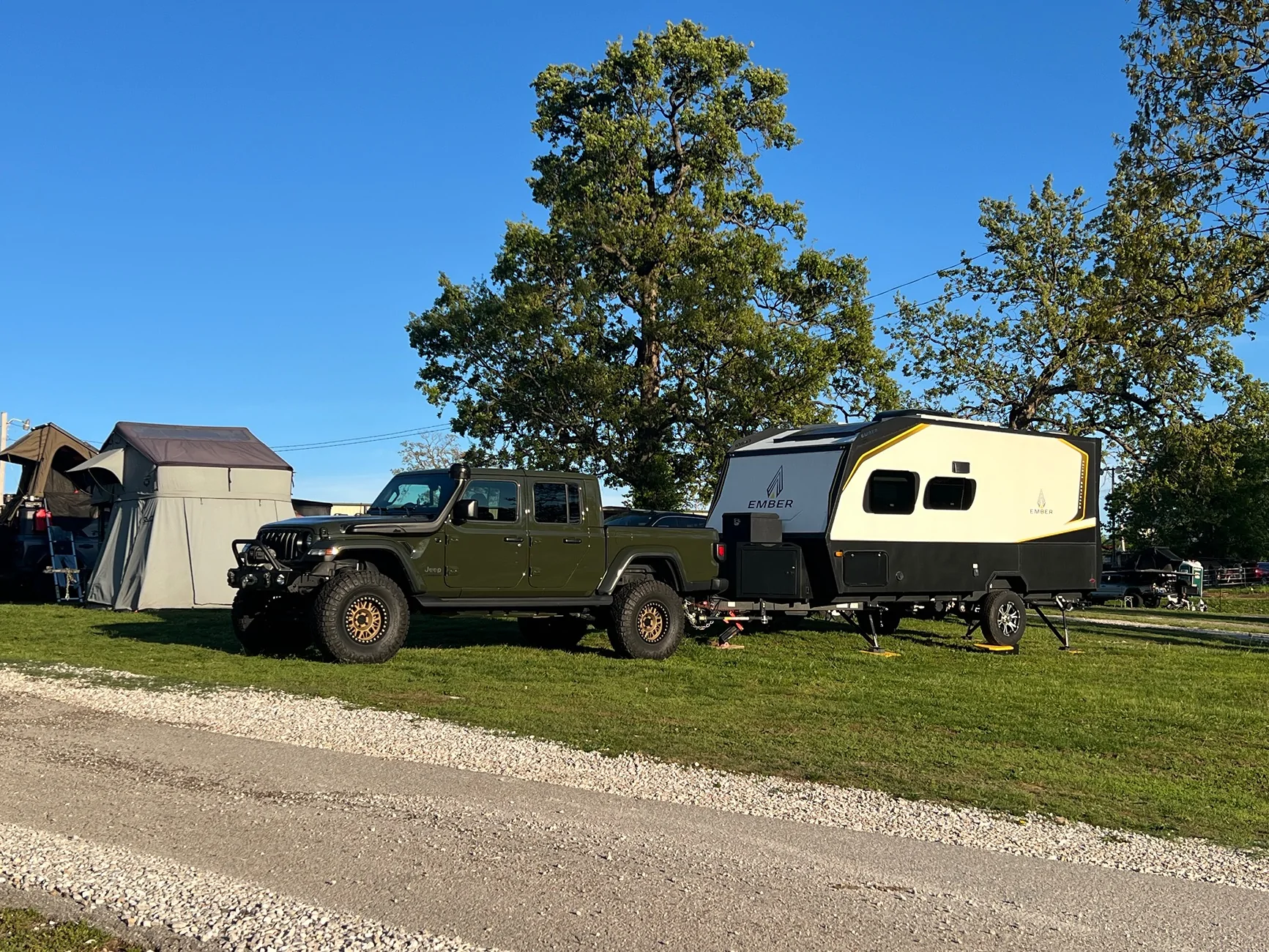

5200 ish total, I have csf rad, insane diesel oil cooler add on , running 4.88s on 37s. Windy day and up and down hills/mountains it will get hot. You’ll have to slow down
Thanks. I've read several of your posts in the long cooling thread. I have the CSF rad and the Mishimoto trans oil cooler in my garage ready to install. Also the Zerex yellow coolant and a 2024 grill.
4.88's is pretty low for 37's no? I'm planning on 4.56.
A bit worried since my camper would be 1k heavier. Tough decision.

I could have just changed, had a bearing go bad after 40k on my gear install so I decided just to put a new spicer set in. I’ll finish Friday. I’m fine with them but questioned my decision a lot at first. You’ll be fine with 4.56s. I towed through Denver and right up the mountain with not much problems at all. I can tell when a code will throw, if you start hearing the turbo sing and really work back out of it. Also down shifting and letting it rev will lower egts. High egts really cause all of the temps to soar. Never a code or a problem while not towing. My truck is 6000lbs dry. I don’t know if you have much of a lift but look into timbrens for the rear. I’ve had them and bags and I like them better. Only downside is less up travel in the suspension so if you hard wheeling you might need to remove em (one bolt/nut) before hand
Thanks for the feedback. I have a complete Teraflex Alpine RT lift (2.5" front, 3.5" rear with heavy duty rear springs and Air Lift 1000 HD bags). I also have the Falcon SP2 3.3 diesel shocks. And I'm thinking of adding the Teraflex Forged S/T rear swaybar.

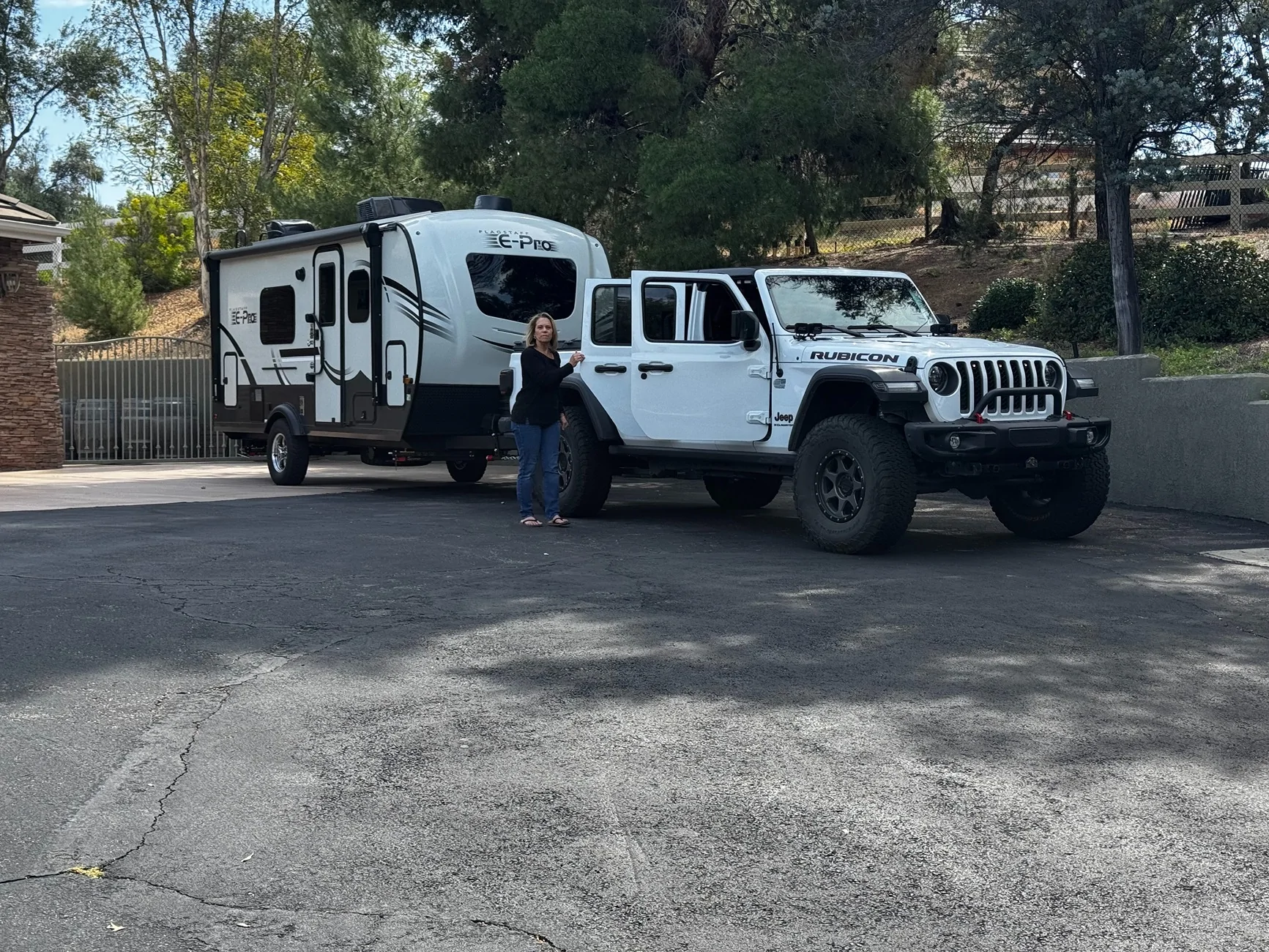

Same year truck and late last year switched from RTT to ePro trailer (19FDS), about 3600 dry, and another 600+ wet and with gear. No issues with heat or towing power. Weight distribution hitch was a must for me with ebikes on the trailer.
Should have also said I added a brake controller as well.

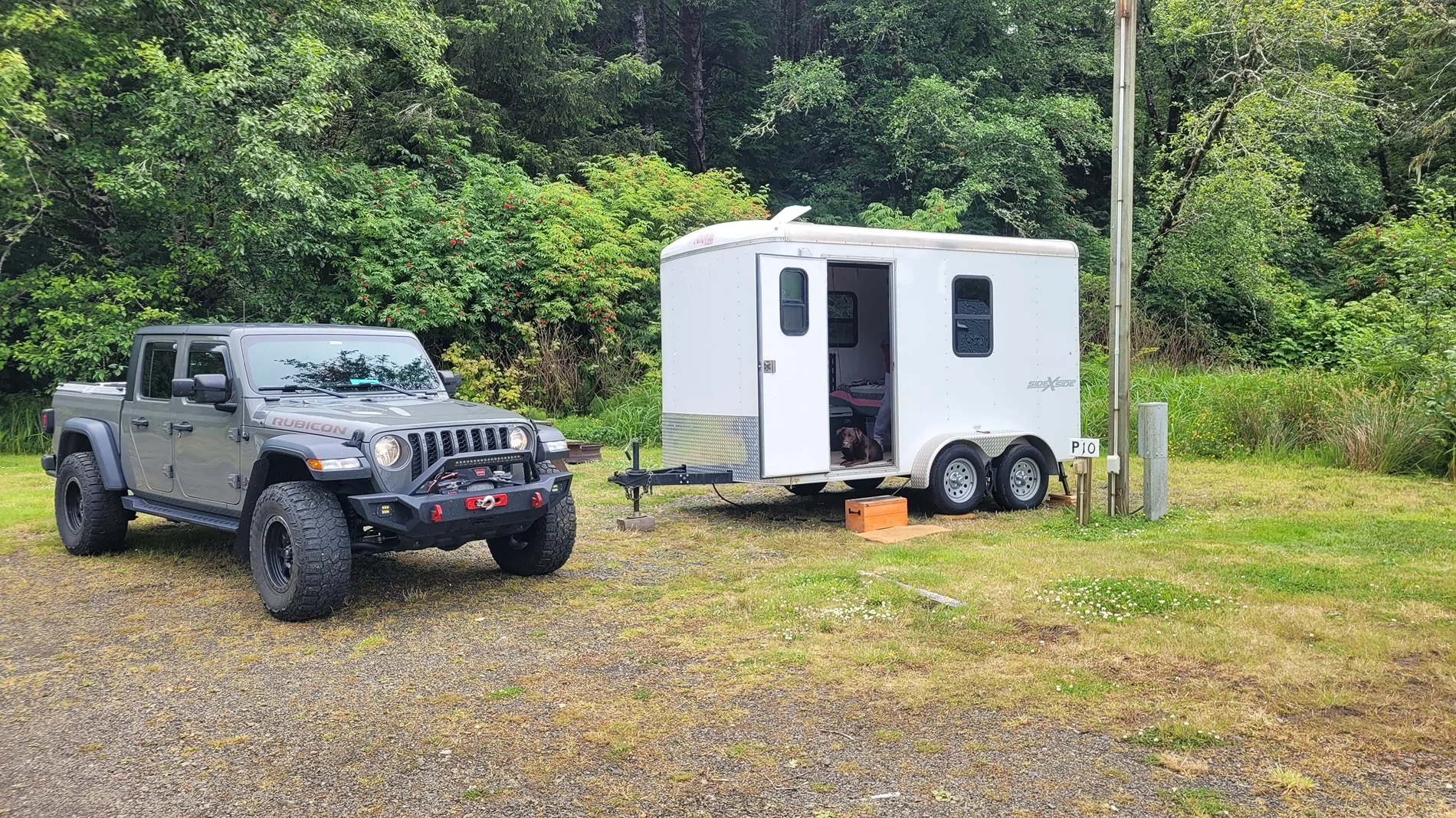

My current setup is a 7x12 plus height dual axle enclosed trailer I've added shelf and a lift bed to. Probably 4500 when loaded with our SxS and stuff for a week.
Jeep Gladiator How much weight have you towed with your Diesel Gladiator? 20260628_150501
Just camping out of it this week.
