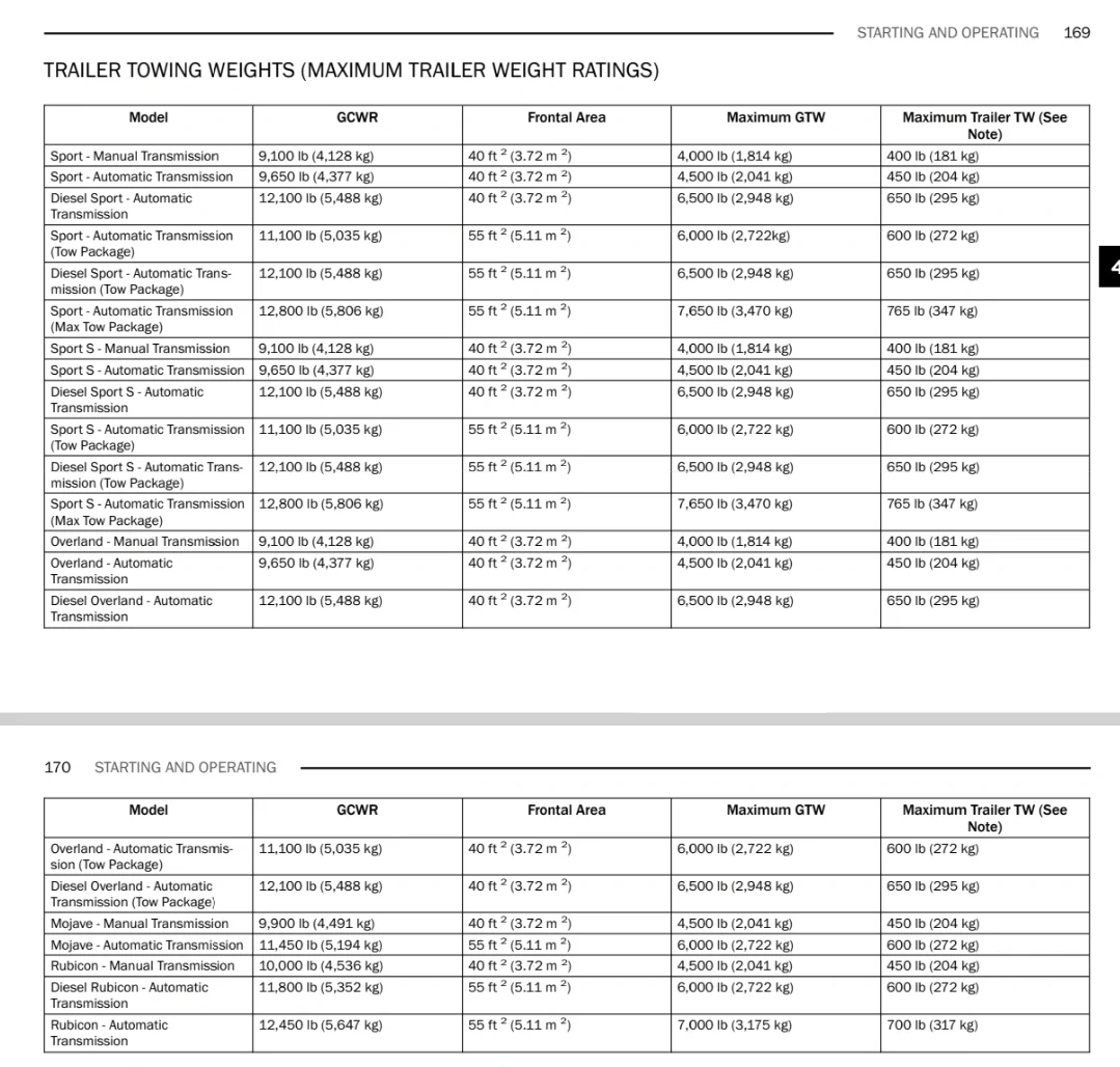

Dry weight is part of it. The other is wind drag. Our Arctic Fox 22G is a widebody (8'6" wide) which puts tremendous drag on the Ram EcoDiesel (96 square feet). So, that's something else we need to pay attention to when selecting a camper for the Jeep.
Does anyone know what the frontal area restriction is for the Jeep Gladiator? According to AI, "Yes, the Jeep Gladiator does have a frontal area restriction for any towed camper or trailer. According to the vehicle's documentation, this limit is specifically set at 40 to 55 square feet, depending on your specific trim and factory towing package."
Here is what my 22JTRD owner manual says about frontal area.
Jeep Gladiator How much weight have you towed with your Diesel Gladiator? Screenshot_20260702_221007_J
