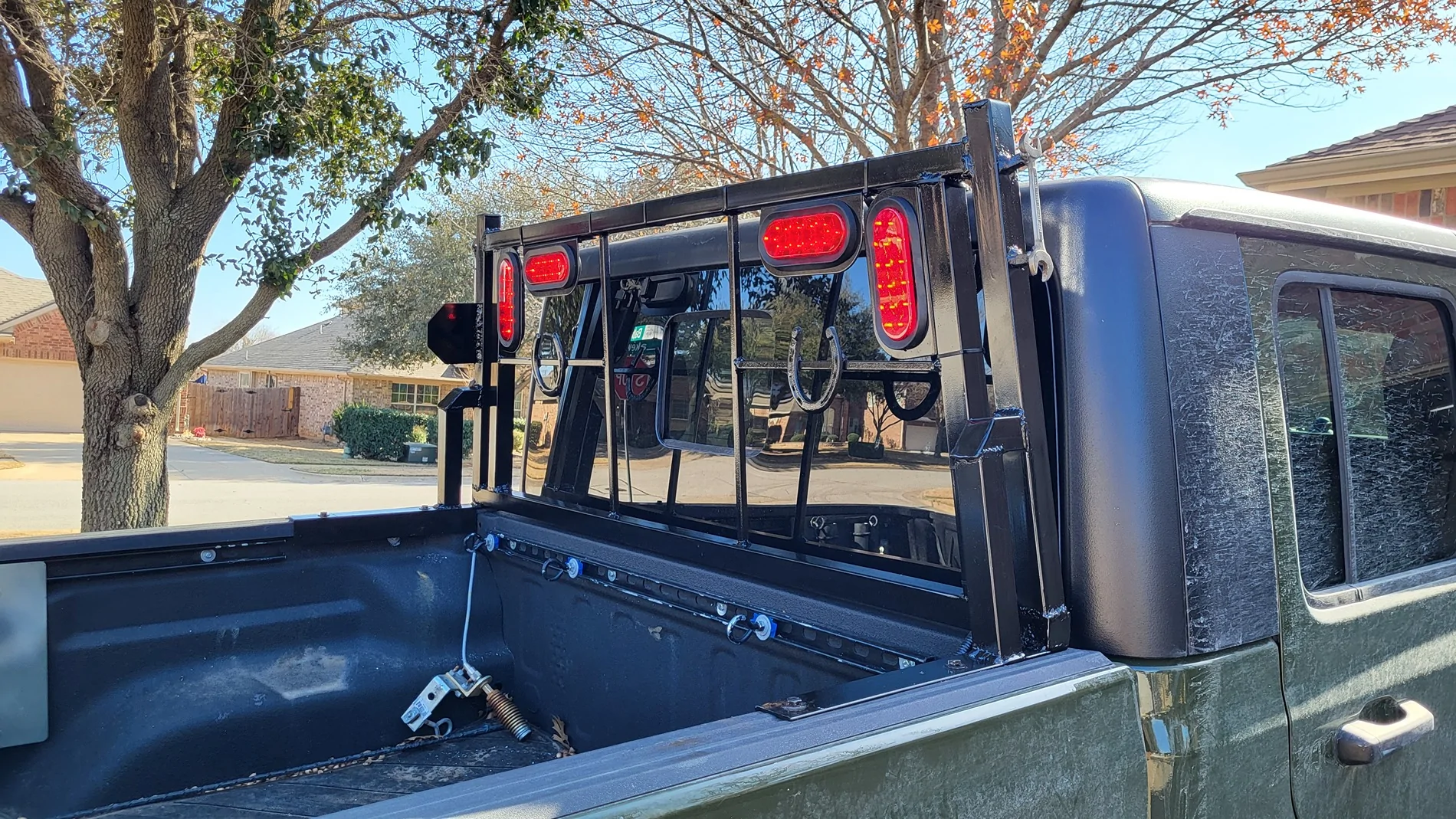

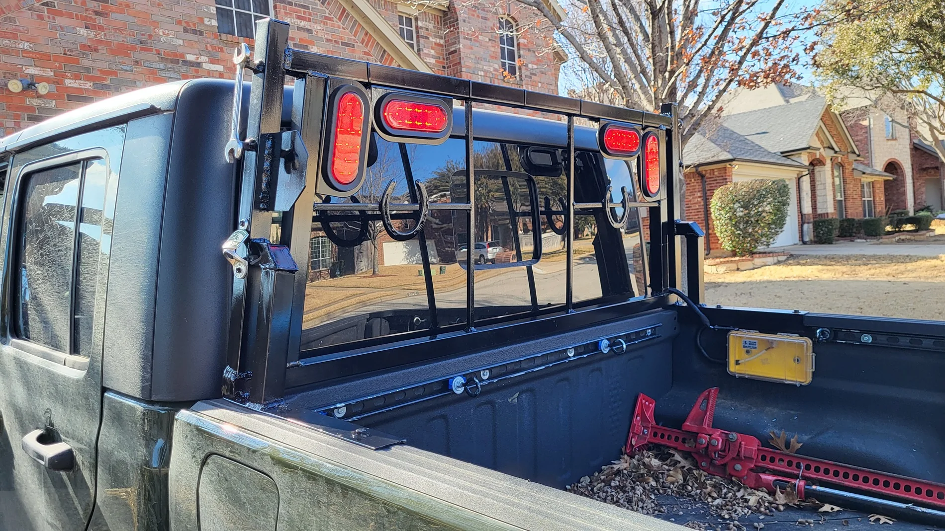

Howdy all,
Ive been missing a headache rack since getting my diesel gladiator.
I didn't find anything out there that was what I wanted. I needed something that would let me strap long boards and metal into the 5 foot bed and would not rest on the cab.
So, I decided to build my own.
My welds arnt professional quality, but I've been a hobby welder for years.
Metal cost was abt $70, lights, wire,paint,ect were abt $70, labor was my own.

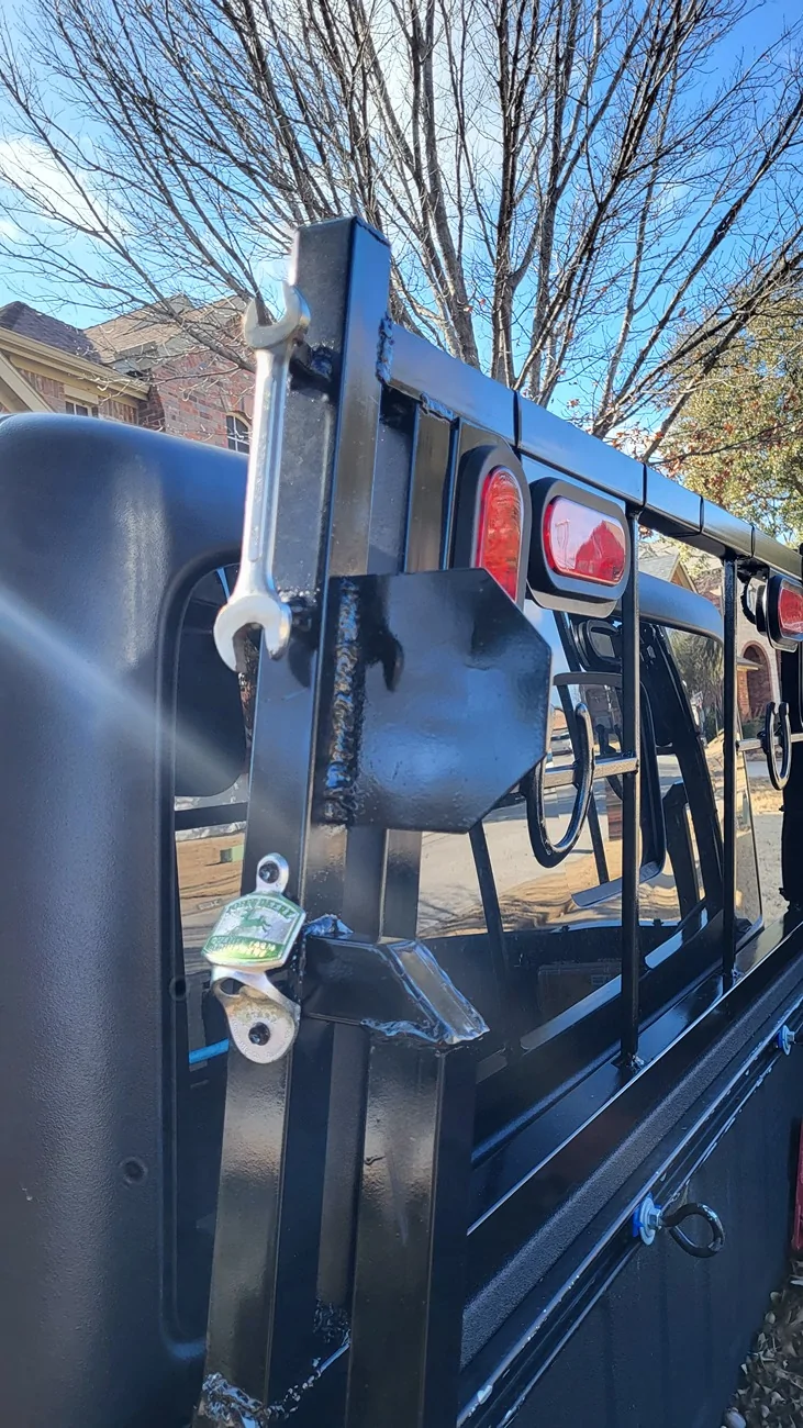

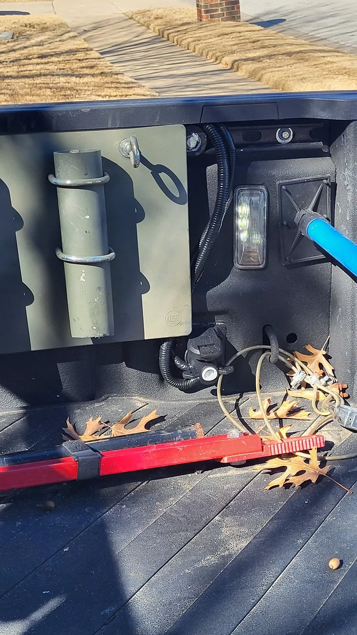

Custom touches I am happy with:
Old wrenches added as handles to help get in/out of the bed.
John Deere bottle opener.
Added old horseshoes I had laying around
Plate added on drivers side as a place to mount an antenna.

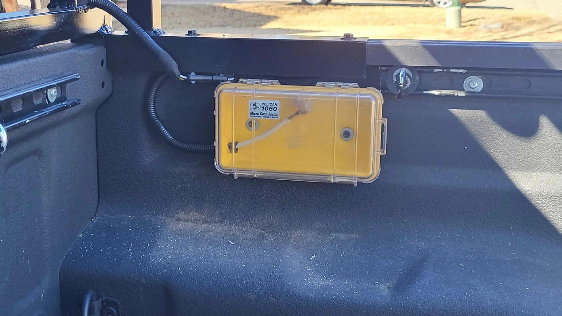

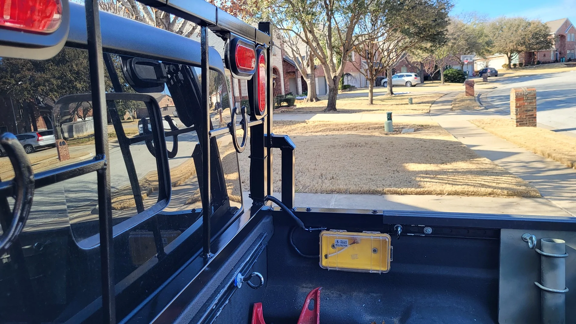

What's the wire/yellow box for?
OK, how I wired it.
First I bought one of those 7-pin wiring harness extension kits they sell to put a 7-pin trailer plug in the bed for hauling gooseneck and fifth-wheel trailers.
That 7-pin plug not only provides all the taillight wiring, but also provides a 12v wire.
I mounted that yellow box (some waterproof fishing box i had laying around for keeping stuff dry on a boat) to the bed and that wire going into the box is the 12v from the plug.
I have a little 20 watt solar panel I plan on hooking into that once I figure out a way to mount the panel.
