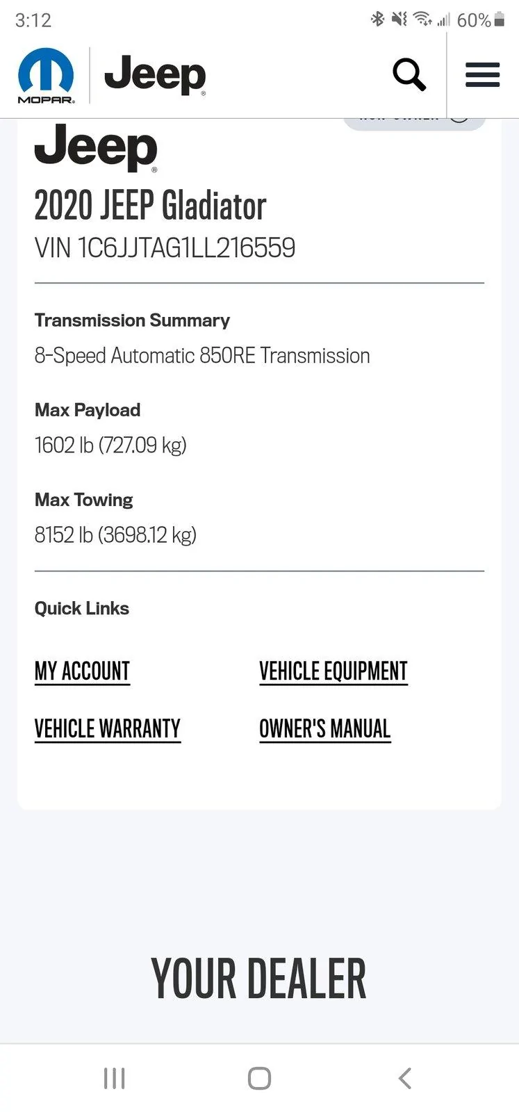

Mine does as well. I actual did the math and came up with over 8000lbs. and assumed there must be some other limiting factor keeping it to 7650; then I dining this on Jeep Wave. I'll likely never ever 7000lbs. but I can if I need to
Did the math? Based on what? The door sticker only shows GVWR and GAWR which are gross vehicle weight rating and gross axle weight rating (for each axle)
That's what the truck can weigh or hold, not what it can tow. The door sticker does payload and vehicle weight.
Trailer would be GCWR of the truck which is gross COMBINED weight rating - truck AND trailer together. That also doesn't show on the door sticker.
Only the marketing info, printed material and your owner manual show the towing capacity. And you can't figure that based on the payload number on the door sticker. That's god as far as payload, the book would be as far as towing.
Like we've discussed to death - if you tow 8,000 or more and have an accident - what's going to happen? They'll go by the legal numbers in your book unless you got something direct from FCA/Jeep telling you it's ok to past over the book numbers in the owner manual and the advertised tow capacity. Someone somewhere is going to ask you if you ever bothered to read the book and what were you told when you bought the truck.....

Well, if you subtract the payload capacity from the gvwr and then subtract that from the cgvwr, then ad in myself to drive it I'm still over 8000lbs.
Will I be doing that, no. But I would have no problem doing it if the need arises.
40,490
53,988
subtract your truck's curb weight from its Gross Combined Vehicle Weight Rating (GCVWR).
The GCVWR is the maximum weight of your loaded truck and the weight of its attached trailer.
So if you take the curb weight away from the GCVWR that should technically show what it's theoretically able to tow.
Likely comes out close to how you are doing it..... unless there's a reason they trim the payload numbers.
But are they reducing the advertised numbers due to cooling or other restrictions?
