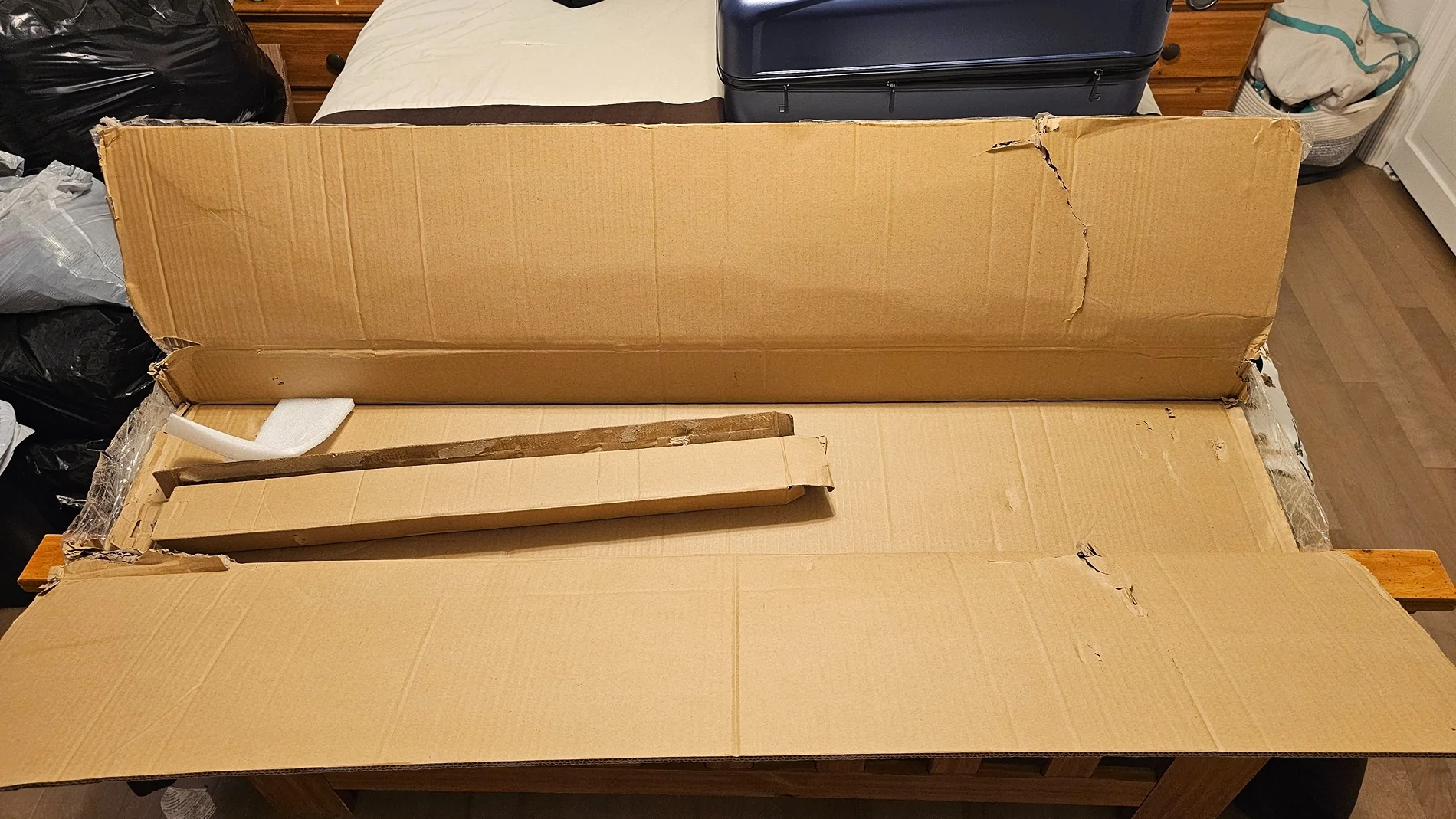

I ordered the OEM trail rail system to install in by truck bed, but the guy that shipped it to me put it in a box with two open ends, enclosed only with packing tape, so the hardware packet slipped out of the box during shipping, and I don't have any of the screws or the rivnuts to install it. He offered me a partial refund for the lost hardware, but the issue is I don't know what to order to replace it all. Can someone with the trail rail system tell me what size the screws are so I can go to the hardware store and buy some replacement screws? I found the rivnuts on Quadrartec's website, and they're around $17 each. I'm looking on the various MOPAR part stores online now for a cheaper option. Thanks in advance.

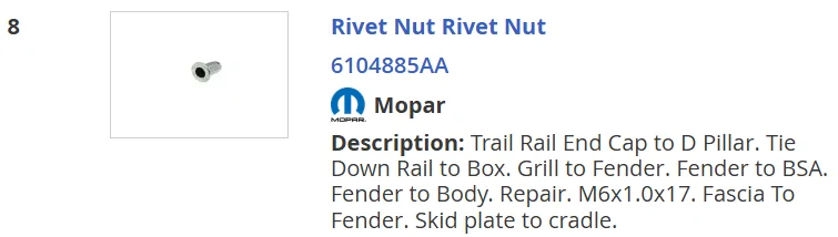

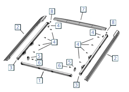

This is what BAM has for the individual parts (#4 bolt, #8 rivnut). I think the bolt part number is a hex head. Mine came with Torx head bolts, but either should work. These are expensive, so just as others said, a trip to the hardware store could save you some money.

$17 should get you a whole box of 100 M6 rivnuts, lol. Nothing magic about the one Mopar supplies. As for the bolts, any 10.9 M6 hex-head cap screw and washer will do. I’ve had mine on and off a bunch for various reasons, and there’s nothing special about the fasteners. No need for the captured-washer versions they supply.
