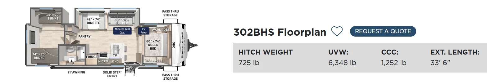

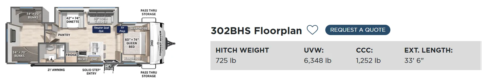

One last blow before we call Elmer's.
With added power come great irresponsibility.
People who tow will be all excited to push that envelope. It's a V8 (or HO 6)! It can tow over 7000# easily! A lot of travel trailers are under 8000# - built for the 1/2-ton full size market - that are 24'-34' long. That's a bad combination for the JT. And people will ignore the frontal area guidance Jeep includes for each model.
Don't run out and get that Solaire trailer quite yet when the "big engine" JT option drops.
Jeep Gladiator If Wrangler and Gladiator are the same from the cab forward ......? 1769527075096-yd
Knowing that people are going to ignore towing numbers and guidelines, Jeep might just be considering that negative aspect as well, as more than a few idiots will try to sue Jeep for a "dangerous at any speed" vehicle; which will become a cost center for them, even when it's not Jeep's fault people are preternaturally habituated by today's society to absolve themselves of personal responsibility.
But don't take my word for it, here's an engineer's statement (emphasis mine):
Towing stability is a matter of physics that exists separately from legal limits and weight capacities. The primary danger associated with a disproportionately long trailer is trailer sway, where the trailer’s side-to-side movement can quickly become amplified and uncontrollable. This swaying is a result of the trailer’s length acting as a long lever against the tow vehicle’s rear axle, especially at higher speeds or in crosswinds.
A guideline relates the trailer’s length to the tow vehicle’s wheelbase to predict stability. One guideline suggests that a 110-inch tow vehicle wheelbase can safely manage a 20-foot trailer, with each additional four inches of wheelbase allowing for another foot of trailer length. While this is a guideline, not a law, exceeding the resulting length significantly increases the risk of the “tail wagging the dog” effect.
Proper weight distribution and the use of specialized hitches are employed to mitigate the leverage of a long trailer. Hitches with integrated sway control, such as friction or articulating systems, physically dampen the trailer’s lateral movement, making longer combinations more manageable. However, these devices only manage the symptoms, and they cannot completely overcome the instability caused by a trailer that is excessively long for the tow vehicle’s design.
How Long of a Trailer Can I Tow Legally and Safely? - Engineer Fix
However, since many live in the world of "If' and "They can just..." that's inconsiderate of real-life conditions, Jeep could kill two stones with one bird. Lengthen the front by 4-6", shift the rear axle rearward 4-6". Dump the under-bed full-size spare, and 8-12" of wheelbase that'll give another 2'-3' of trailer length by 'rule-of-thumb' guidelines. The front room would probably allow for the 3.0LTT. The rear axle movement will improve the rear overhang/breakover angle (and look more bobbed), and possibly make available a "long box" JT model... if anyone is looking for a few more inches in the bed.
eTrailer.com guide (JT = 137"):
Remember, a person is smart, people are dumb.
Jeep Gladiator If Wrangler and Gladiator are the same from the cab forward ......? 1769525795037-jz

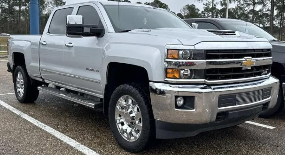

Once my needs turn into needing to drag travel trailers, I have my 'new truck' picked out...
Jeep Gladiator If Wrangler and Gladiator are the same from the cab forward ......? 1769529585433-br
Jeep Gladiator If Wrangler and Gladiator are the same from the cab forward ......? {filename}
That would be the smart ticket. However, idiots live among us.
