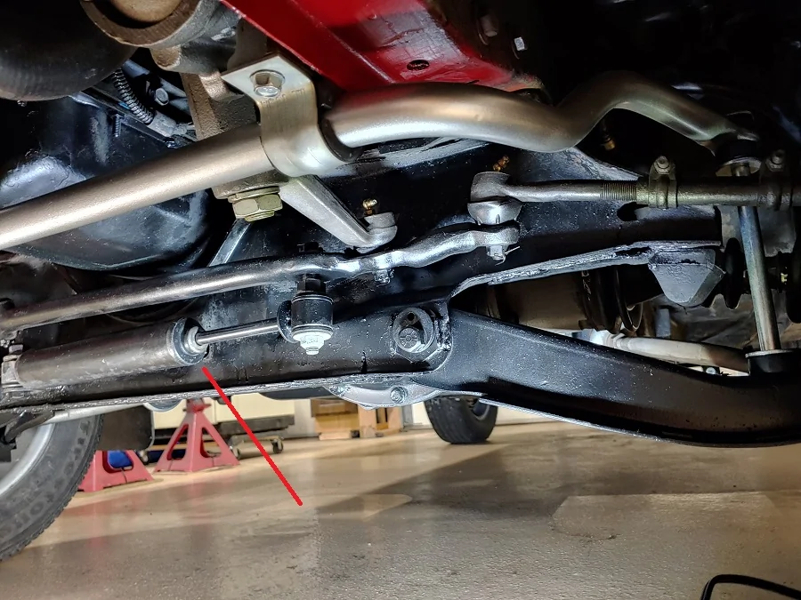

Steering stabilizers are never the cause or the fix for DW. Good luck.
Jeep Gladiator IFS coming in 2029? img_9612-jpeg
Exactly. They are for bump steer. Dozens of threads here explain and I've posted a number of quotes and graphics from engineers, and a Jeep builder, who state that quite clearly (but people don't want to believe the experts, so it keeps getting said)

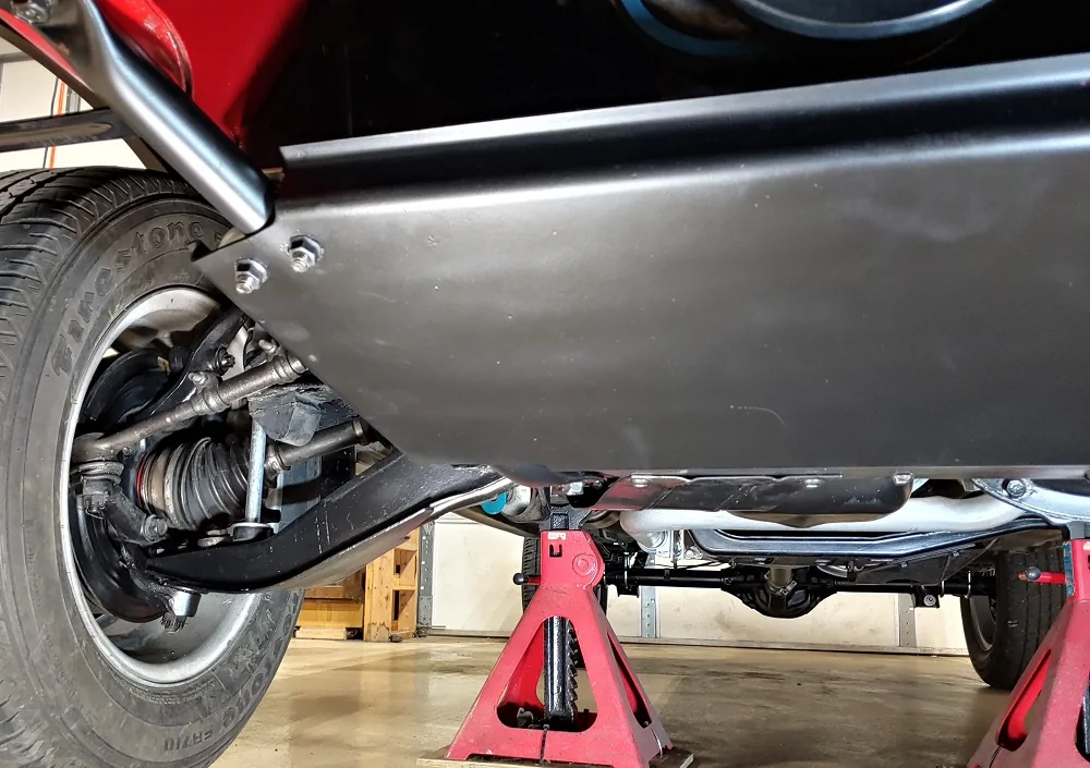

Vehicles with IFS come out of different places. The frames are built in a different building. The front suspension being all the same makes it really easy - but once you say we do Mojave in IFS and Rubicon solid axle, now you have two different frames to build, two different frame lines, different vendors and suppliers and you would likely have final assembly on different lines instead of all coming down the same line. The equipment is set up to deal with specific parts.
The jigs for welding the frames for IFS would have to be different, you'll have different shock placement, new upper and lower left and right control arms, axles with joints on each end - for each side.
you'll need a new way to suspend and secure the front differential as it will have to hang from the frame and be mounted solidly (getting rid of any front driveshaft issues, but now you'll have your axle joints running extreme angles)
