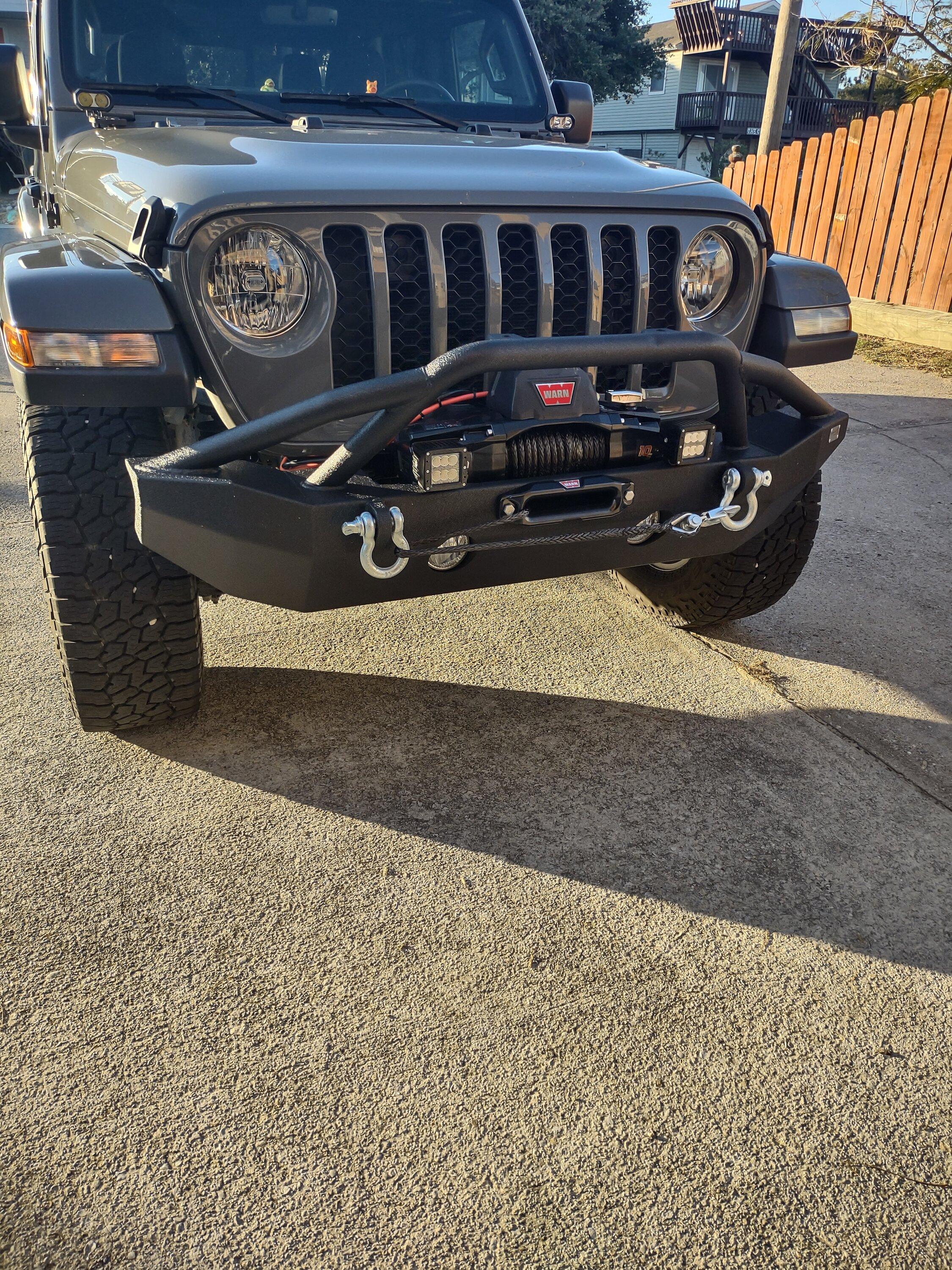

The weight will settle the front of the truck, but I noted almost no difference in ride. It did feel more planted, almost better, but the ride was good as ever.
This has been experience as well, only had mine for about 3 days. I also have noticed some added resistance in the steering while working my way through parking lots and tight spots on pavement at slow speed. Plan on bumping up the air pressure in the front tires a bit to see if issue goes away.
Good luck with your decision, regardless of how you use your truck.

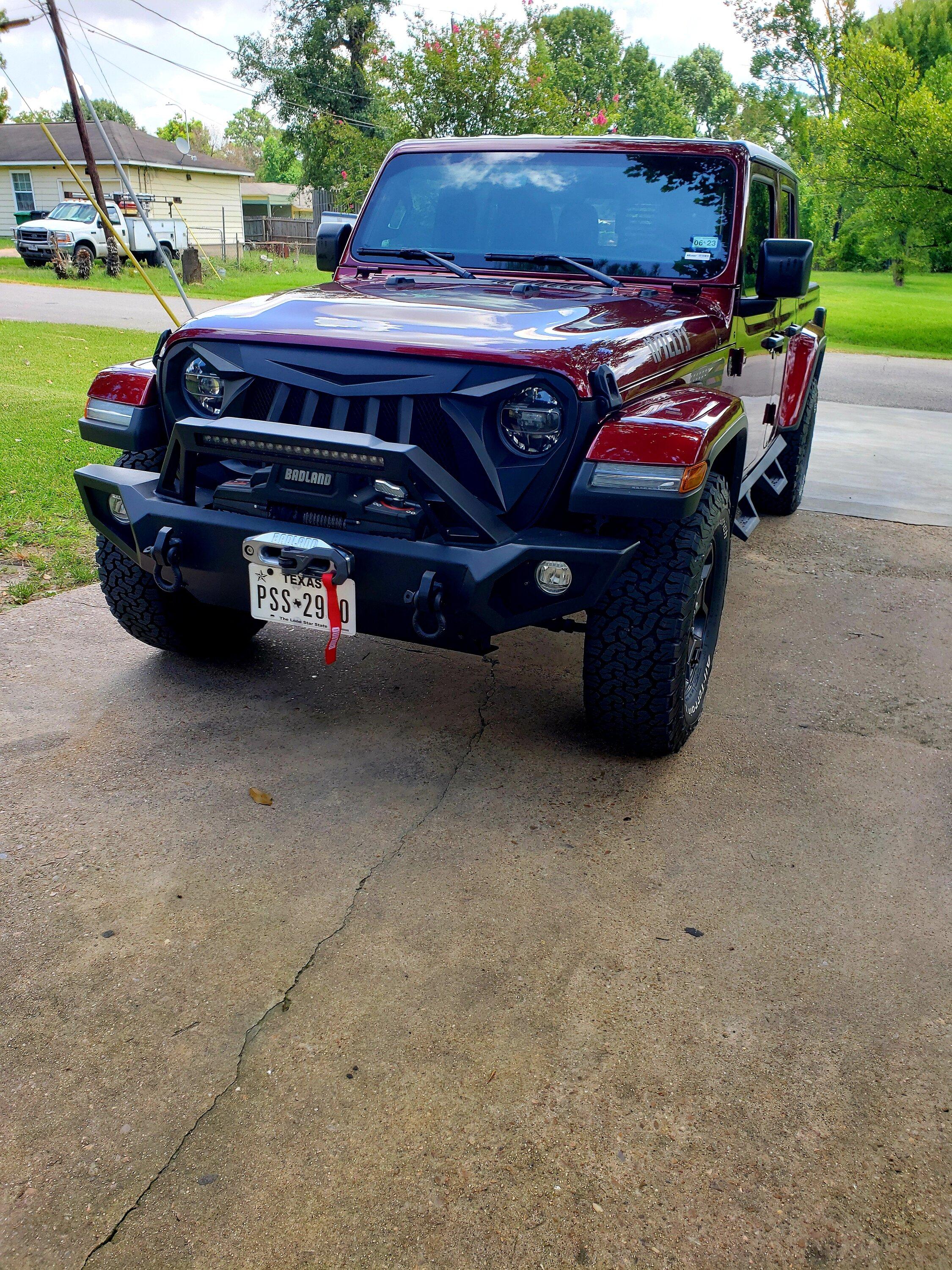

A winch is only necessary to one that is willing to purchase it. Main reason I have one is to have the peace of mind that if I'm not with the wife and she needs to get out of something before I can get to her the option is there.

Yes to tire pressure.
More weight means it takes more pressure to support said weight with the same tire footprint.
Science. PSI working against an area to support a given weight.
It's an equation - more weight to the left of the = sign means you need more pressure to keep the same footprint on the ground and not squish the tires more.
When I asked the engineer at General about the pressure in my General tires, he wanted to know my truck's weight, etc. before he could answer.
The tire pressure sticker on my SX4 has more psi in the front tires because of the extra weight of the front differential and transfer case in that car compared to the exact same thing but 2 wheel drive (the Spirit).

Some add spacers, but I added different springs and tires and that took away that feeling up front.

Spacers and springs won't impact the feeling he's referring to as far as turning being more firm in tight spots when not rolling at speed.
Tires MAY if said tires have less friction - are less sticky, maybe a bit harder rubber, or are aired up a bit more, whatever.
Springs, can't matter on tire forces in a parking lot.
He's referring to the extra weight putting downward pressure on the tires which means more friction, plus if the pressure isn't adjusted up a bit, it means the tire flattens so there's more rubber on the road. All that leads to more resistance to turning in the parking lot - bigger contact due to the added weight, more weight forcing the rubber against the pavement more, adding resistance to turning.
No spring or spacer can take that friction away. Only bumping the pressure up just a bit to get the contact patch back to the size it was - and getting used to the added weight because nothing takes away the added force pushing the tires harder against the pavement.
In short - his tires have more grip, so turning will be a tiny bit harder for those of us who get really in tune with how much turning force is needed on different surfaces at different speeds.
It's the opposite of a trailer with a heavy tongue and the feeling that the steering is looser - less weight up front forcing the rubber against the pavement so less resistance to low speed turning.
