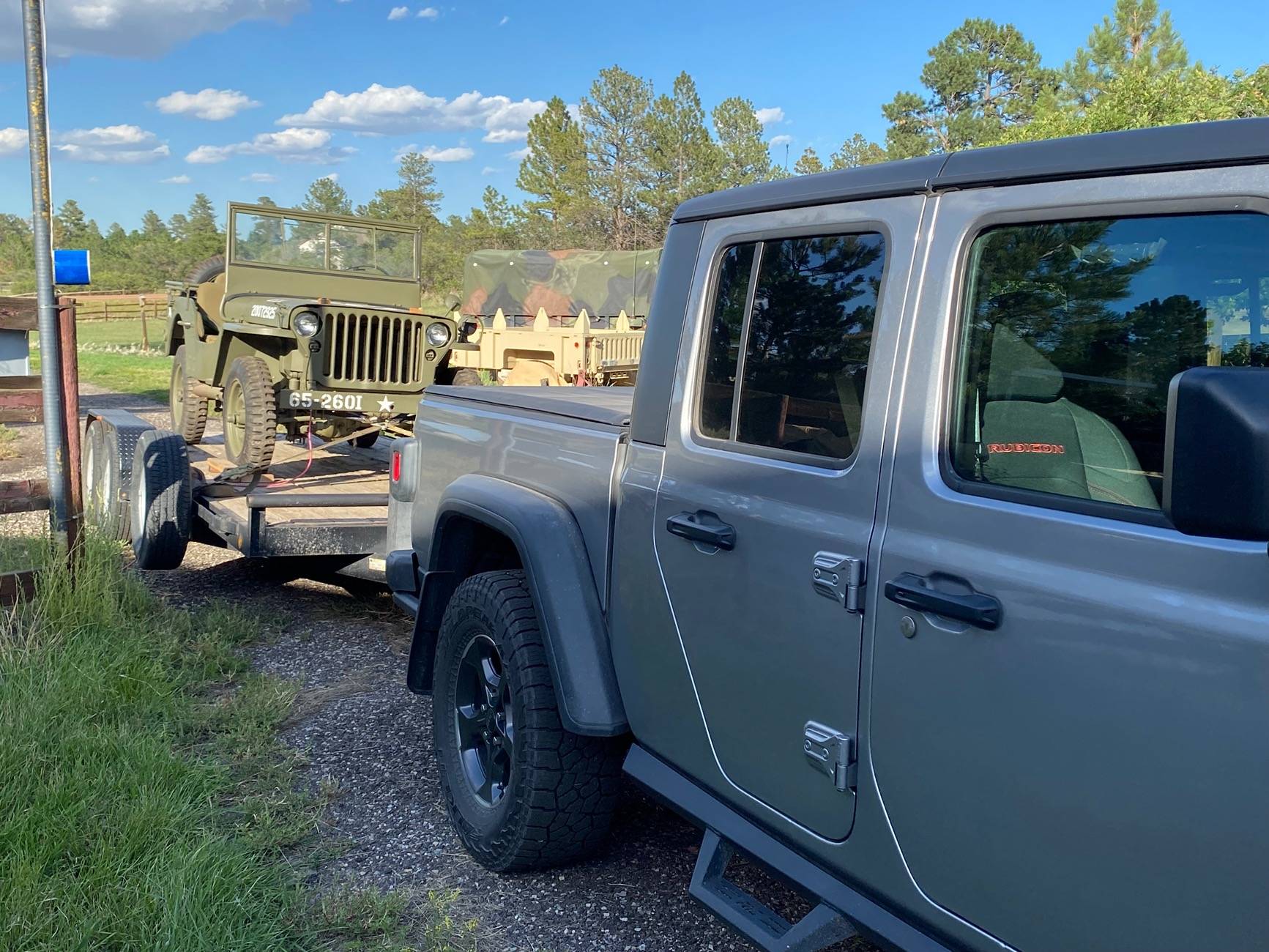

2020 model and cruise control works great even while pulling pictured rig On level ground up to mild hills. Stays with +/- 2 mph unless steep hills encountered. I click it off in that situation.

In case anyone was wondering, that’s a 4000 pound load evenly split between the MB and the trailer.
