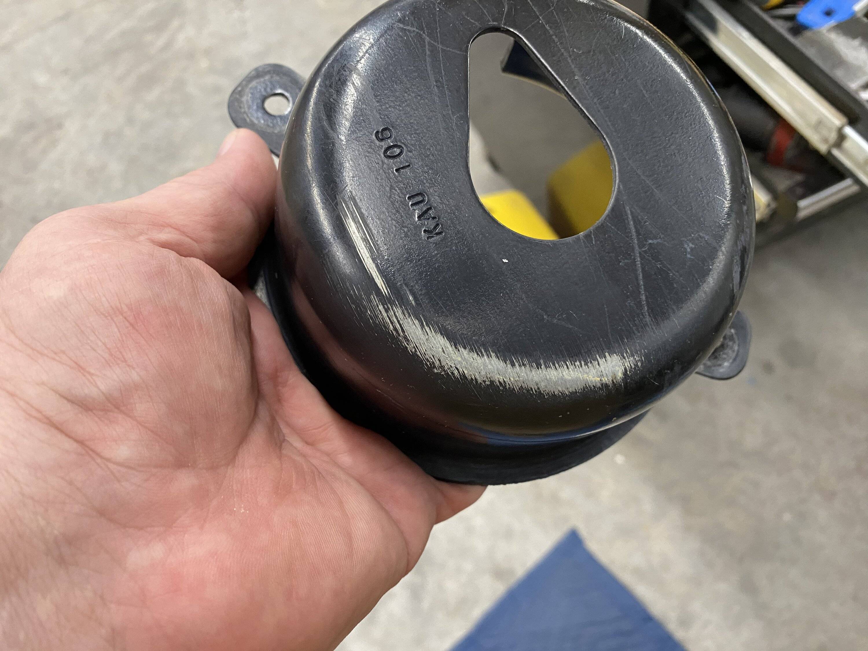

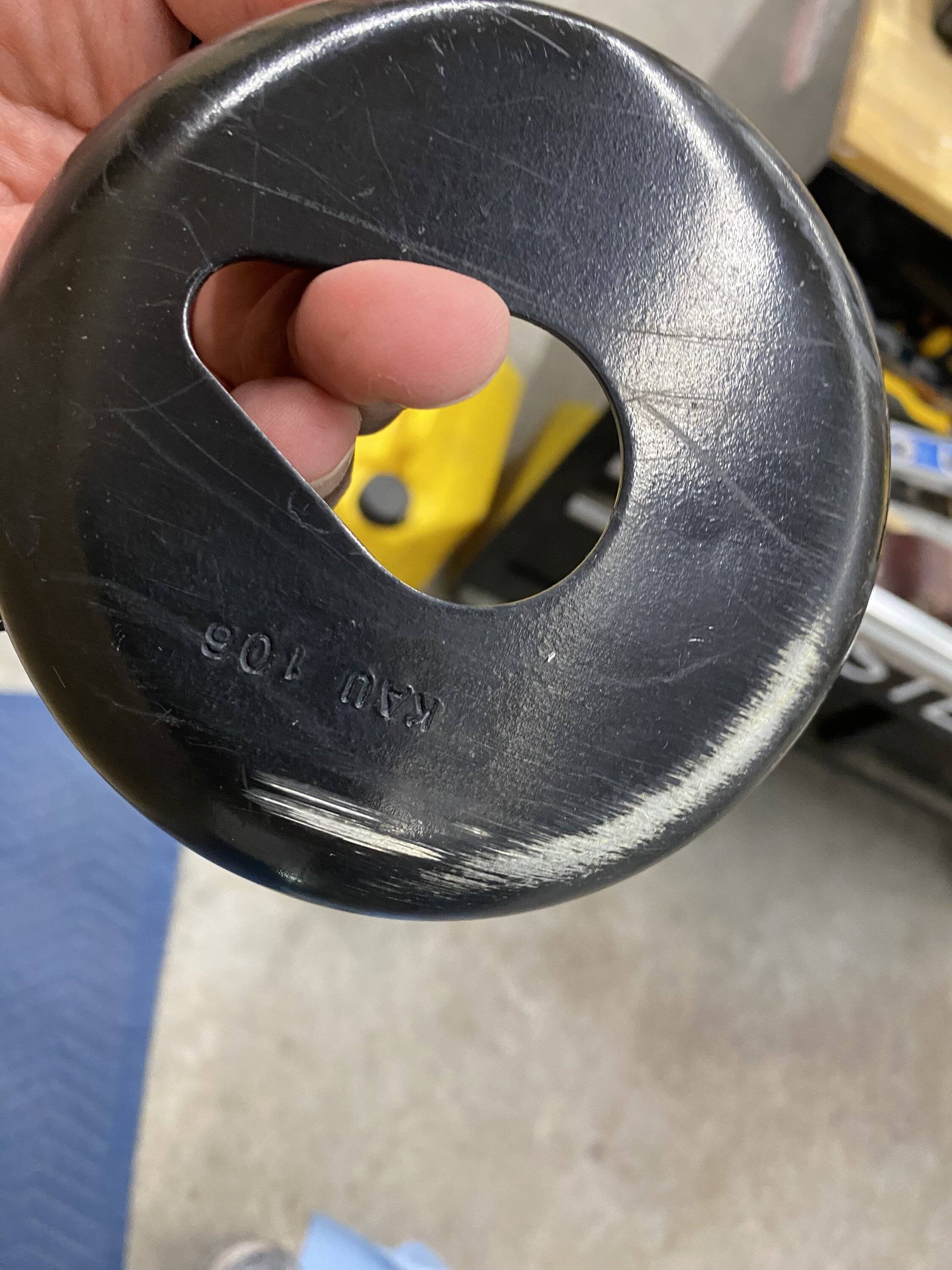

iff you look up under the vehicle under the driver seat and in front of the fuel tank you’ll see a small round skid plate with a teardrop hole in it. Theoretically, you can attach a rubber hose to the fitting and rotate a valve. Well my sausage fingers won’t allow this and there are only 3 small bolts holding it on. To me it was easier to just remove it. Unfortunately, I failed to snap a pic of the valve itself. But I just attached the hose on one end and placed the other end into a 20oz. bottle so I could see or identify how much water it was holding. When the filter housing quits draining tighten the valve back up. Set the bottle aside to the water will settle, then either reinstall the skid plate or remove the whole filter cap to change the filter. There are numerous vids on YT. Just don’t forget the rubber gloves!!! There isn’t a ton of fuel that gets out, but a little goes a long way.
