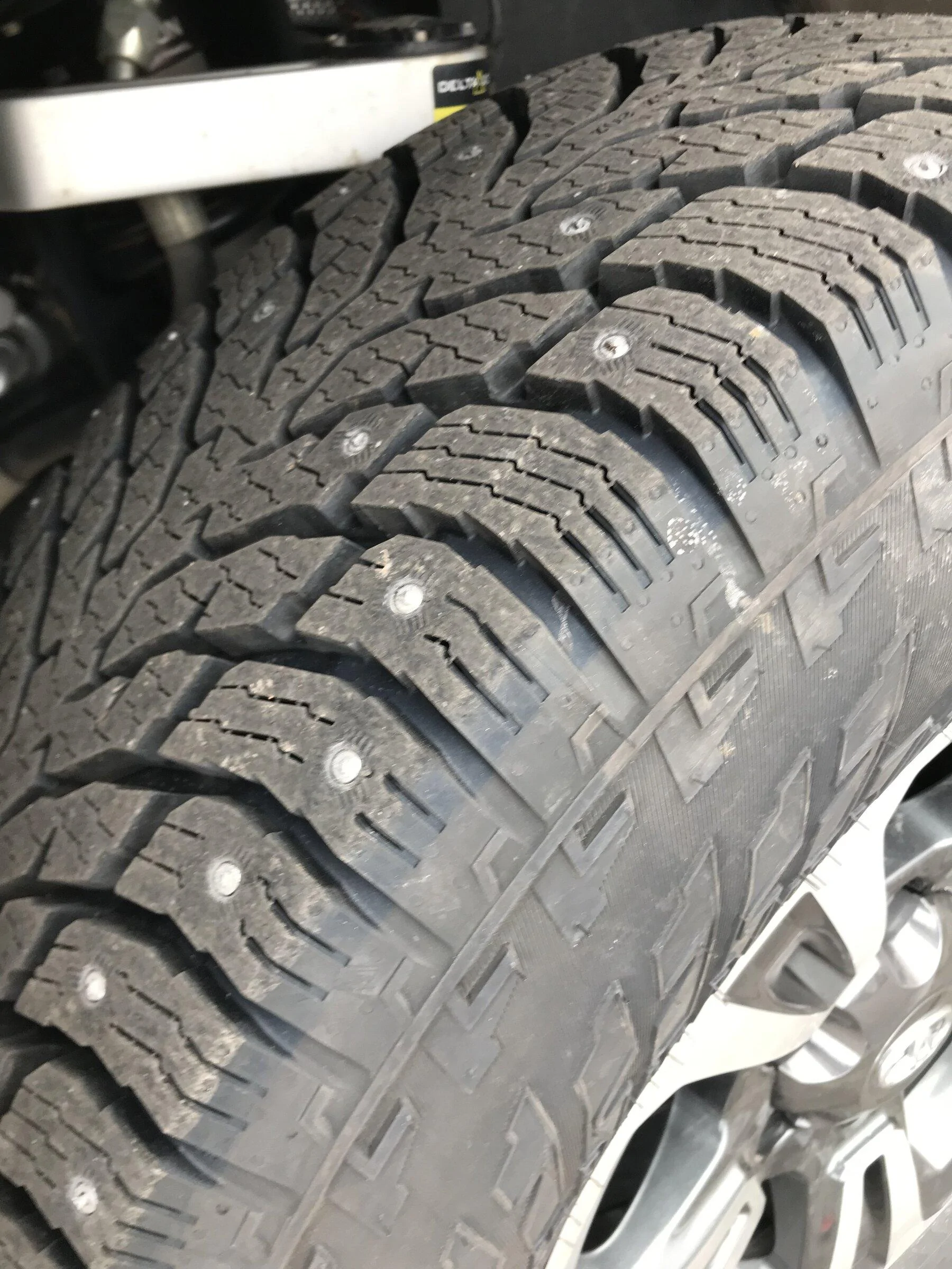

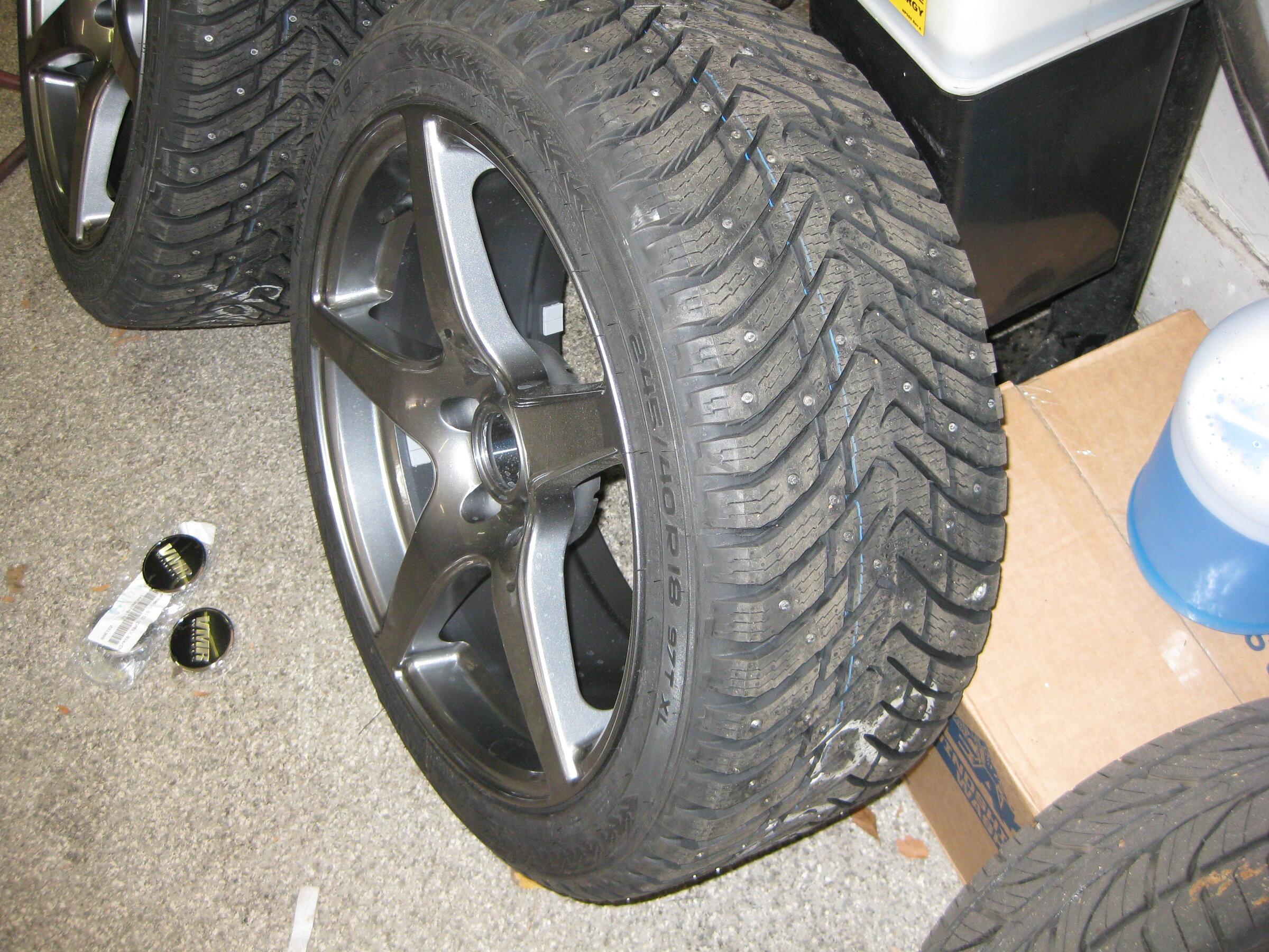

^ This is 100% true. I've driven part-time four-wheel drive vehicles for 40 years, shifting in and out of 4-wheel drive using a manual transfer case. Mostly Jeep and Toyota. I love these vehicles and currently there are three in our driveway. But we've also owned a couple of Audi quattro vehicles, and with snow tires, there is no comparison to the Jeeps & trucks in winter conditions. Wearing good winter tires (Nokian, Blizzak, etc.), a good all-wheel drive vehicle provides unbeatable winter traction: acceleration, cornering, and - critically - braking. Test after test show that stopping distance is much much shorter on snow and ice in vehicles with true winter tires. Where the Audi falls short, is when the snow gets deep. So the best of both worlds - for those who drive a lot in winter conditions - is to get a true four-wheel drive with good ground clearance, but one that also has the "Auto" or "All-Wheel" drive option, and slap on some good winter tires!
