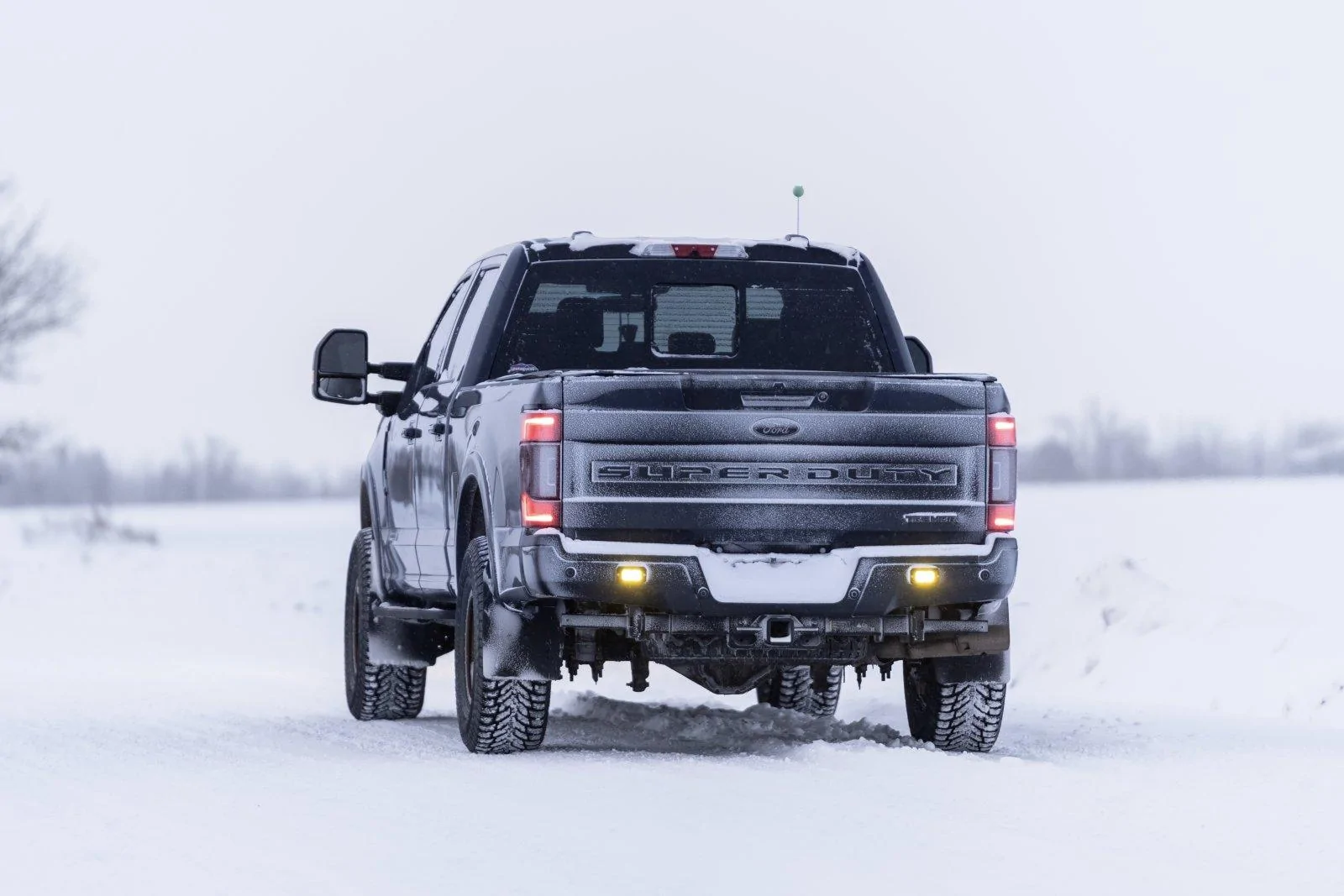

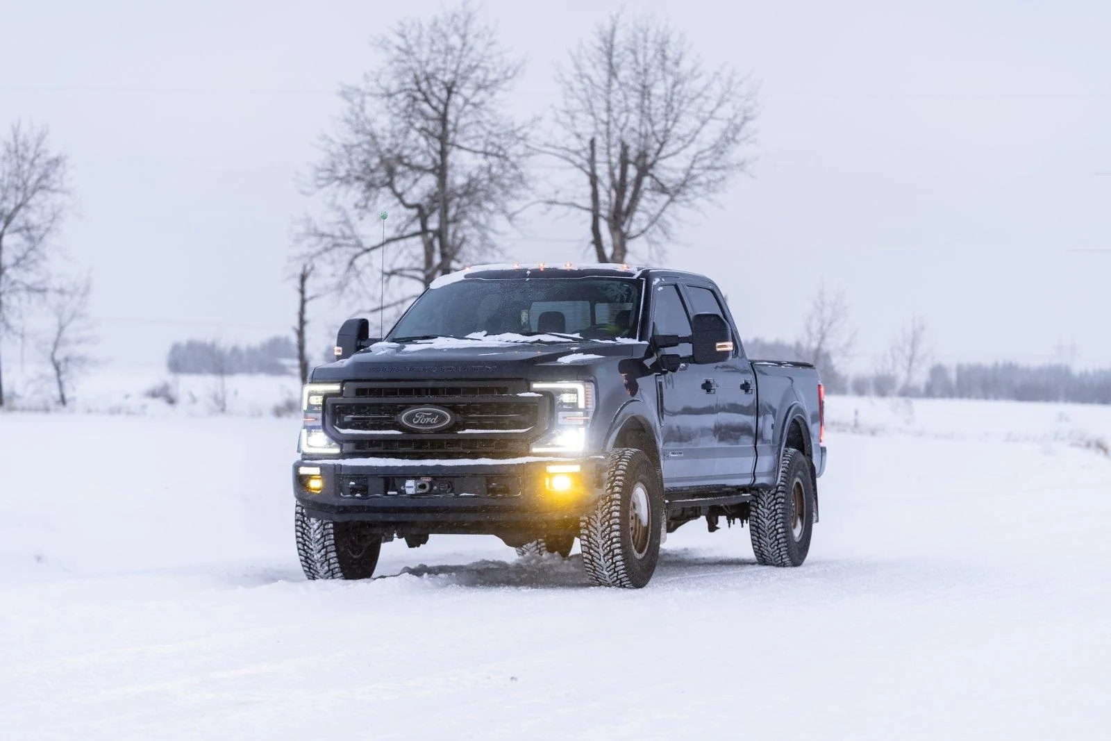

Yeah, but they don't make many dedicated winter tires in the stock Rubicon/Mojave size, and none in my aftermarket size. Of the two stock size (285/70/17) winter tires I see on tire rack, one is indefinitely out of stock and the other has 1 tire available.
Nokian makes excellent winter tires in - roughly - 31, 33, and 35 inch diameter (converted from the metric). They make tires for cars as well, but their best winter tire for trucks is the Nokian Hakkapeliitta LT3. Whether or not they have any in stock is another issue. We've been running these tires for years in snow country, and swear by them. I chat with a guy who is super-happy with the 35-inch Nokians on his Ford F250 diesel:
Jeep Gladiator Is selec track (or full time 4WD) inherently bad or weaker? Tremor_Nokian_3
Jeep Gladiator Is selec track (or full time 4WD) inherently bad or weaker? Tremor_Nokian_2
I believe he is a professional photographer, here is his Instagram page if anyone wants to check him out. Good stuff: raysumedia
