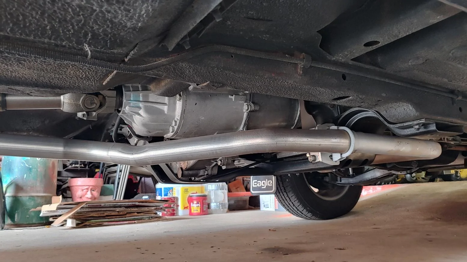

I've had several cars with such a coupling in the transfer case. The one in this car was a NOS one I landed when my original blew the coupling. The reason for the failure was that the thrust washers inside were just that, washers, things wore, allowed movement. A Jeep dealer friend in MN said they used to take the brand new transfer cases, take them apart, machine the inside of the case to allow a thrust bearing to be put in place and the couplings lasted almost forever. This was in the 80s.
Jeep Gladiator Is selec track (or full time 4WD) inherently bad or weaker? 20210912_103042_HDR
