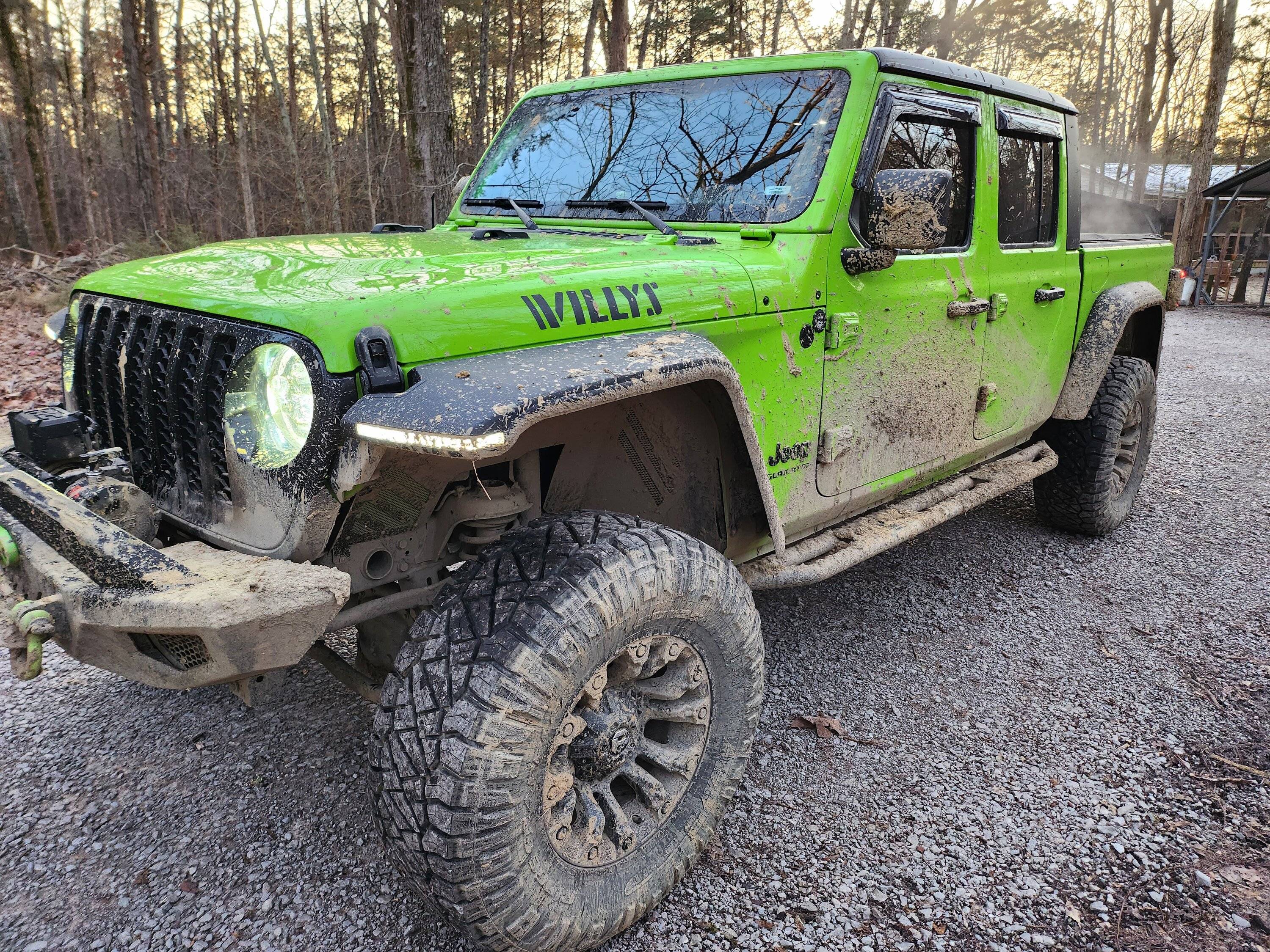

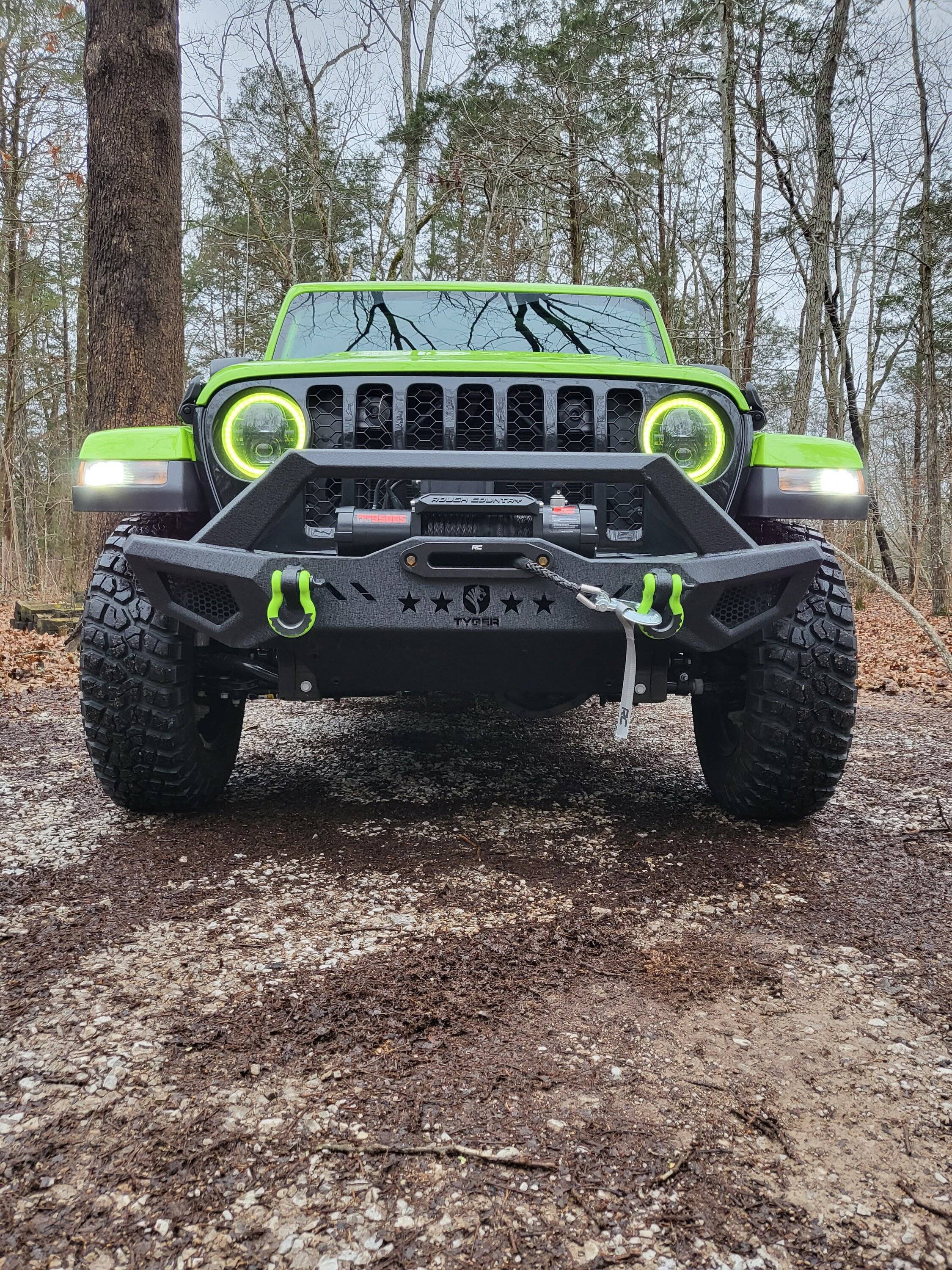

I have a 21 Willys with a LSD in the rear and an open diff up front. I will eventually install lockers as that is the one and only regret I have about buying a non Rubicon JT. My question for the masses is should I install 1 locker up front and leave the LSD as is or bite the bullet and double my cost and do them both together? If I double my cost how much more advantage will a true locker be over the LSD? As far as I can tell the LSD works fine. It clearly leaves 2 tire tracks in my gravel driveway. We went to Windrock over the weekend and I got humbled by stock Rubi Wranglers pulling through some horrendous mud pits. The main difference was thier lockers and my lack of lockers. Yup, I had to be winched out. Had a blast though.

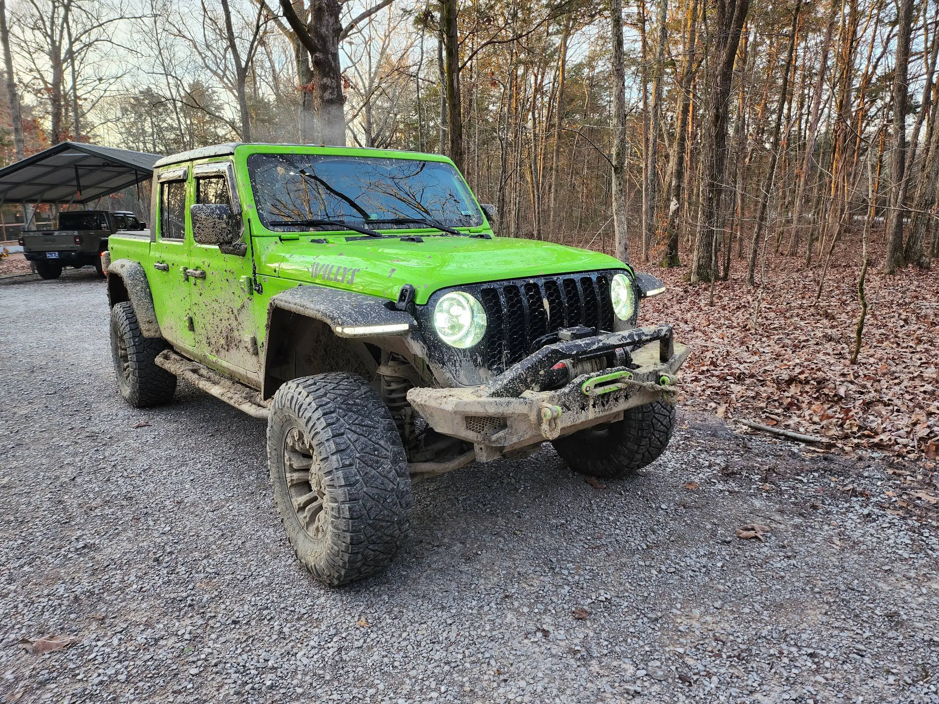

I have a winch and all the recovery gear. It all worked out great for me in the mud. I guess it's more about having the best chance of getting through or out of situations as they come up and a little about bragging rights to not get hung up to begin with.

After looking at the pics, the first post pics have different tires than the follow on post.

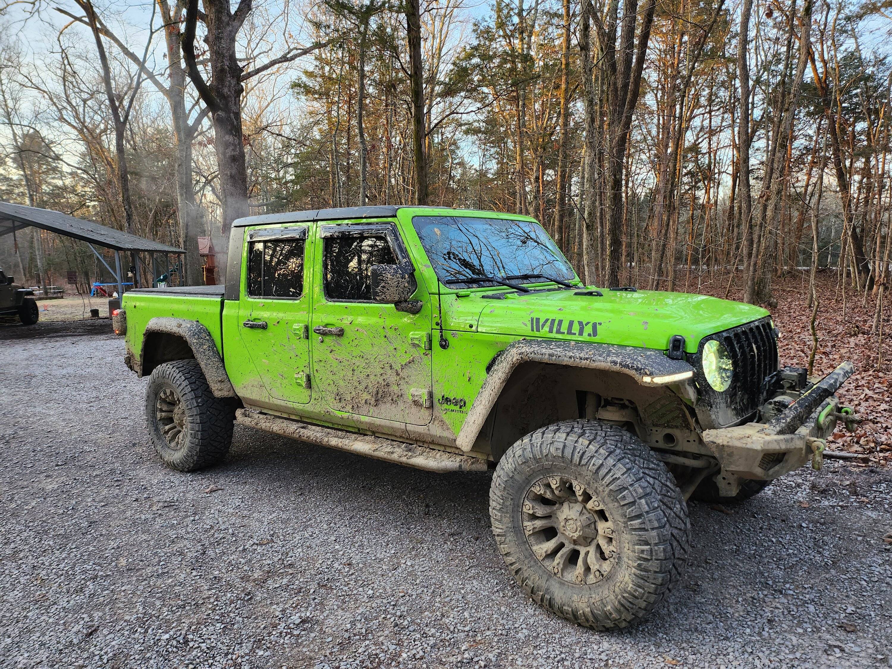

I couldn't agree more on the re gear. I am considering doing that as well. But this is currently my DD and I have to ask myself at what point does it quit making sense to dump money into upgrades on a truck thats 95% on road 5% off. I'm not wheeling every weekend although I can see where that could become a thing for us. But I'm looking at buying a dedicated rig for that. Good eye on the tire size. Yeah that Pic was long before tire upgrades. Just showing the winch/bumper setup. Here's a better representation of current. Looking like a JT should!!
