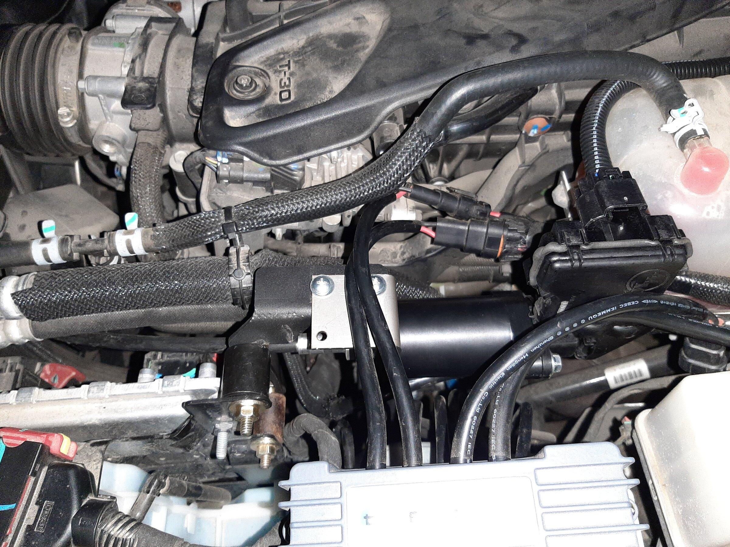

The electric shift system uses an electric actuator to drive the cable to the lock or unlock position which in turn shifts the fork inside to engage or disengage the locker. This eliminates the need to find a place to mount the manual shifter and cable assembly inside the vehicle. The actuator is designed to be mounted outside the vehicle and will resist the harsh environment. i hope this helps. i can add a picture of how and where Fat Bobs installed the actuator if you would like.
I’d love to see how the cable is routed/attached and where the actuator is attached.

i am not sure on the eaton locker, but that does sound correct. however, when the ox locker is locked up it is locked up no matter what direction you are going. here is a picture of the left side of engine compartment where the electrical actuator is located.
Jeep Gladiator Ox Lockers 20211212_211107

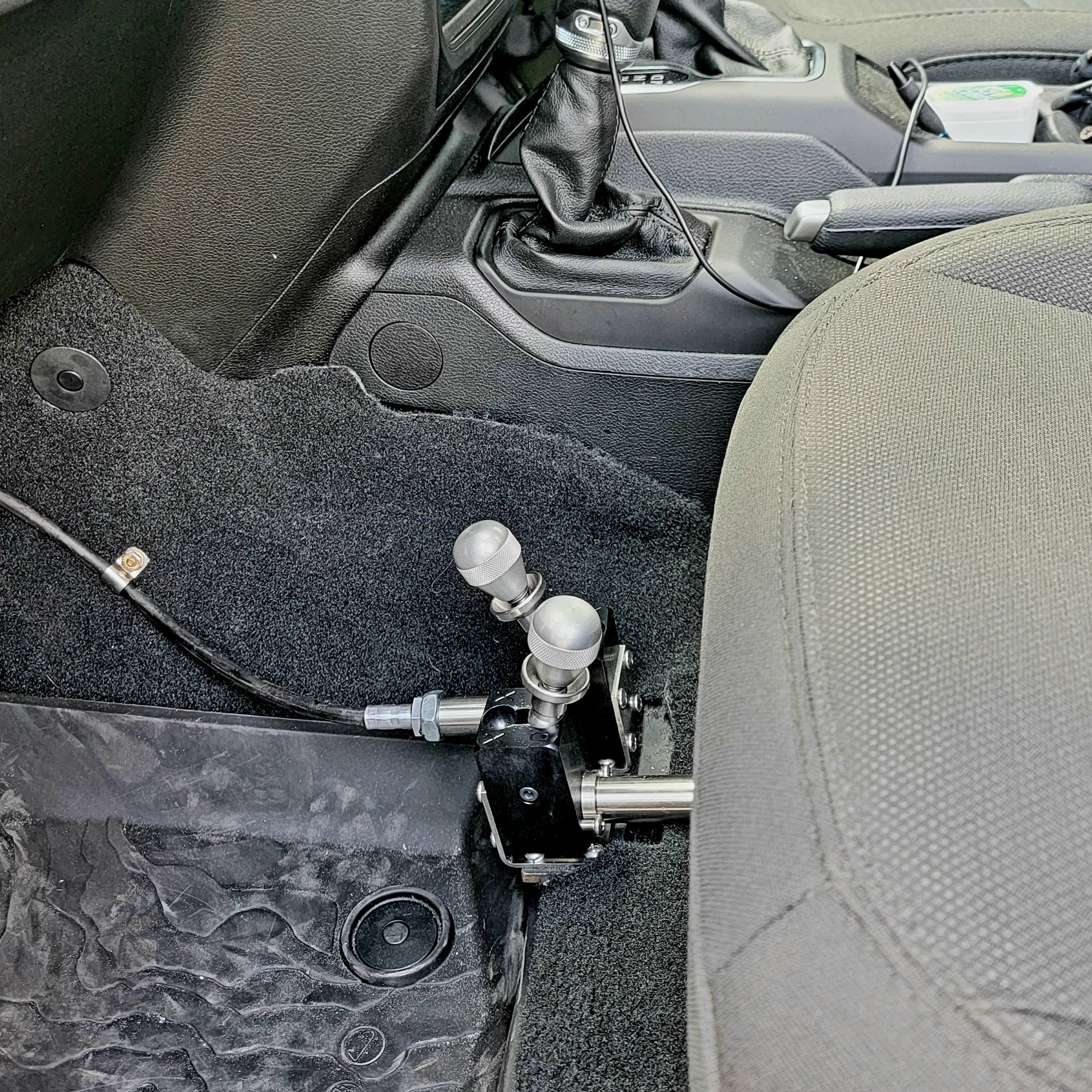

I really wanted the manual shifters in the cab but there is just no way to route them without binding. In a buggy or something without modern electronics and full interior you can route them but not in a JT without doing some serious cutting to the floor pans or trans tunnel. I may still go with OX at both ends because I love the positive engagement. If I do I’ll go with the electric actuators versus the air.
Jeep Gladiator Ox Lockers 20230829_150821
Ali689
Apr 8, 2023
53
Florida
I didn't have to cut and huge holes. Just bought very long lines, ran out the front firewall and out under the rear seat. Nice gentle curves out, then down to the axles. No binding. No issues. 2023 max tow/ metalcloak 3.5"
