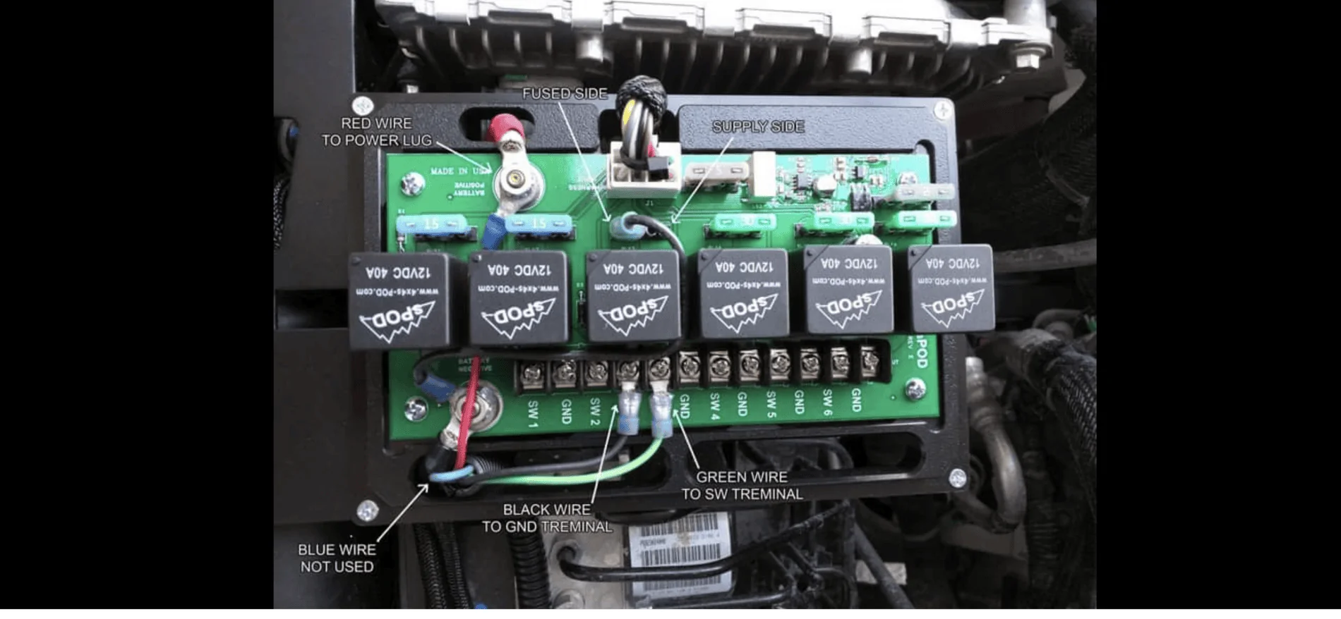

I ordered my Ox lockers yesterday (actually the shop I use ordered them for me). After they were ordered I started wondering about using the factory aux switches to engage / disengage the electric shifters. I assumed it could be done, but after watching the Ox electric shifter install video on youtube I wasn't sure. I just looked at the electric shifter installation manual (https://ox-usa.com/electric-shift-manual/) and see that the aux switches can be used, but a relay will be required to connect the green wire to ground to engage the lockers, and to disconnect the green wire from ground to disengage the lockers.
WK2JT
Darren
Mar 11, 2020
806
835
Highlands Ranch, CO
JTC
I saved this a while back that shows how to wire it to an spod.
Jeep Gladiator Ox Lockers D66DE8A2-04AC-4DF3-A499-5A1FA744F898
