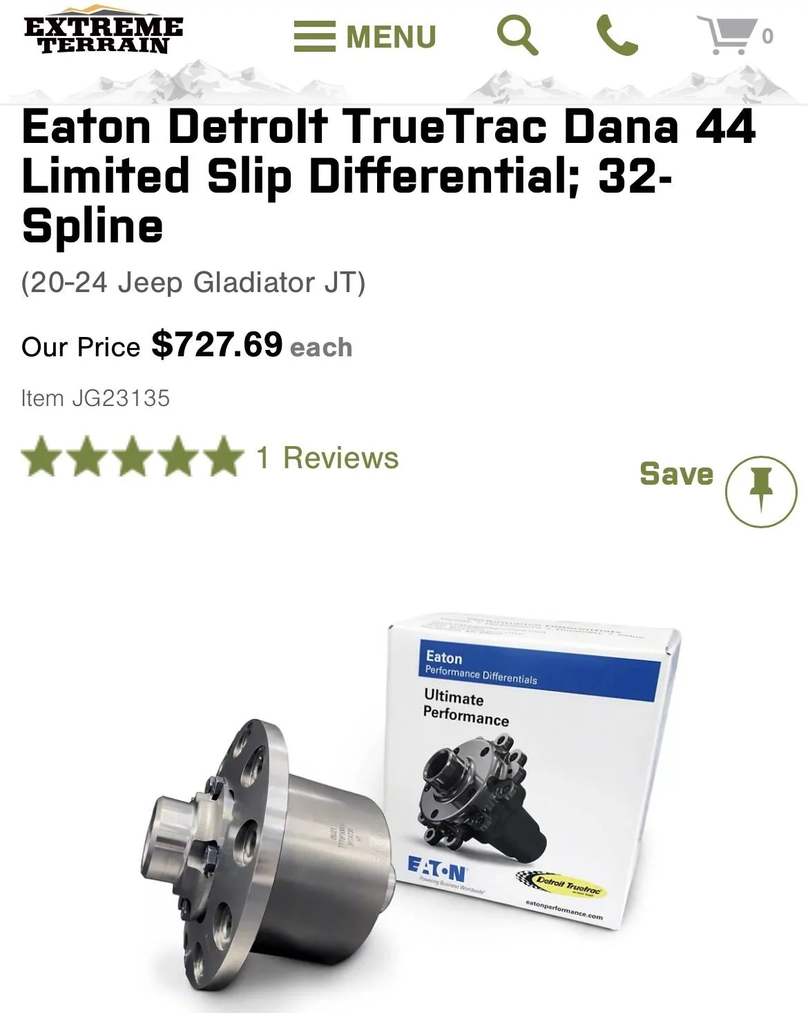

I would honestly spend the extra 300 bucks and just do LSD personally. But that’s just me.
Jeep Gladiator Lunchbox Lockers??? IMG_6745

My current plan is to replace the factory rear limited slip in my Willys with a TrueTrac, but I want a true locker for the front. One benefit with the CAD is that you won't even know it's there in 2WD except for the driveshaft spinning. I plan on doing the lunchbox locker soon and regearing it in the winter, so I'll have some time to see if I like it or want to replace it with a TrueTrac or a selectable locker when I regear.

The limited slip allows almost as much slip as the brake lock differential system does in my experience. I don't see much gain adding an lsd to the front. I think a lunchbox is perfect for the front of a JL/JT as the fad makes it invisible on the street and you get full lock up when you need it off road. The other problem with the full case lsd is that you need to set the gears up again. There goes another $1000. It's not a $300 difference is a $1300 difference for less gain. If you're regearing at the time anyway then maybe it's an option, but you're still paying more for less in my opinion. The only place I'd even consider an lsd over a locker is if you frequently drive on ice.

$1300? Guess I’m the only one doing my own work these days ?‍♂
