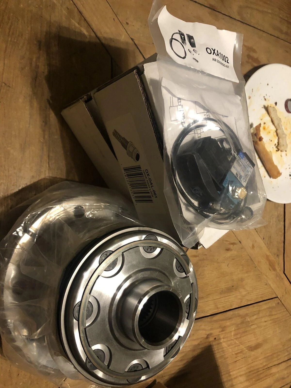

Mine came in , waiting on axles and gears , and tires I guess , but parts are starting to roll in.
Edit: I see your running a bottle. Trying to figure out what I’m going to do for switches and location right now. Currently I have no idea what I want. Do you have the factory aux switches or going to mount that somewhere else?
I do have the aux switches, I’m gonna run the solenoid off one of them and yes a bottle, 12 or 20 oz , I have a powertank set up so I’m not interested in an air compressor, they are just so slow
where is your bottle mounted?
