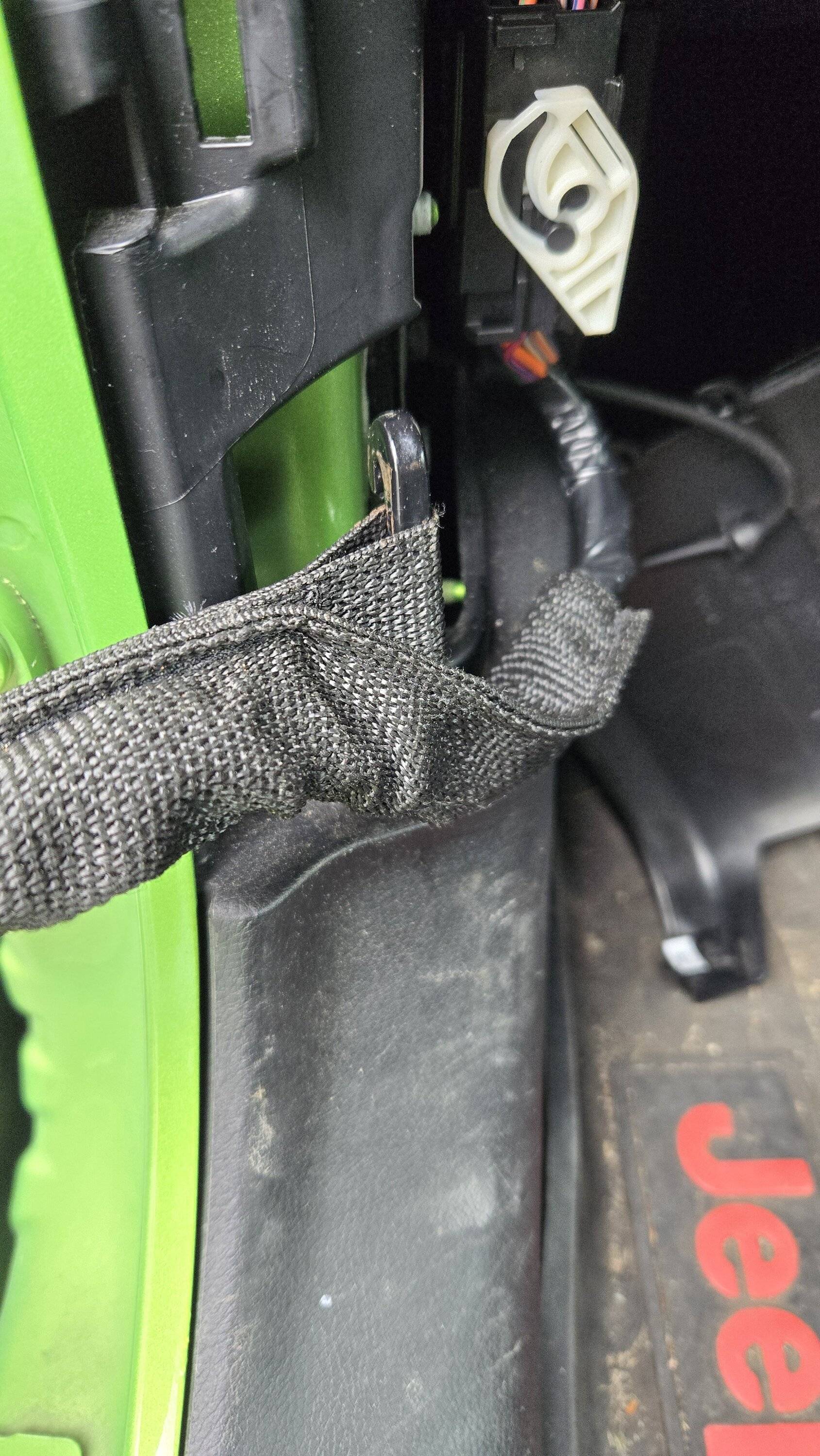

So my legs get chewed up driving the Gladiator and our 4xe Wrangler. Most often they rub against the door connector cord cover. I know there's a video of twisting the door connector cord upside down to keep it from sticking out into the driver's well (which I haven't done), but has anyone else had this problem? What was your fix?
For reference, I'm a thick 6'1 with size 13 feet, so the foot well is relatively tight. I often adjust my driving position and legs, but after a while of driving, I may move back against the cord cover. The pic at right is not my Jeep, but is just a reference pic of the cord and cover.

Was one of my main complaints, the strap on the left, transfer case shift on the right.
Rotating the strap moves it out of the way.

In case someone comes to this thread and doesn't go to the other referenced threads, this seems to be the most common cure:
Unplug the door harness from its connector like you would when taking off the door. On the driver's side, rotate the plug 360 degrees counterclockwise, then plug it back in. On the passenger side, do the same with the plug in the clockwise direction. Now when you close the doors, the torsional tension will coil the harness upward as it bows.​

When you twist it... make sure it's not getting pinched in the door when you close it.
You can close the door with that loom in the door jam and not know it.
I don't know how long mine was getting pinched in the door. Just happened to notice it one day.
I think it happened when putting the doors back on, never paid attention to the twist when reconnecting. Disconnected the loom and gave it a 180 twist.
