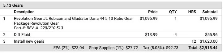

The local shop here Exodus 4x4 charges $2250 which seems pretty on par for the rest of the 4x4 shops and has a video that goes over regear pricing and what to look for.
Exodus 4x4 Jeep Regear Info
I'm only a few hours from them, and even though I can do gears myself I'm considering them for my JT and wife's JL just for parts and labor warranties.

East coast gear supply is one of the best in the industry, you're paying a premium for their experience and name. I wouldn't say it's not worth it, but if it takes 12 hrs to install Dana Spicer gears they are charging more hours than it will take. I did mine in less time on a set of quick jacks crawling my fat butt out from under my jeep over and over again....
Dana Spicer gears are all set to +/-0, meaning they are cut to run a correct pattern at the same pinion depth as factory. Not saying a good shop won't CHECK the pattern, but in theory the setup should be substantially easier than other manufacturers.
The Exodus4x4 quote that was posted is also absolutely a top of the line company, but notice they don't put any brands/details on the quote, just "Gear Package" no idea what you are getting. I would guarantee if you requested they buy spicer brand gears/rebuild kits that price would go up. Not saying I wouldn't trust exodus to put in what needs to be put in, but it's not a true Apples to Apples comparison.
Having a buddy that can help is definitely the best way. Like I said, Spicer gears are the easiest to set up and if you're doing it yourself/having a buddy do it, I'd gladly pay more for Spicer gears vs. other brands just for the ease of setup. Show your appreciation to your friend by spending an extra 200-300 on the gears vs a cheaper set that's going to require more time to set up.

12hrs for labor seems a little high. i would think it's closer to 8 hours, 4hrs per axle, worst case. The rest is material costs. You would still be looking at $2700 for the work.
