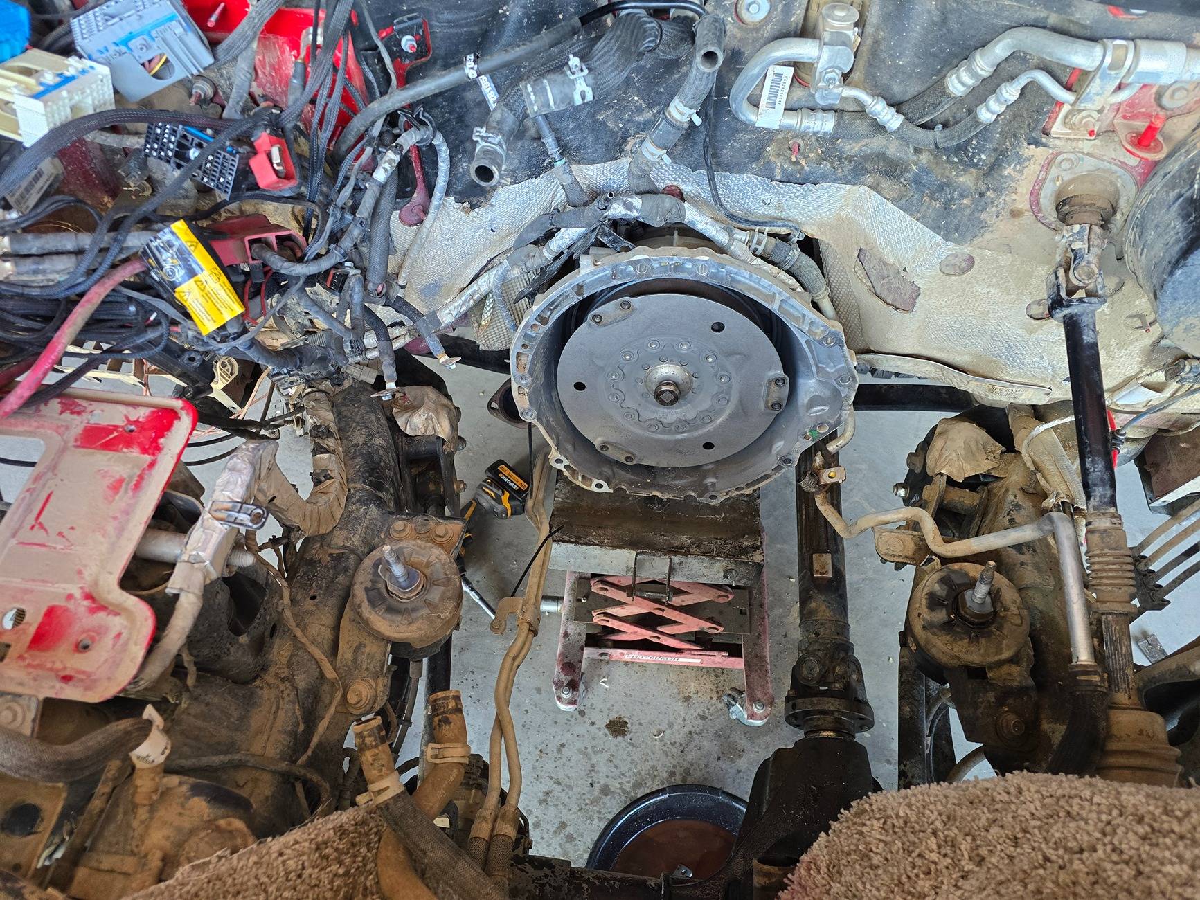

Removal /install tips -

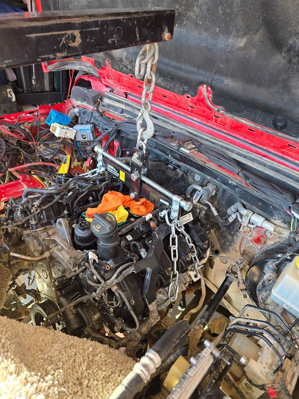

The load leveler on Amazon works fine for pulling the motor. You don't need special brackets. BIG RED AT32100BR Torin Engine Hoist Shop Crane Accessory: Steel 3 Position Engine Leveler with Adjustable Handle, 3/4 Ton (1,500 lb) Capacity, Black https://www.amazon.com/dp/B0BKZPLZCQ/ref=cm_sw_r_apanp_VQ6uMo5ZmVkLC
Thanks Minty for this one- wish I knew before! To get to the bolts in the back of the motor (which are a BISH!!!!), raise the motor part way and remove the mounts. Then lower the motor/trans together. You can get a lot of access this way. Do the same when reinstalling.

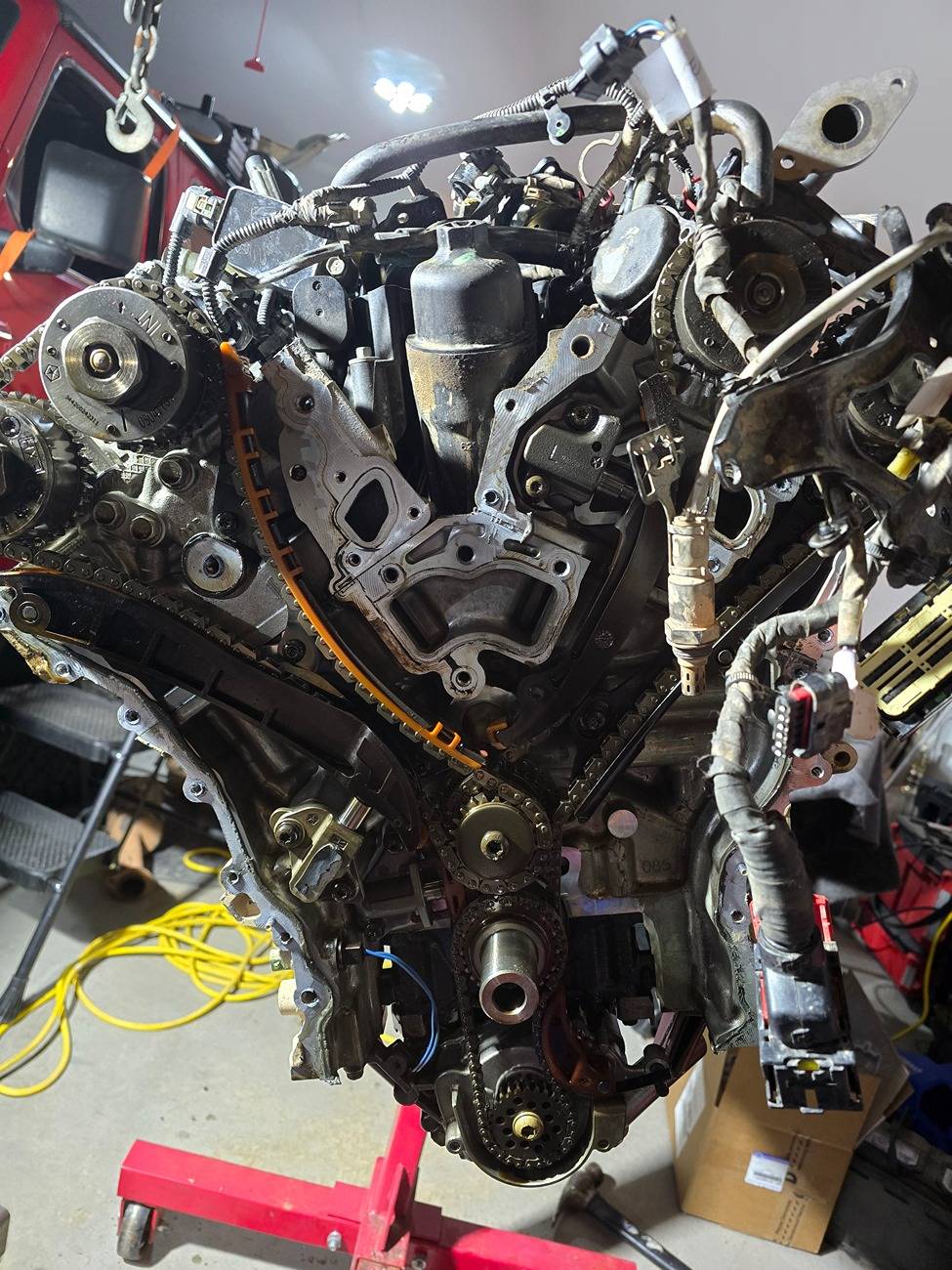

Careful if you flip the motor to put the oil pan on- it's *extremely* top heavy.
Get some allthread about 5" long x 2, and thread one on each side of the trans to give you extended motor guides to help you line up the motor when installing.
Make sure you line up the torque converter holes to the flexplate holes as you put the motor in. If you don't, you'll regret it. Ask me how I know.

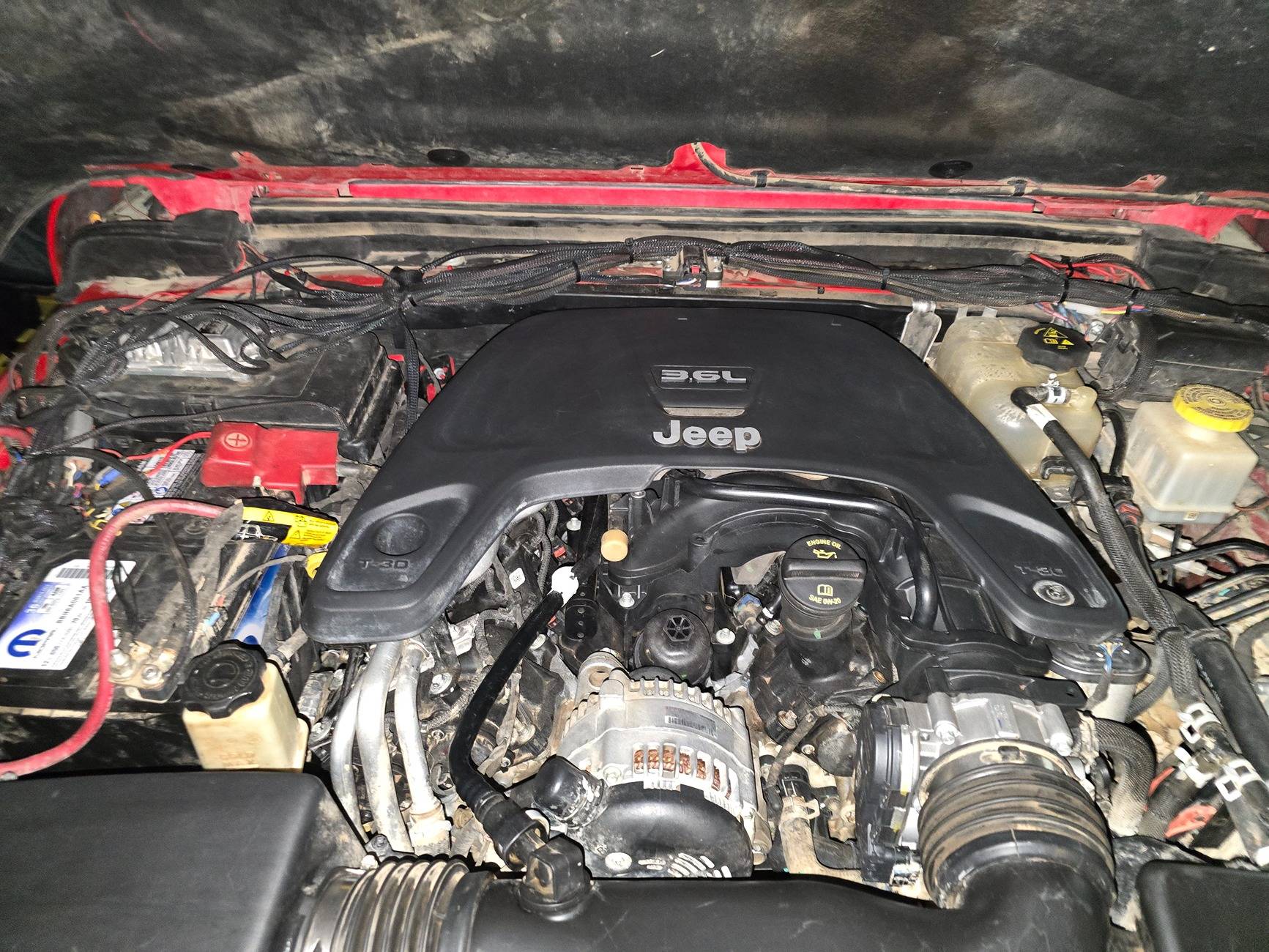

I couldn't find a tool to build oil pressure before first start, so I used the starter.
Before installing, I filled the crankcase and jumped the starter to turn the oil pump.
After installing, I cranked it over with my foot to the floor for a bit before letting it start on its own.
I used AlfaOBD to check codes and run crank relearn, but nothing else was needed like PCM or ECU programming.

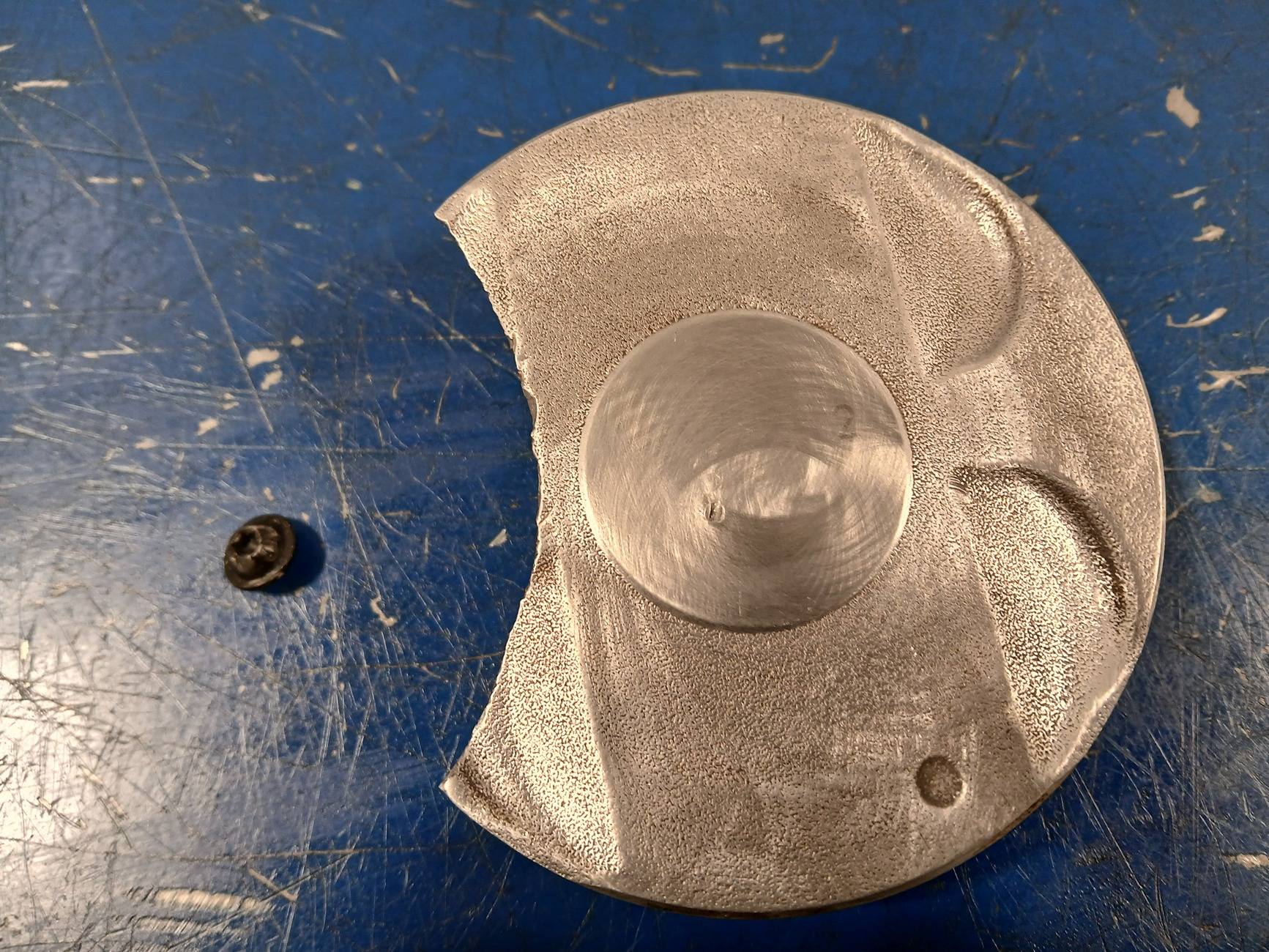

Here is why you replace the upper intake after a catastrophic engine failure. The T25 Torx head screw was stuck in the upper intake manifold, it did not rattle or give any sign of being in there. The piston broke up before the engine fired up. I was able to just replace the one piston and rod assembly and save the engine. Replacement of the upper intake manifold would have save a lot of work.
Damn!
I only had a burnt valve which appears to have mostly ended up in the cat, and we scoped the plenum for giggles and didn't see anything. However, I went ahead and bought a new one just in case.

Also, what catastrophic engine failure did you have? I see you have a broken piston, but what cause the screw head to get in there?
