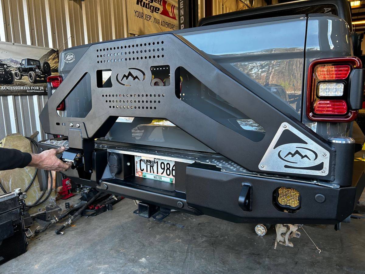

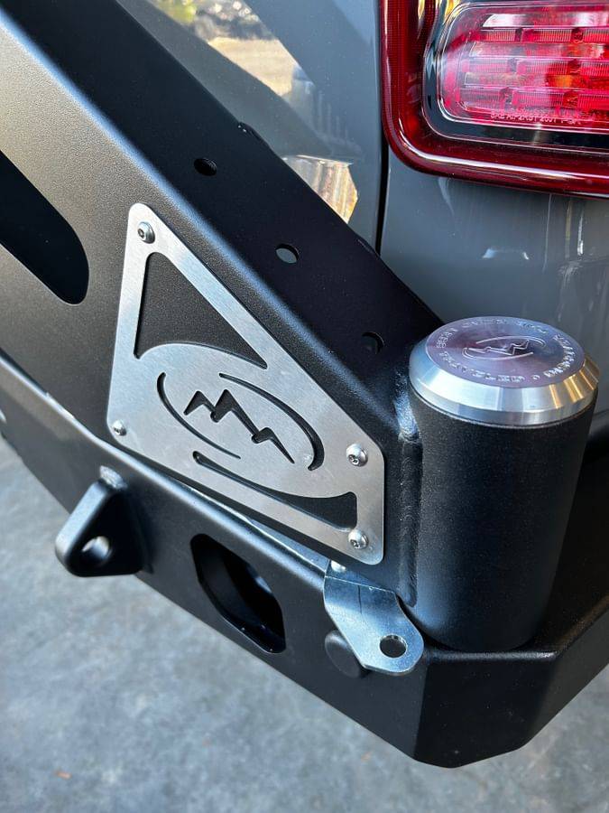

That is the S3 (single swing version) for the JT from ExpeditionOne. The bumper and swingarm are insanely beefy. Sadly, it's also insanely 'spendy' - looked at it for a long time, but finally pulled the trigger when they had free shipping around Valentine's day 22. Expect a long wait if you order.. like 6 months! But it finally arrived in perfect condition, and very well packaged / protected.
https://www.expeditiononestore.com/...es-Rear-Bumper-wS3-Carrier-System_p_2265.html
Hey there Mark,
Don't mean to be snooping but I happened to do a search of the Expedition One bumper and came up on this post. I have been eyeing this for the past few days since its 20% off and a $100 shipping credit, and am thinking about pulling the trigger.
Do you have any additional pics of the bumper mounted? Thank you!
- X

Hey there Mark,
- X

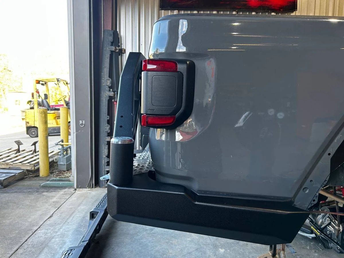

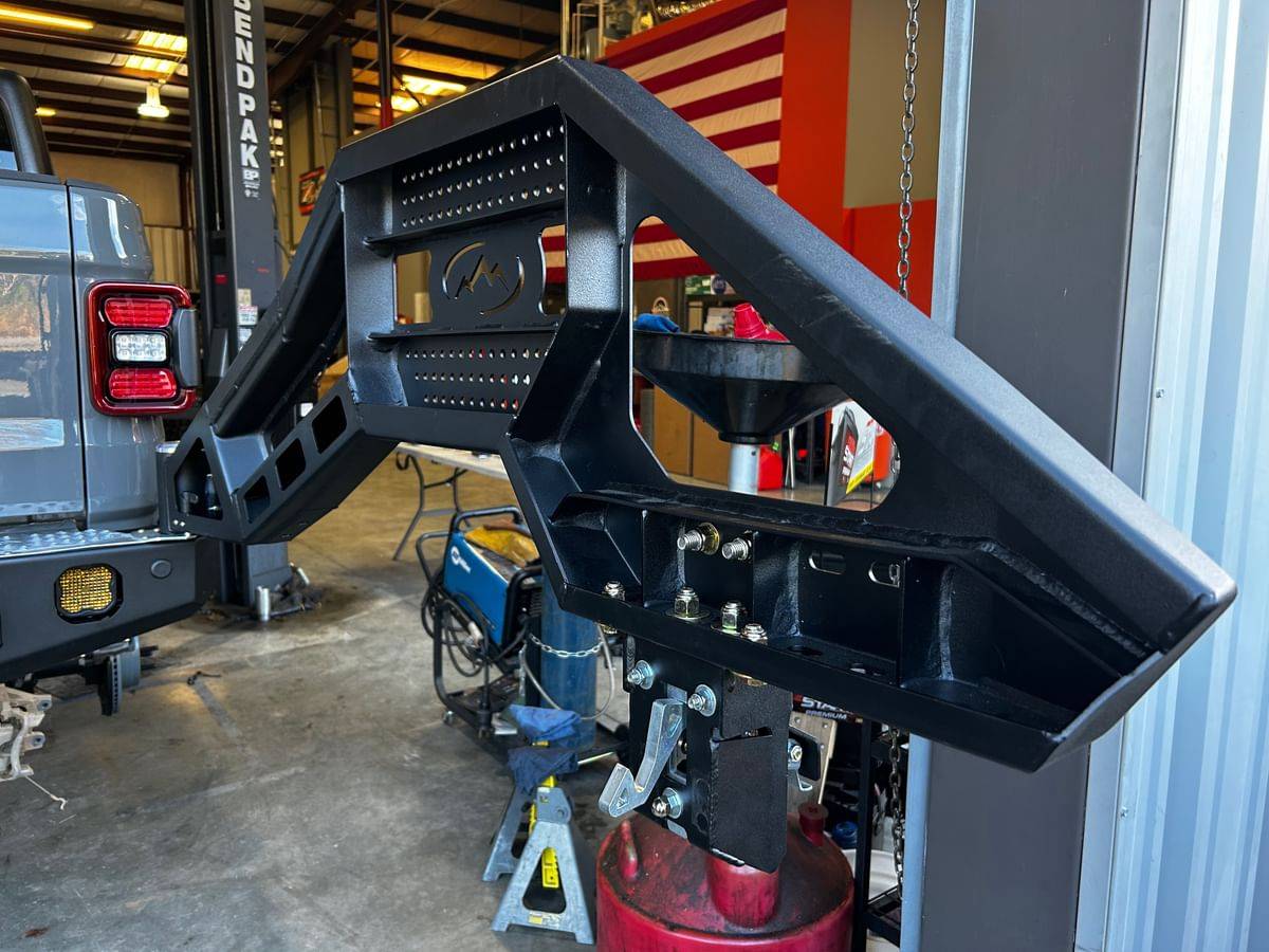

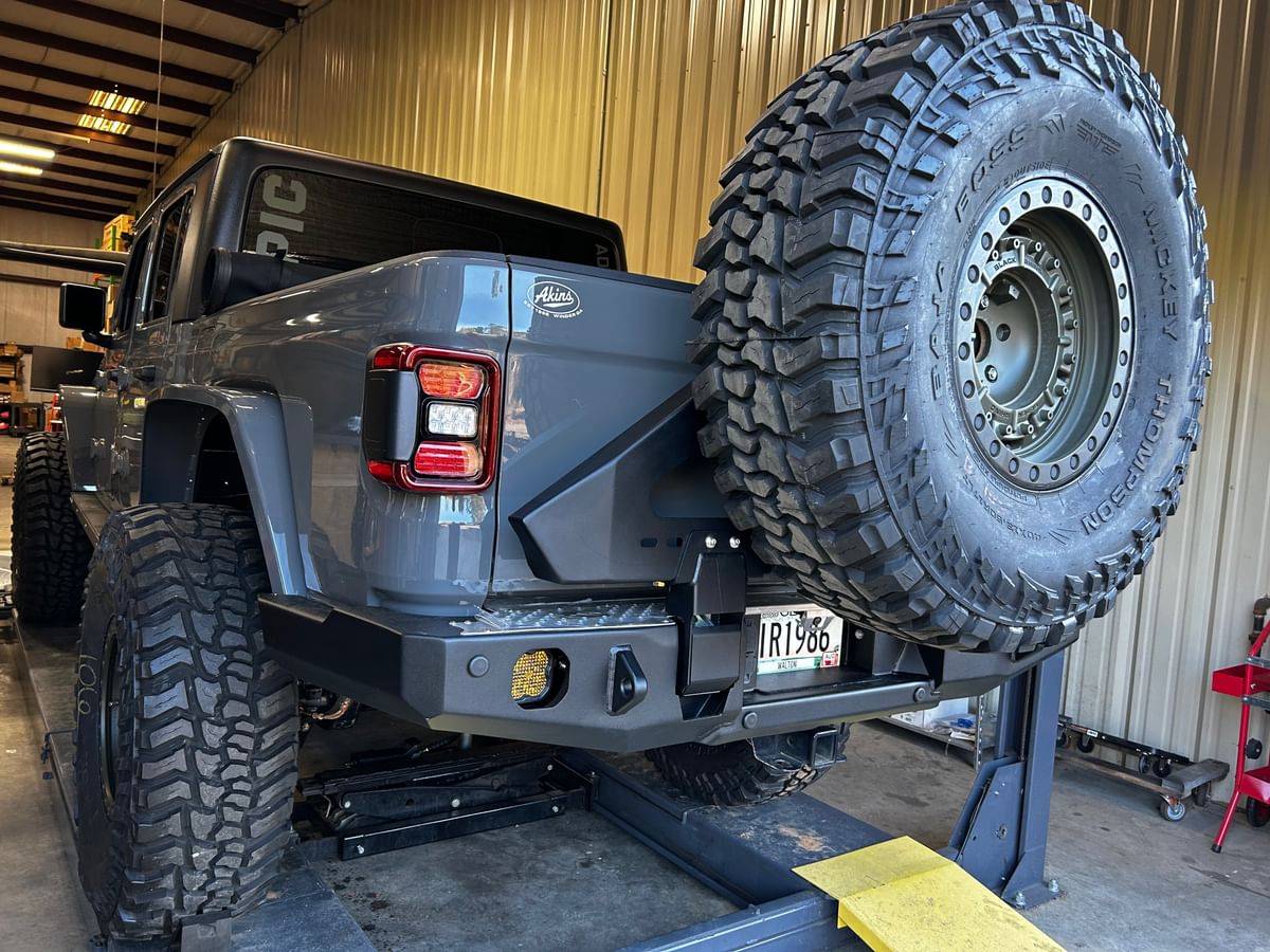

Hello Seg - sorry for the delay, hope I'm not too late here.. had to dig up some pics from my work machine. Hope they help :)

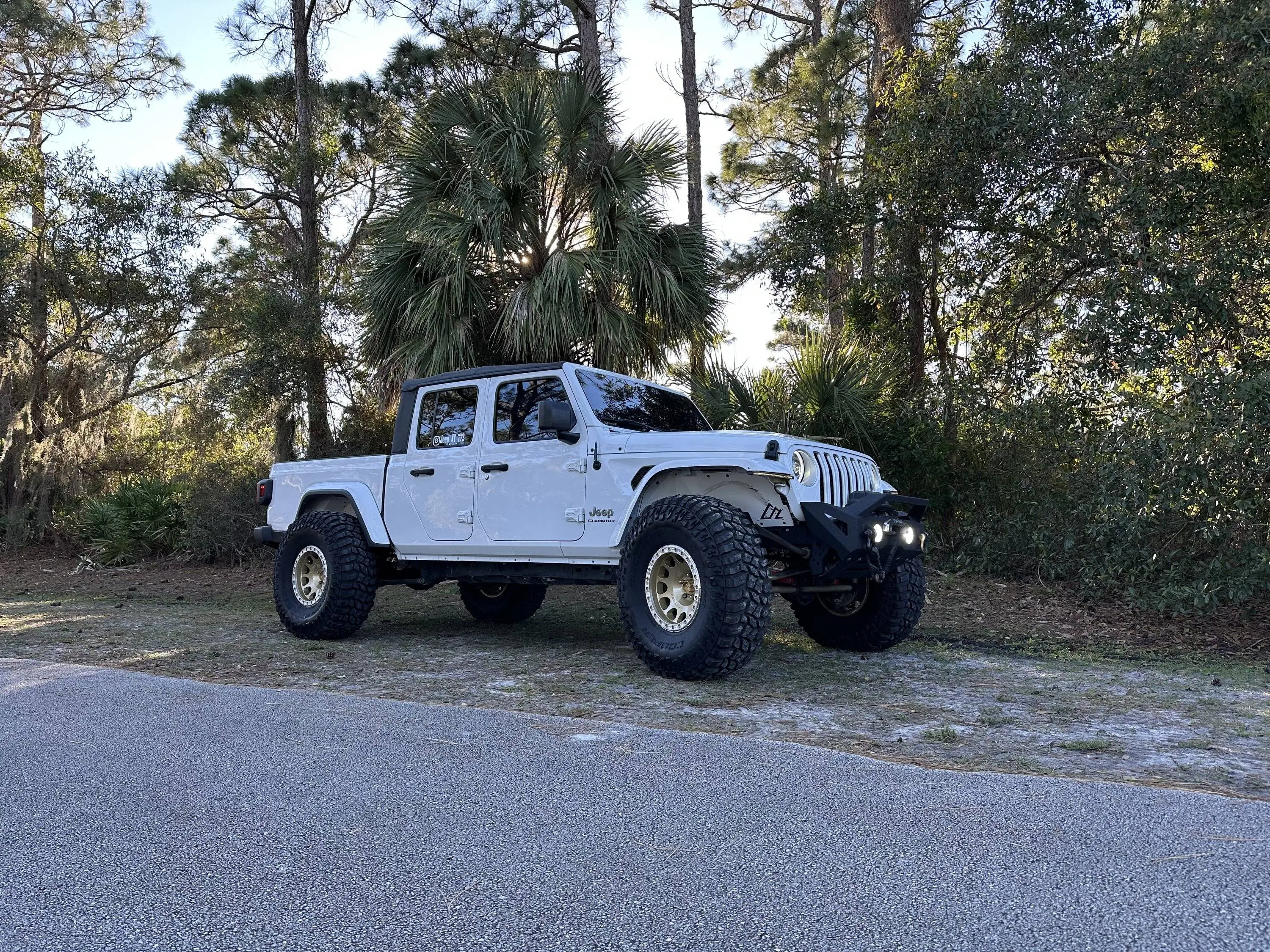

One of the earlier builds we worked on while testing our 3.5" system with 40s a few years back!
Is this with the stock standard width axles? Looks like a sport from the grill and rear bumper, but with the rubi flares? How much backspacing did you have to run to not rub if they are the standard width axles? Thanks!
Yes! Standard axles, aftermarket flares, 4.75" backspacing with our kits :like:
Hey Mark!
No worries! Thank you so much for the pics! This is on my shopping list now, hopefully the ol' lady signs the permission slip for the purchase.......
Thanks again!

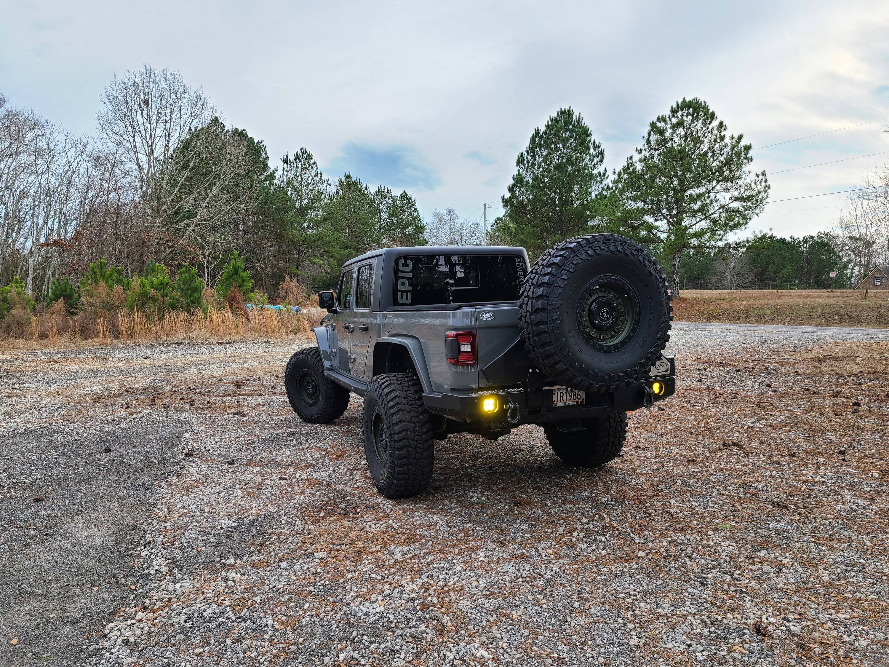

Brother that looks unreal. Can we get some side shots of that beast? I have the same RSE sliders and wanting to do the nemesis flares to make room for (cough cough) 42s or 44s when Mickey Thompson finally releases the new tires. I have been hounding them for almost a year now with no release date. Just looking to see how the flares flow with the sliders. Thank you.

Thank you @Blackdmax15
My steed is in the shop having a couple things done, unfortunately.. or else I'd go out on the driveway and snap some more pics. I was able to dig up this one from the side [before I did the maximus-3 roll bar and cargo deck] but you're looking at the 'flow' of the Nemesis fenders w/ the RSE steps/sliders I think they are spot on man! I was initially concerned how that would look as well, but just chose to trust my shop and see how they came out. Totally happy.
*supposedly my phone has one of the best cameras out there, but still I manage to snap off horrible pictures.. hopefully if you zoom in on this you can see. It's like those flares were meant to be coupled with the RSE sliders.
