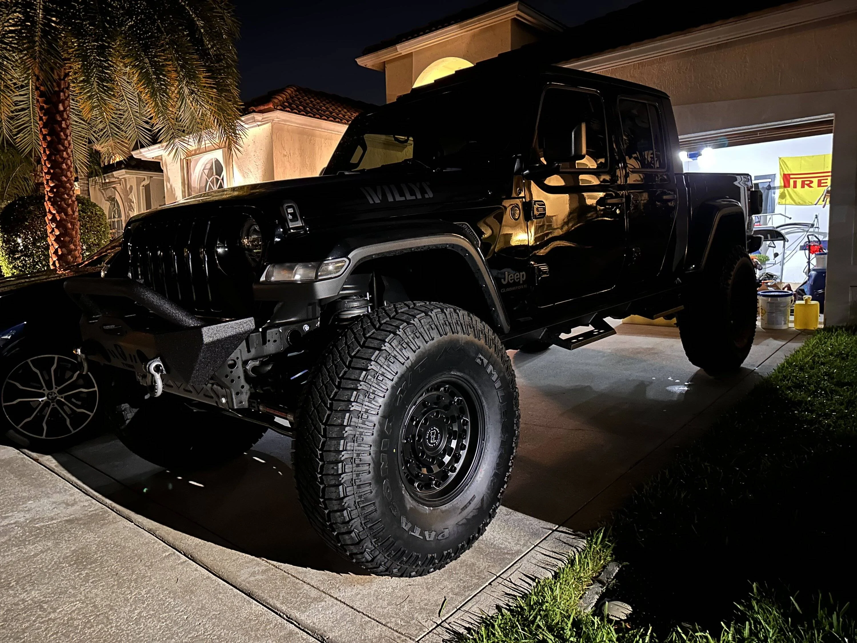

Here’s a few of mine. 45k miles on the Patagonia’s. The 13.50’s tuck nicely without rubbing.
What is the width and backspace on your wheels?
