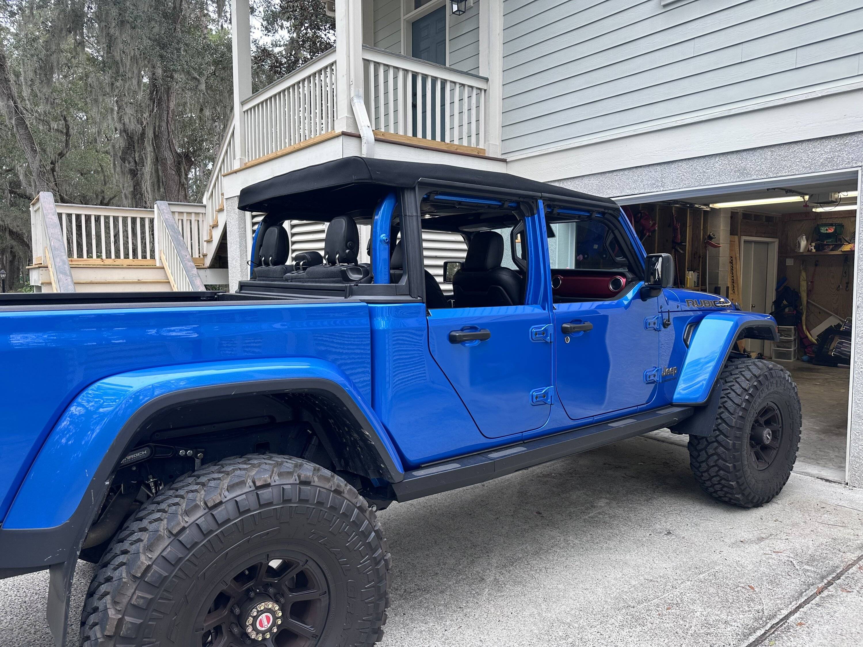

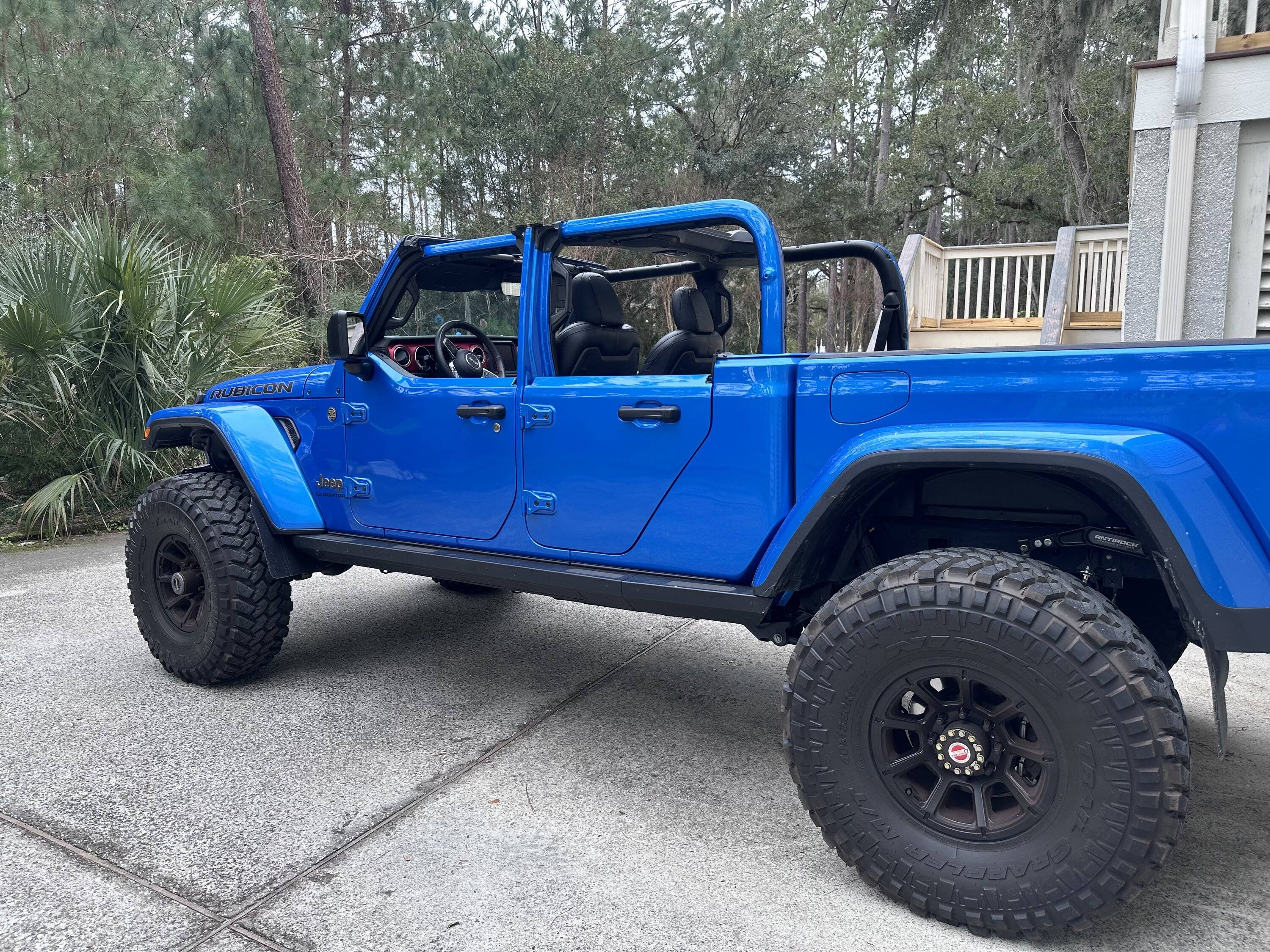

My steed is in the shop having a couple things done, unfortunately.. or else I'd go out on the driveway and snap some more pics. I was able to dig up this one from the side [before I did the maximus-3 roll bar and cargo deck] but you're looking at the 'flow' of the Nemesis fenders w/ the RSE steps/sliders I think they are spot on man! I was initially concerned how that would look as well, but just chose to trust my shop and see how they came out. Totally happy.
*supposedly my phone has one of the best cameras out there, but still I manage to snap off horrible pictures.. hopefully if you zoom in on this you can see. It's like those flares were meant to be coupled with the RSE sliders.

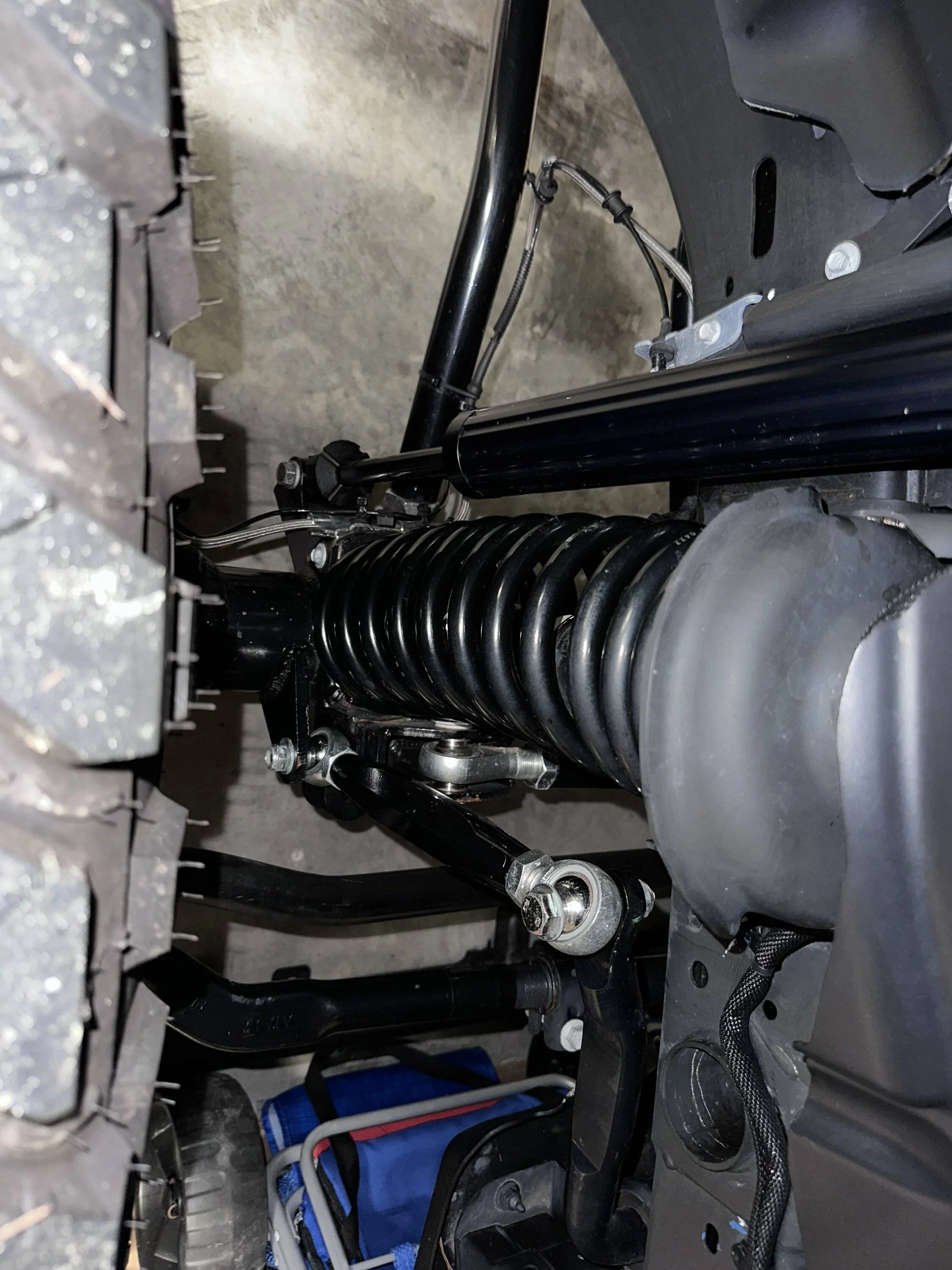

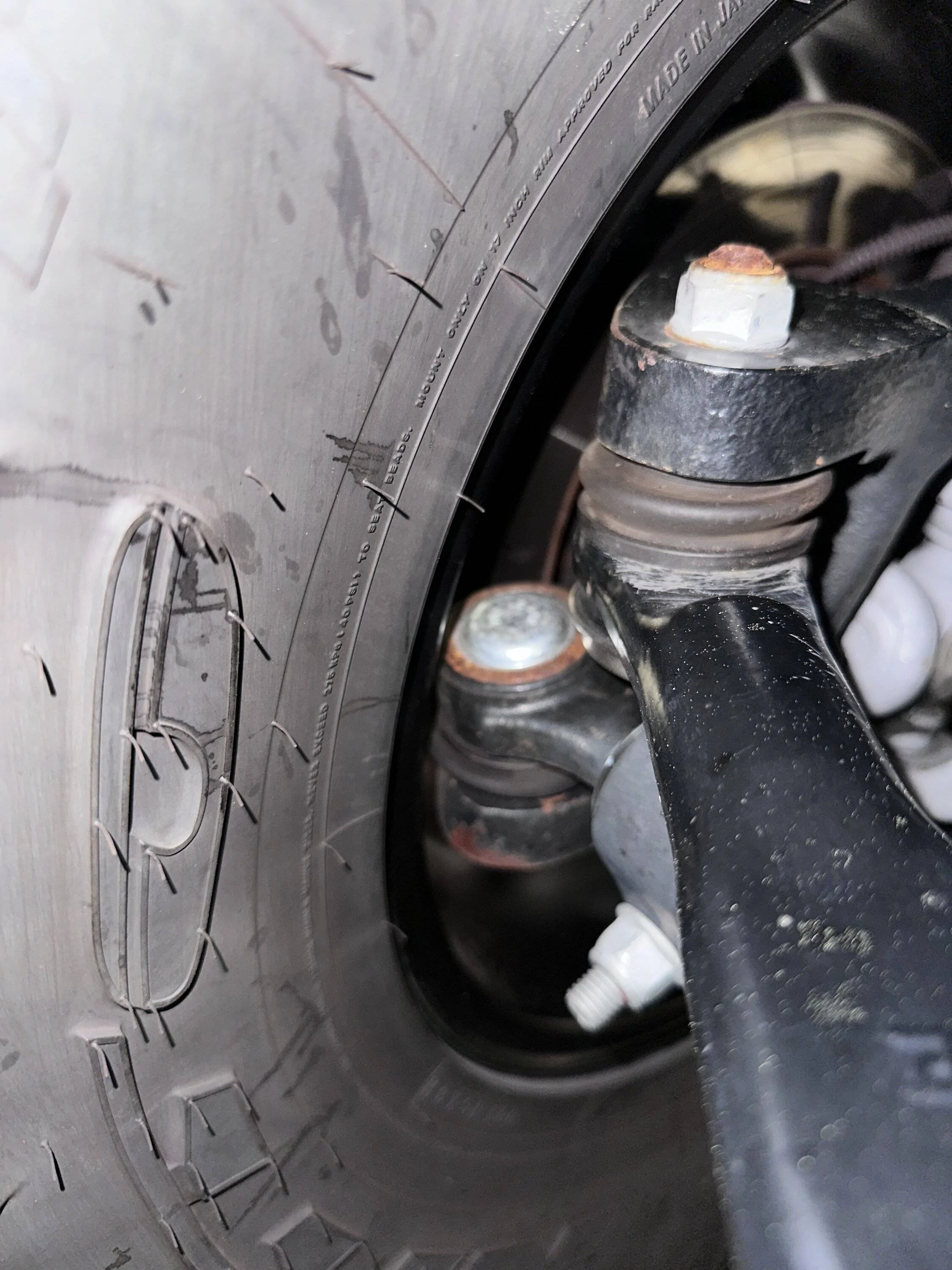

good timing on this. I just posted a thread on my next jump id love for you to jump into the discussion mine is a diesel as well. Motobilt convinced me that I wanted 4.88s for my specific goals. I almost jumped on a set of dynatracs I found for a good discount by they were only 68" wide and im trying my absolute best to run high offset for turning and scrub.

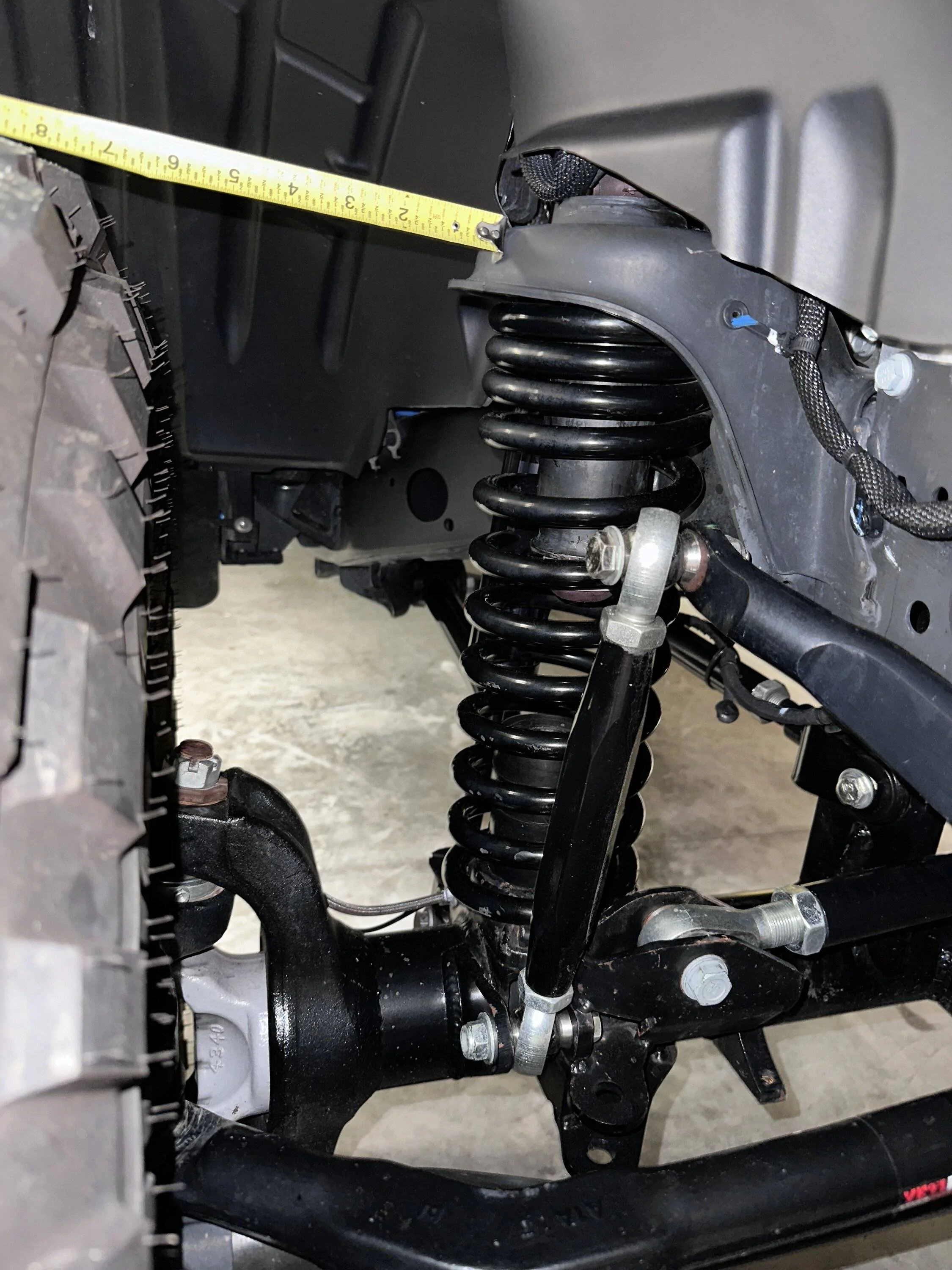

RK was pretty concerned I might have contact if I went with an offset like yours and did their front coil over. how close as the tire to hitting fender or control arms?

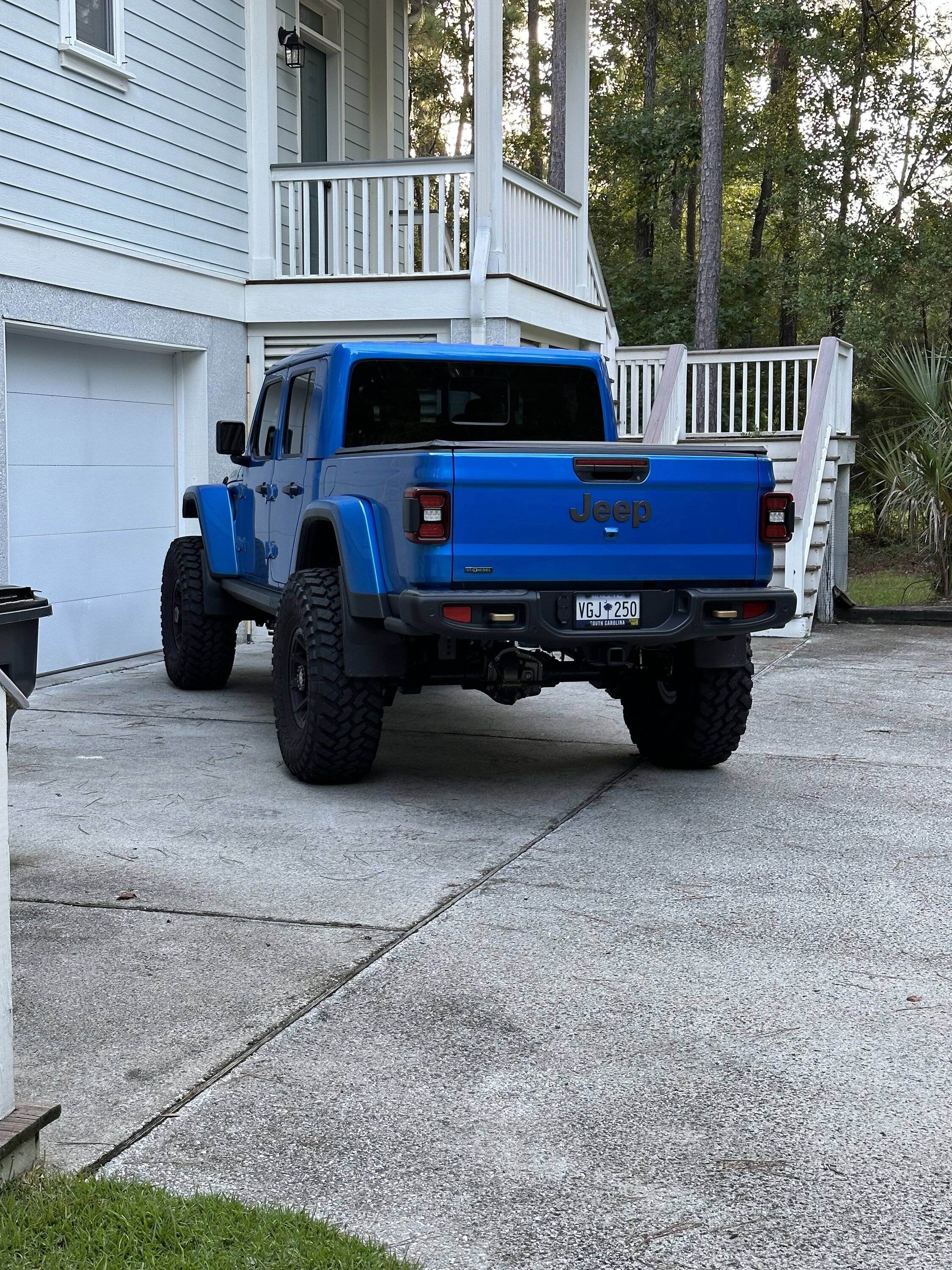

They may be correct and these pictures aren’t great as I just ran downstairs in my garage but there is a ton of room. Again the knuckle is tight and I would probably do 5” or 4.75” backspacing next time, but I didn’t want to be mega wide.

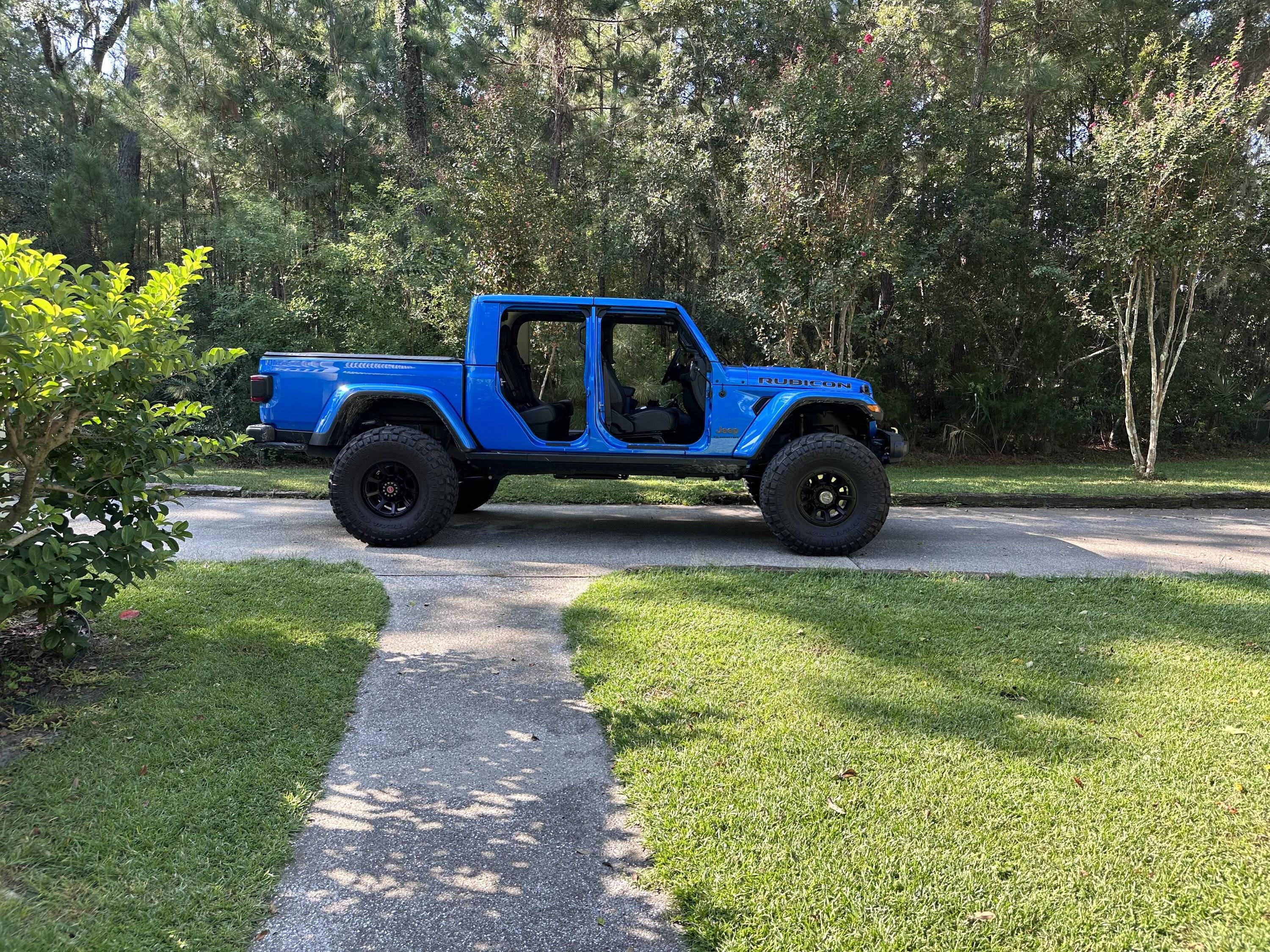

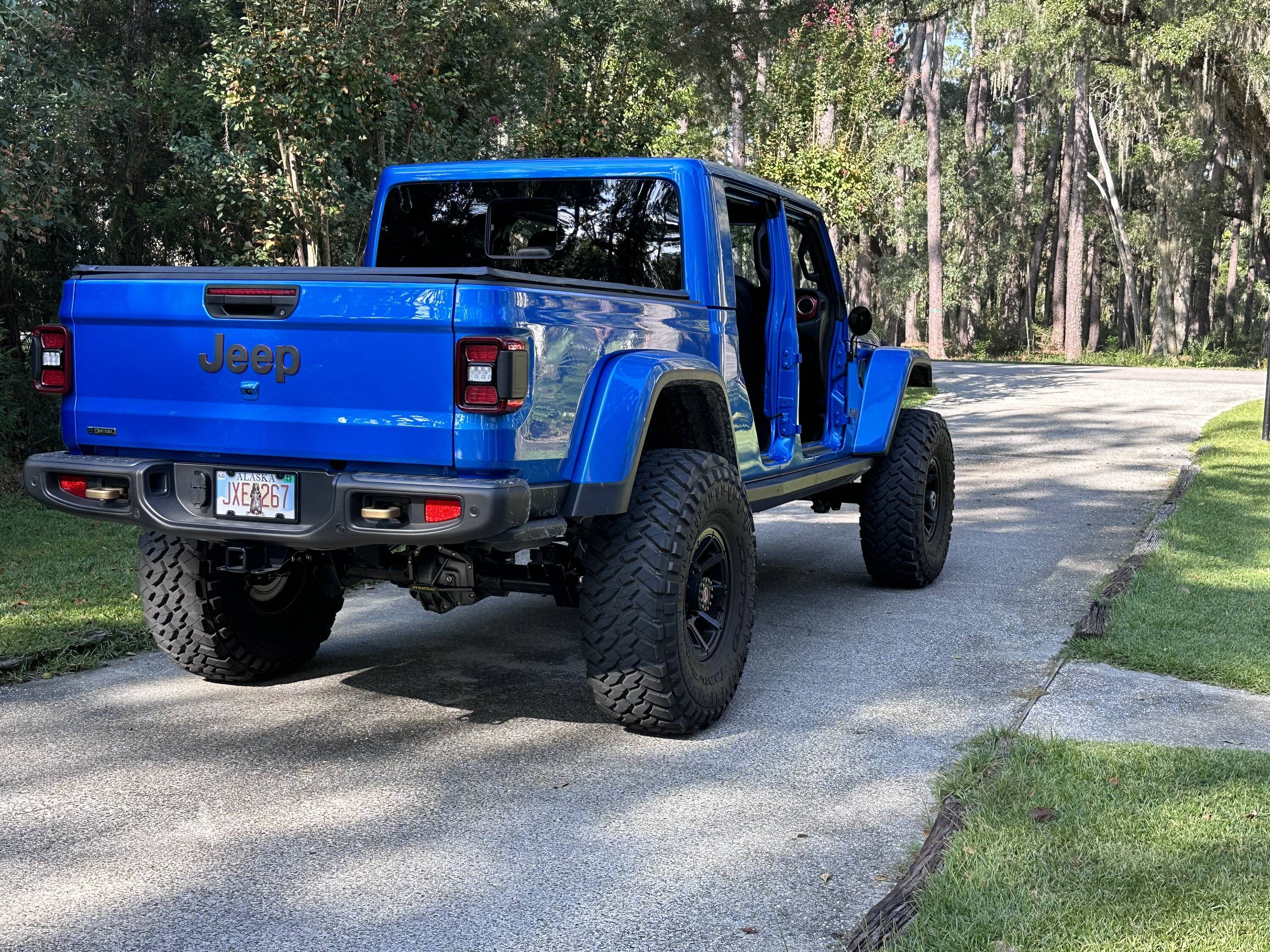

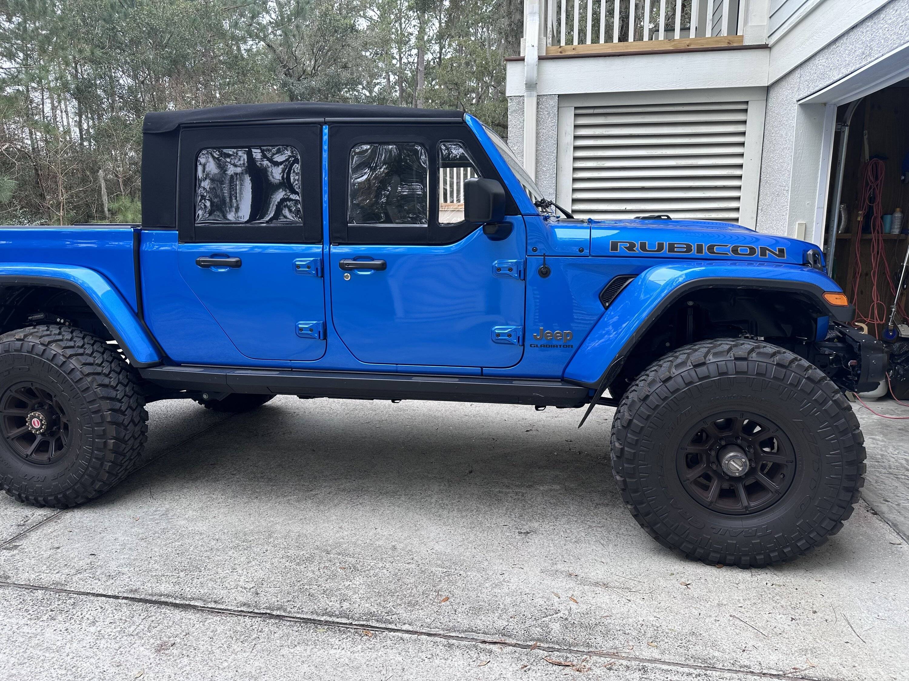

And since this thread is about showing off 40s etc here are a few more glamour shots.
Jeep Gladiator Let's see your 40" Tires! IMG_3074
Jeep Gladiator Let's see your 40" Tires! IMG_3079
Jeep Gladiator Let's see your 40" Tires! IMG_2727
Jeep Gladiator Let's see your 40" Tires! IMG_1864
Jeep Gladiator Let's see your 40" Tires! IMG_1863
Jeep Gladiator Let's see your 40" Tires! IMG_1283
Jeep Gladiator Let's see your 40" Tires! IMG_3084

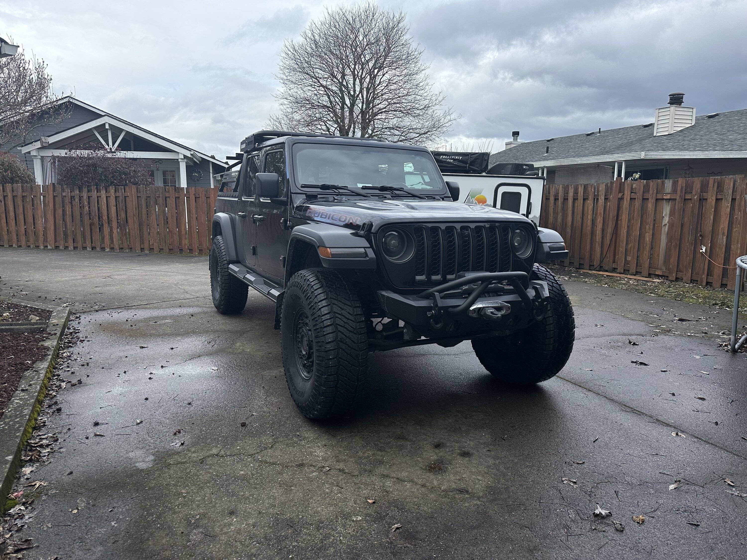

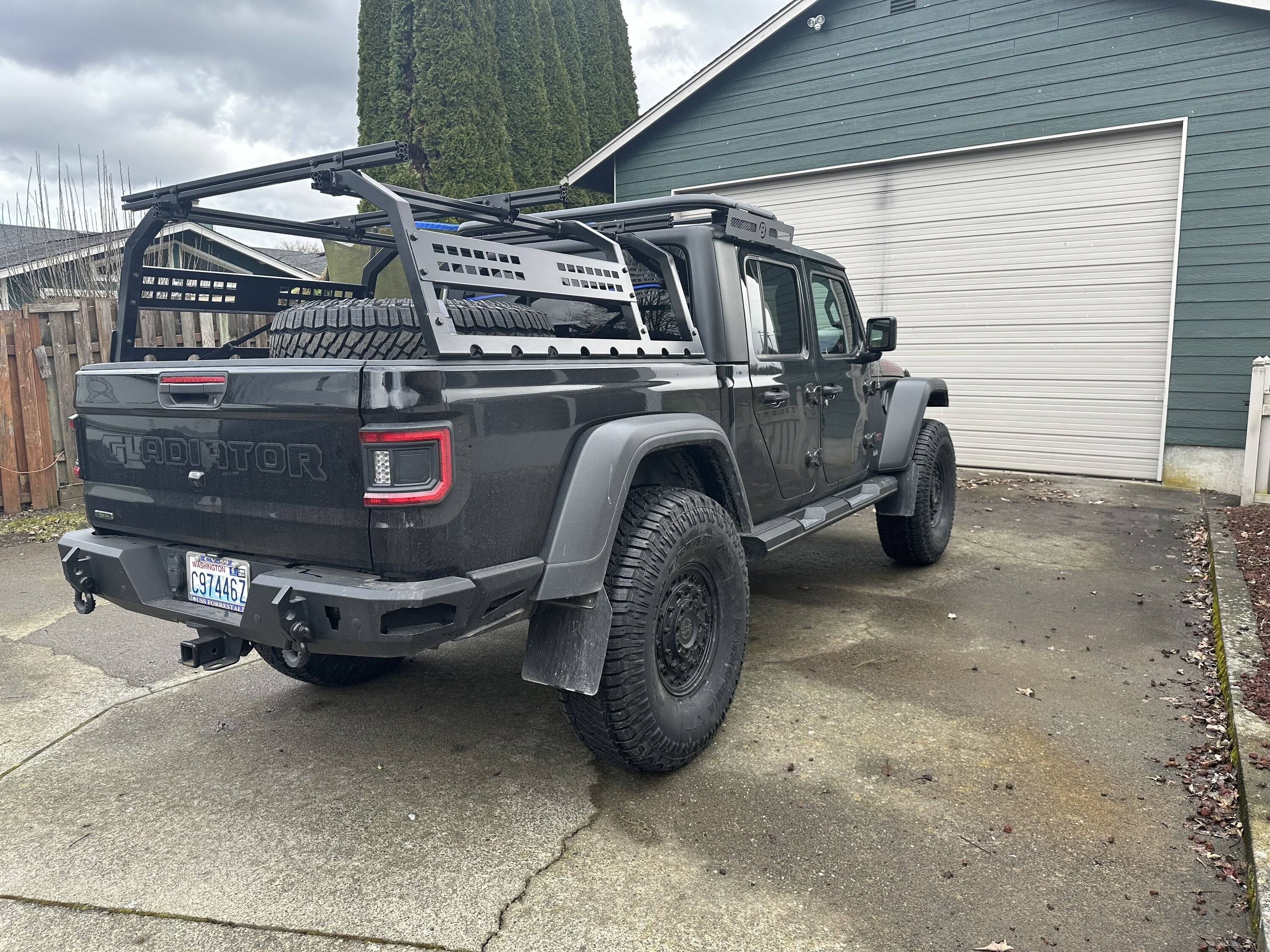

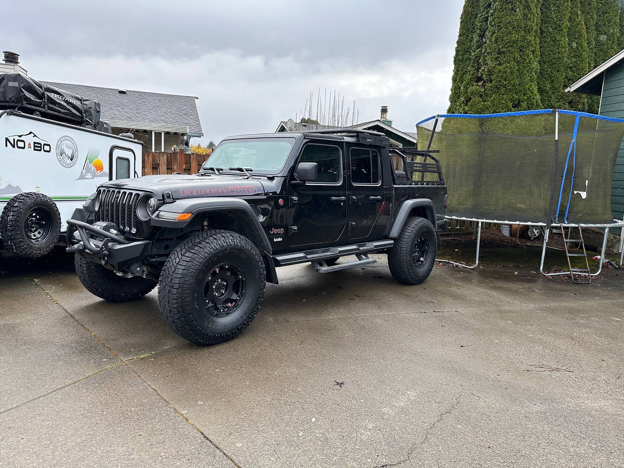

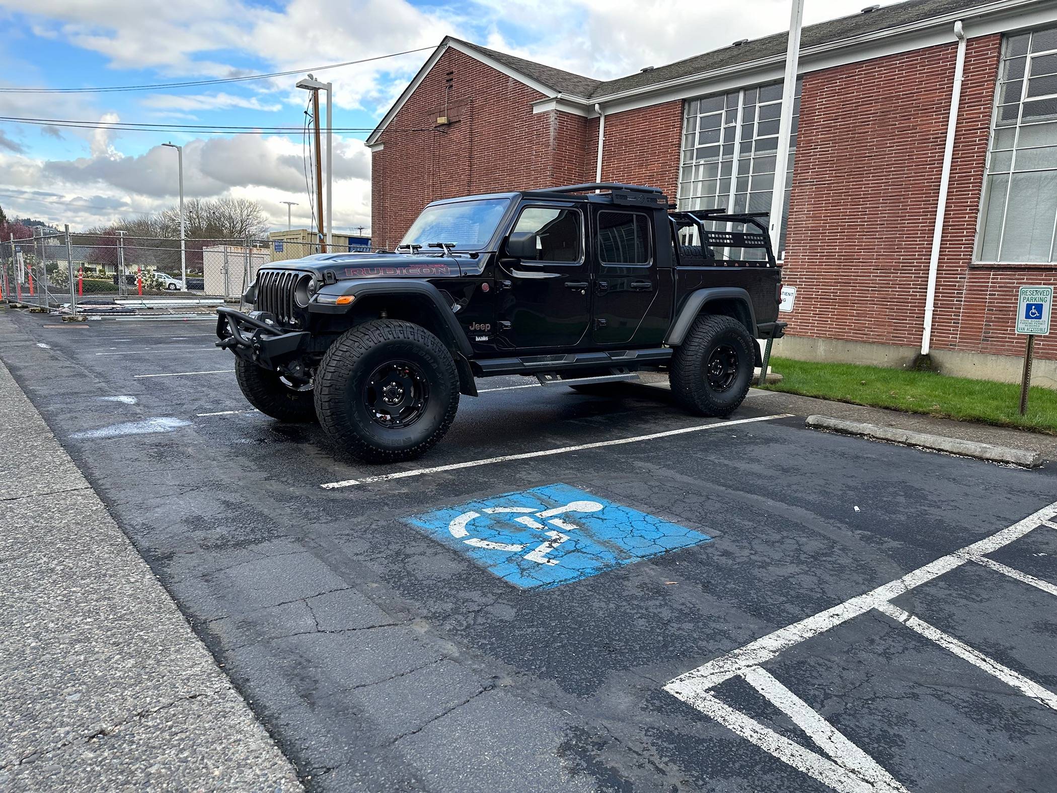

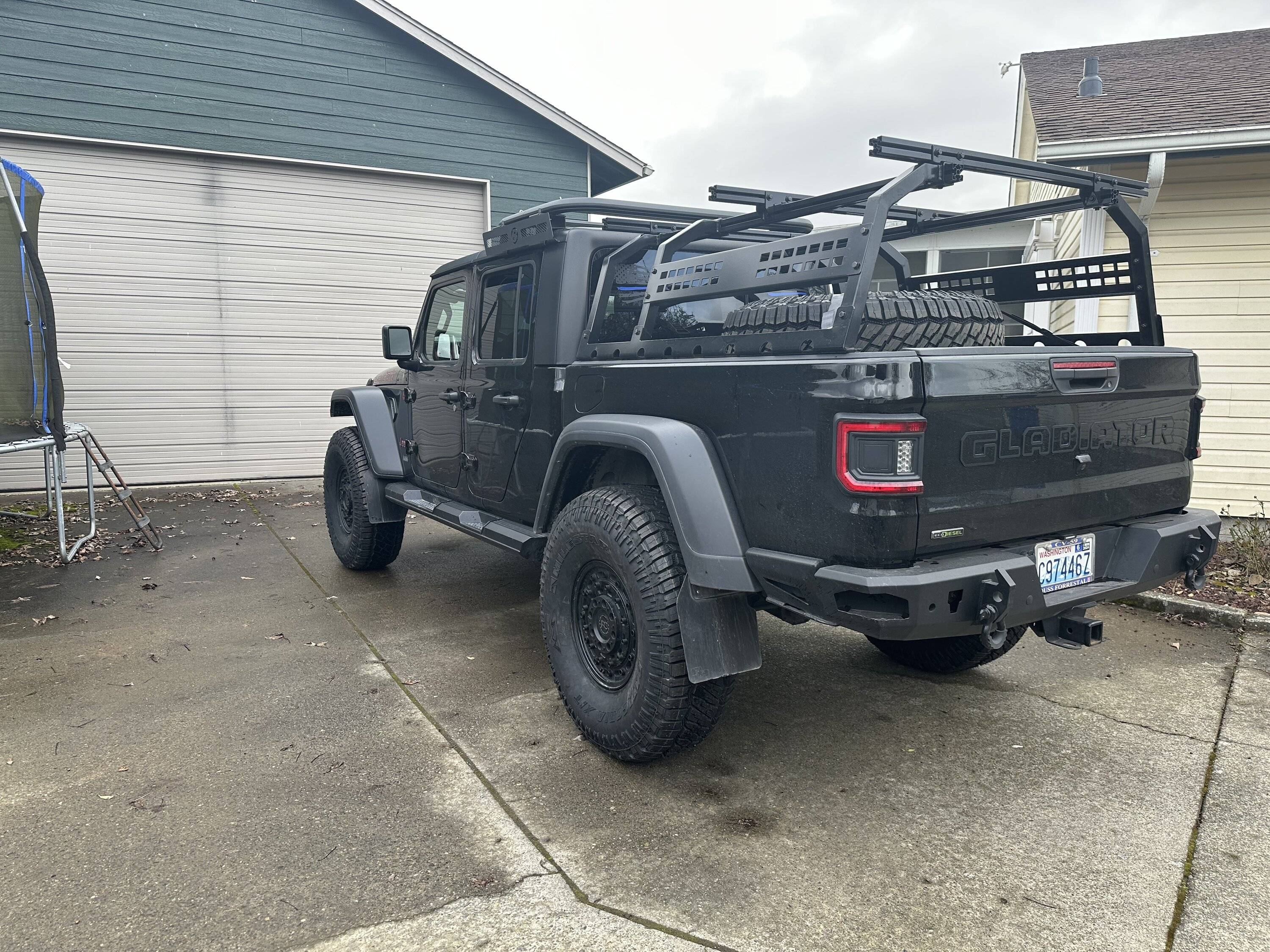

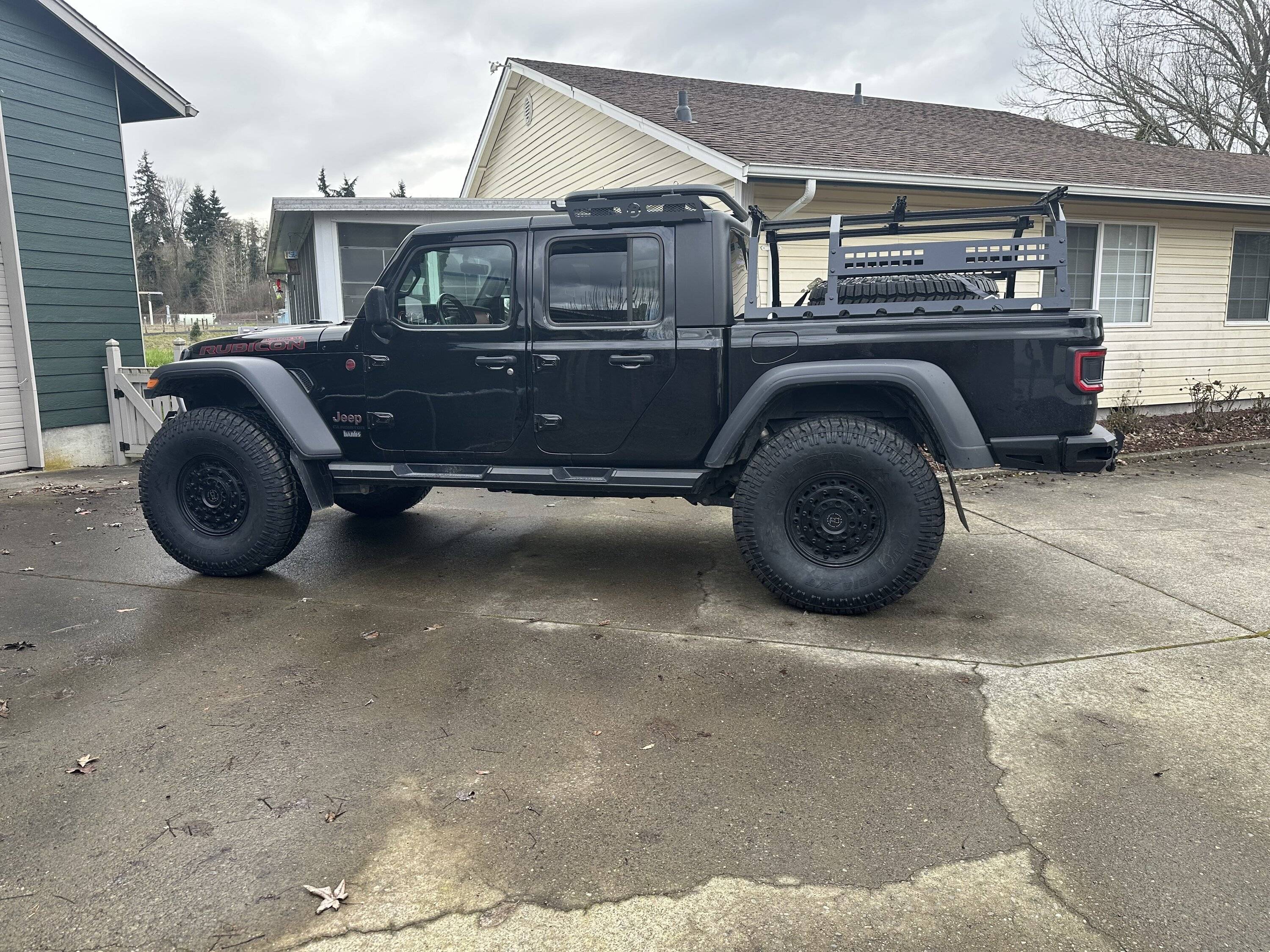

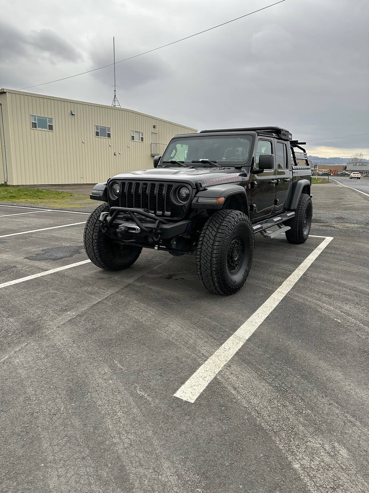

40” Patagonia XT installed yesterday on my JTRD, Black Rhino Arsenal 17x8 +30 offset. Plan is to keep as little offset as possible. Right now at full lock the tire barely rubs the lower control arm, never would have believed that, I was expecting it to rub bad. I’ll cycle the suspension and play with spacers and bump stops to figure things out. I really like my wheels but it’s only available in this size or the opposite extreme of a 17x9.5 -18 offset, I had the Armory in that size on my last JTR and I don’t really want to run that much poke if I can get away with something less. Probably not what most of you would do but I’m almost 60 and no extreme wheeling, just my daily and some overland camping. Had the 37” Falken AT3W and while a great tire they were just swallowed but the truck.

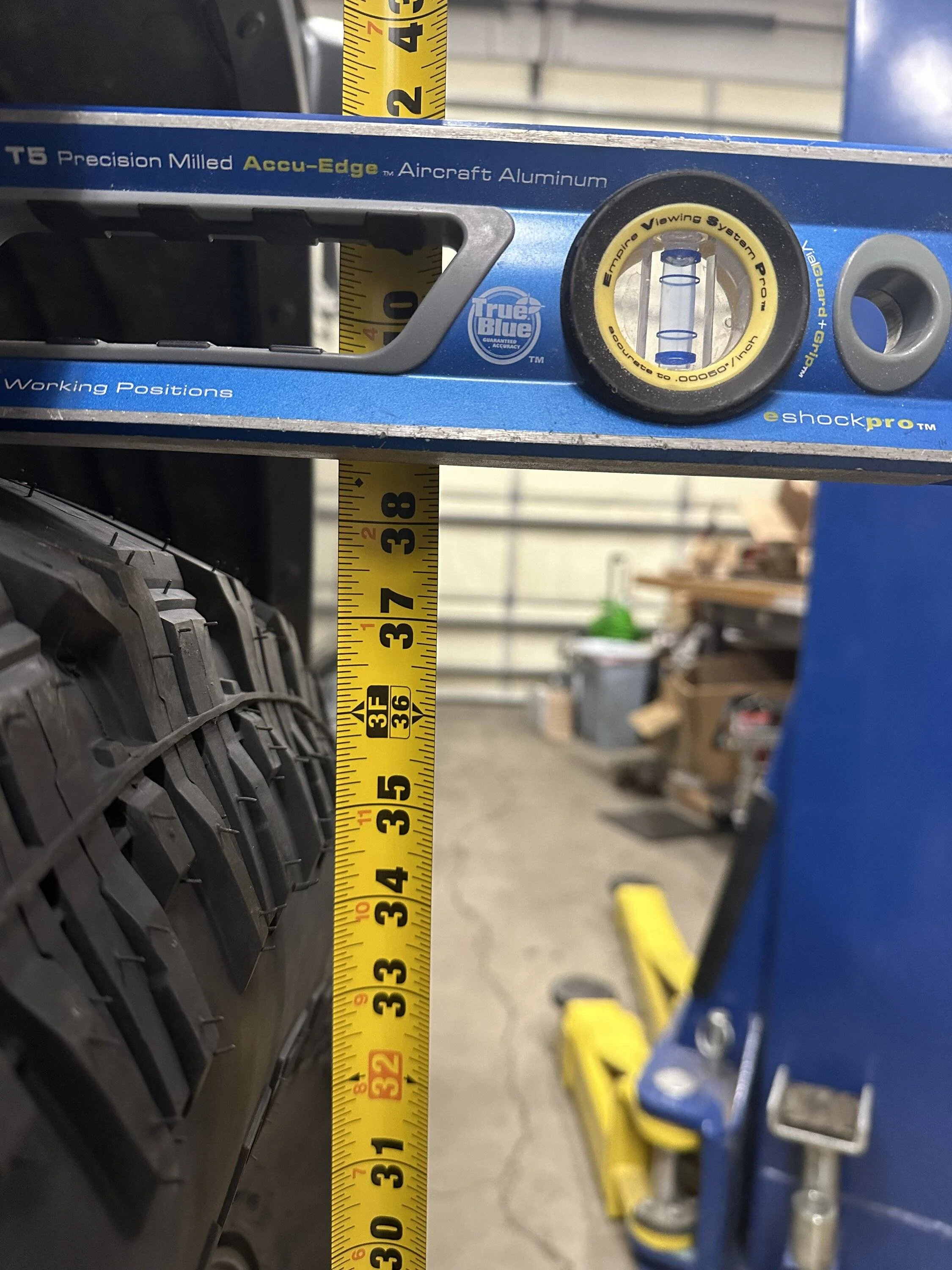

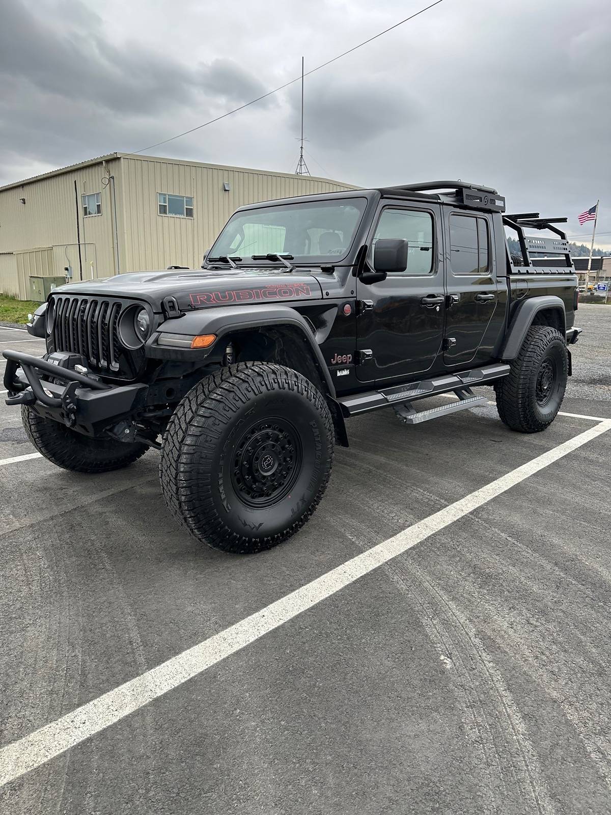

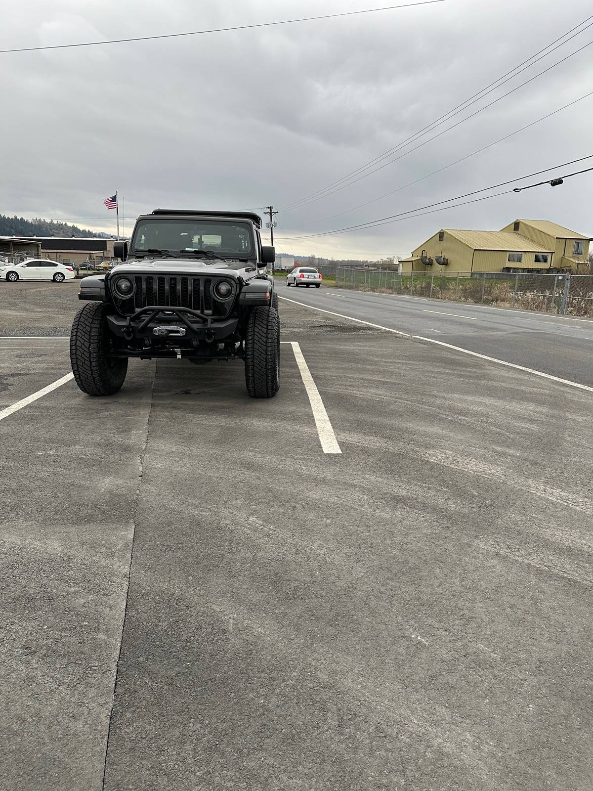

Do you happen to know what the actual diameter is on your JT?
I can answer that myself now. Just installed the same Patagonia XT 40”. Measures 38.5” on the truck, 39.25 off.

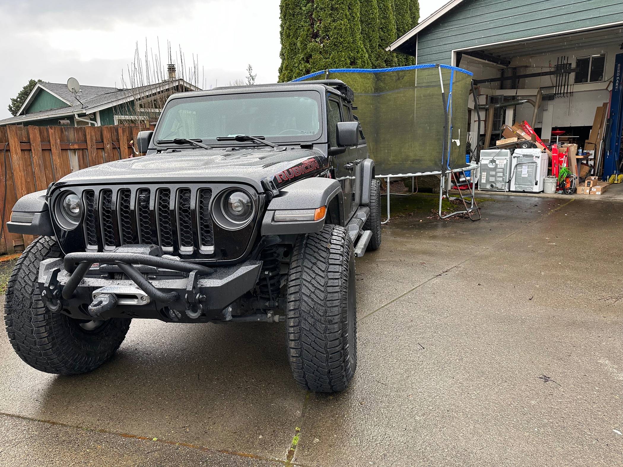

Well I already changed my setup, picked up a set of Teraflex Nomad wheels used, 18x8.5 0 offset. Figured I could have made the other +30 wheels work using MetalCloak lower control arms since the tire barely made contact with the own LCA but this should require less other mods and it’s not a terrible amount of poke. Thinking I might get a set of the Extreme Recon fender extensions.

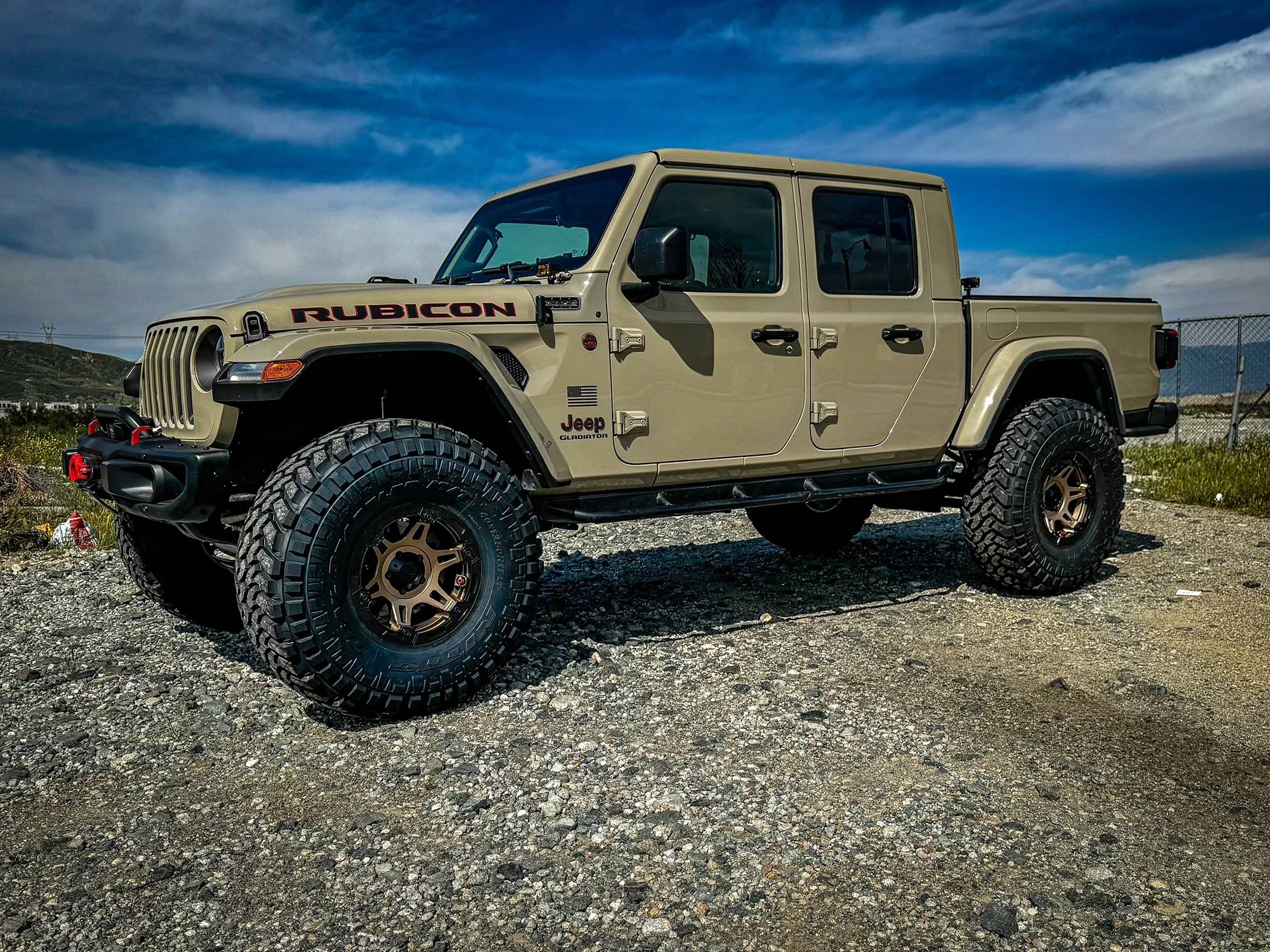

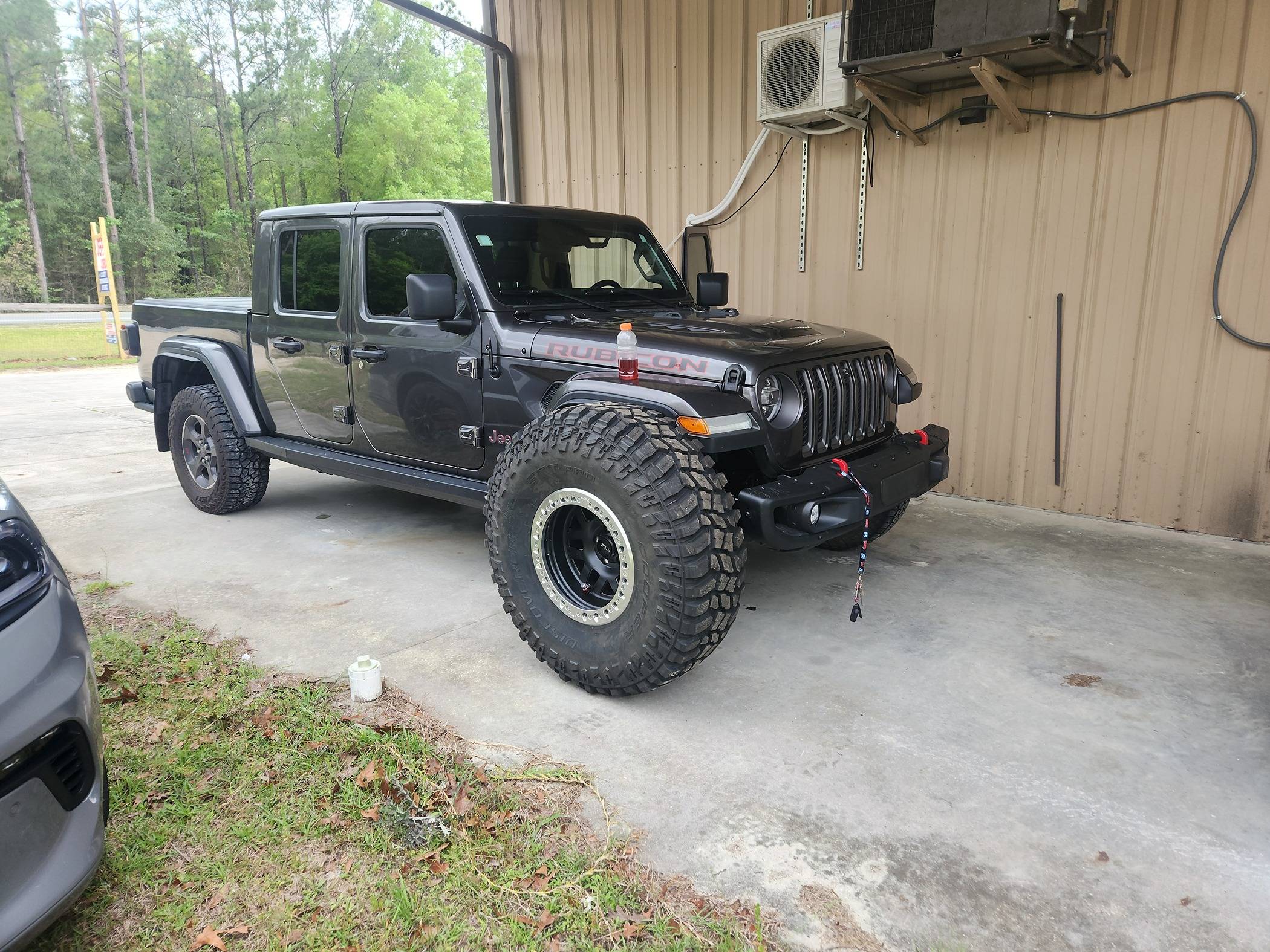

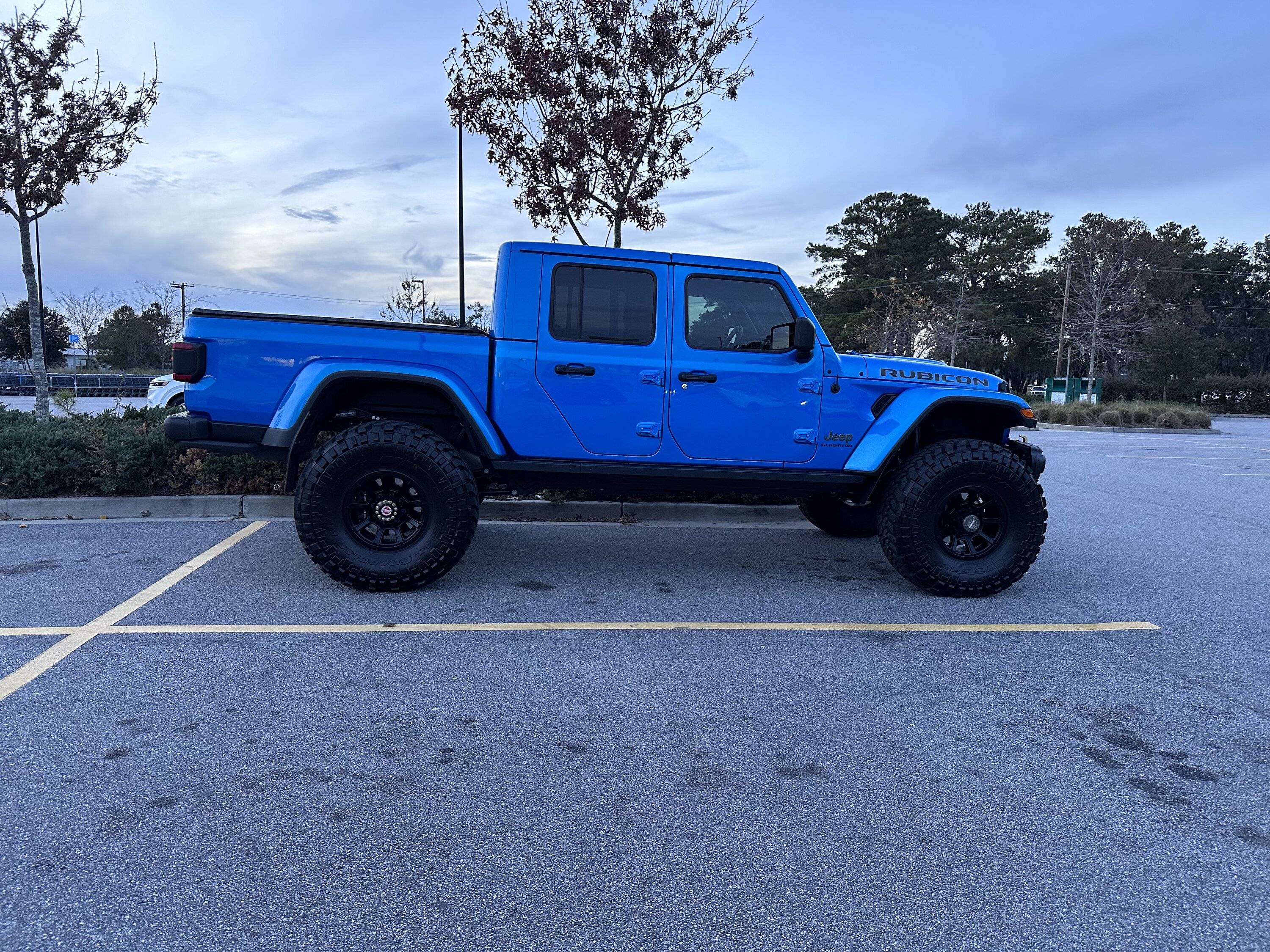

Bought this jeep a couple weeks ago and previous owner before me put the XR fender extensions on it already. My goal was to figure what offset/backspacing would put me right at the edge of those with some 38 or 40/13.50s on it. I was helping a buddy with his jeep and thought I'd do a 40inch comparison with his STT Pros. ?

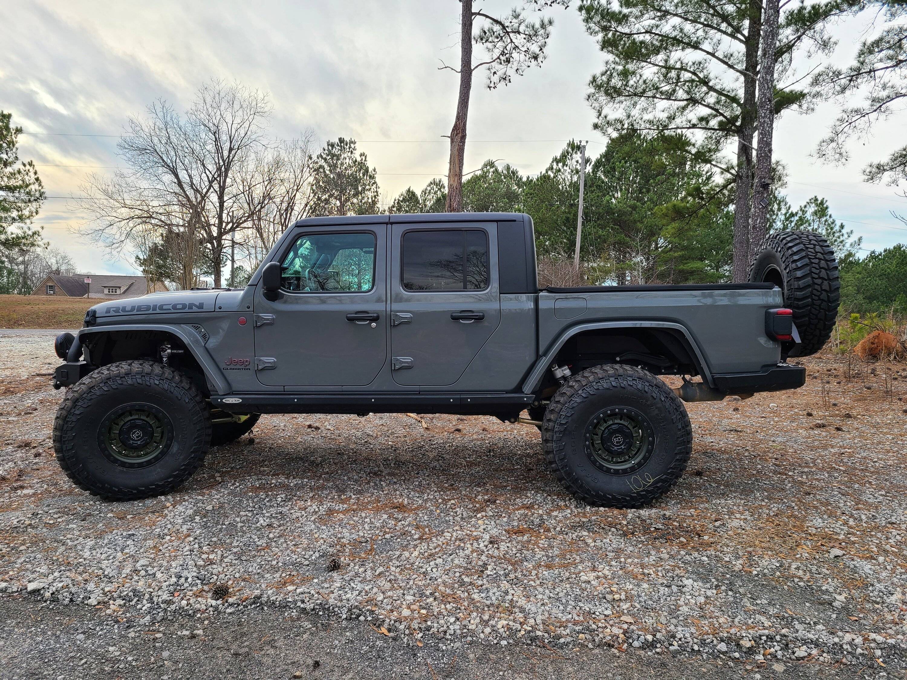

I took the leap yesterday. I chose to run Teraflex Nomad split spokes with a -12 offset after reading the positive feedback from a bunch of members here and so far really like what I see. Axles are getting the necessary treatment but still not sure what front inners to go with. So far the AAL ones are the front runners just seems like a lotta unnecessary coin. I felt the Paramount guys figured it out right with their very factory looking plastic one but it’s no longer available.
