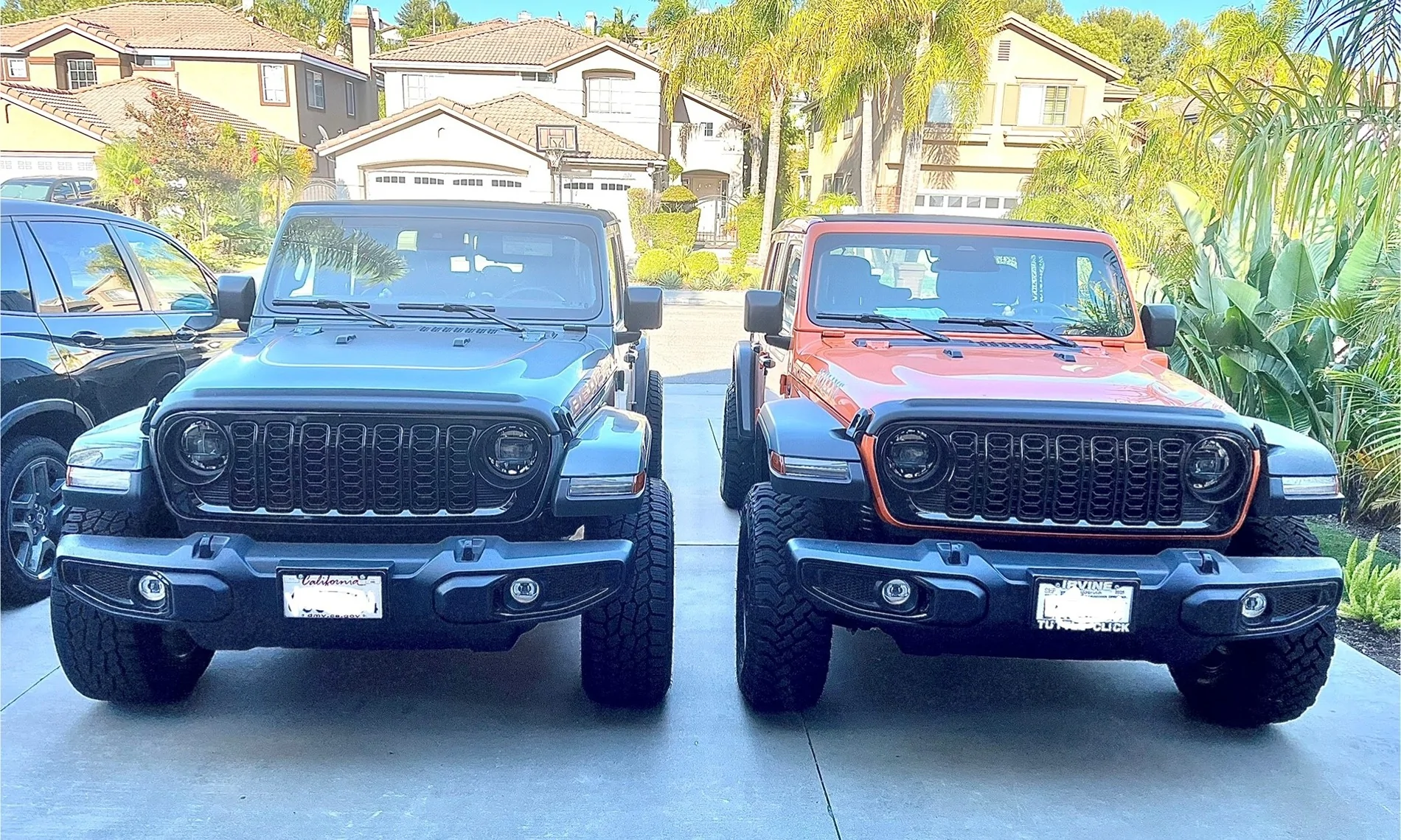

I think one point of awareness here is that the Sport S fenders accentuate the rake more than the higher Rubi/Mojave fenders. I know this first hand as my '24 Jeep Beach JT has the Sport S fenders and our '25 Willys JL has the higher Rubi/Willys fenders (the JL Willys fenders are the Rubi fenders - unlike the JT).
See the image below. Basically same front ends with 33" tires, but the JL fenders are higher. So I completely understand that you want less rake but don't want the "yeehaw" look of a butt squatting 1992 Toyota Pre-runner.
I've done a little research on this and basically a simple 1/2" or 3/4" Daystar (or equivalent) front spacer is what you're looking for (for a factory looking stance). There are several examples on this board. If you want a full lift, then there are more creative ways to accomplish less rake (as mentioned in previous posts).
I've done a little research on this and basically a simple 1/2" or 3/4" Daystar (or equivalent) front spacer is what you're looking for (for a factory looking stance). If you want a full lift, then there are more creative ways to accomplish less rake (as mentioned in previous posts).

Here is a better side-by-side comparison of the fender heights for reference.
That's cool! Is that something you made or found? Does the rear edge actually stay the same like that? It seems like that would be the limiting factor on turns. Have you got one with the lower two piece fender instead of the one piece? Sorry for the twenty-questions...
